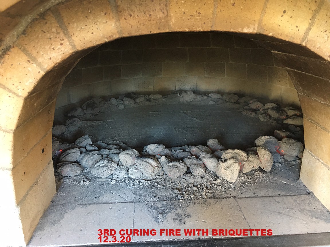

  • Thank you for your comments, Ope-dog. I remember it wasn't long ago you were mocking up clay models in your work hotel so it must feel good to finally get going on the real thing.
    I finally started my curing fires. On the 3rd one this morning, still just using charcoal briquettes. Today made it a bit larger to circle the interior. May start a small wood fire tomorrow. The one thing that is really
    amazing, the first briquette fire I built, which really didn't get all that hot.... I put a temporary door on the oven to keep the heat in as much as possible. 2 days later, it was still warm in the dome.
    Pretty cool.

      • What temps did you achieve? Did you temporarily place a thin fim of plastic over the insulation to check for steam condensation? Did you try placing the temporary door partially closed while you were heating with the charcoal on the second and third day? Did you cook something? Regardless, I'm sure that the charcoal has atleast tempered your dome to better help with the small, I repeat SMALL fires to follow.
        • Hi Joe.... I don't know for sure the temp achieved. I could easily hold my hand in the oven without any discomfort. The first day I put an oven thermometer in there but it did not get above 100°. I did put my hand
          on the interior bricks and they were hot to the touch but not skin burning. I have not yet done the perlcrete layer.... The blanket insulation and wire mesh were installed. I did have a plastic tarp over the dome's exterior and I did notice droplets of water on the side covering the dome. Did not cook anything, I don't think it was hot enough, but still didn't try to cook. Tomorrow or Saturday after the oven cools down I'm planning on doing a small fire with wood. I would keep it small maybe letting it burn for 20 minutes or so with a couple of sticks. I have read a number of posts on curing, so I'm not rushing things. After I complete these curing fires, if the weather temps permit, I'll then do the perlcrete layer and final render and do the curing fires all over again. But that may have to wait tills spring. These curing fires are to expel the water from the brick and any mortar on outside of the brick. I did order an IR thermometer which should arrive Saturday. Moving slowly.... and thank you for your comments. Appreciate it.

          • If you can close the temporary door while active burning, partially, that will bring the temps up. Want to bring them up even higher, switch to lump charcoal after a few hours. Light them outside and then elevate them on some type of old oven grate so they can get air from underneath for combustion. You can elevate the grate with anything non combustible that is handy (brick). That even works for regular charcoal. They just don't burn quite as hot hot as lump. You should be seeing temps of over 300 degrees by now with regular charcoal. A blast door works great but, any door that is only partially open will work..

              • You are doing great! Don't let it get too high until you know what temps you are actually getting. Cowboy is a brand of "lump charcoal". I like Royal Oak. But, any of it will do as long as it is hardwood lump charcoal. Lump charcoal is wood that has been burned down to almost pure carbon in the absence of oxygen. I buy it, make some, and it use it on a regular basis in my grills and in the oven.
                • When doing the curing fires is it necessary to let the interior dome bricks cool off completely prior to starting the next round of curing. For example, yesterday I got up to 500° F. This morning the interior dome bricks are at 180°. I was going to start the next fire to get up to 600°. Should I wait till the interior dome bricks cool down more, or is it okay to go and start the next fire now. Thanks very much.

                  • no need to cool
                    • Up to the 700° curing fire today. Getting ready to cook "something" any day now. As far as "finishing" the oven, just have the outer perlcrete layer and final render to go but will wait till spring to do that.
