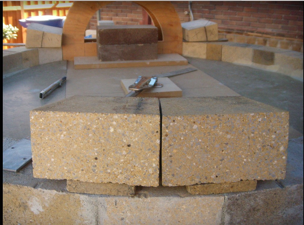

    When putting one row on top of another I've seen others use a brick cut off as a shim (see attached photo which if I remember correctly is from UtahBH build photos). My question is when you go to cement that brick in place do you leave the shim there and kind of cement around it? I'm planning on starting to cement rows today. Thanks.

      I did not leave shim in, it was for fitting and picture purposes only. Notice that I did full bevel and taper cuts for tight fitting vertical joints. It takes a lot of time and resources plus I was working with super duty 65% Alumina bricks. If I were to do another oven I would not go to this effort, only do a bevel near the interior of the dome to eliminate the inverted "V" joint and let mortar fill in the backside and use my time and resources elsewhere.

        Thanks Russel for the timely follow up. I am planning on doing the taper but actually still thinking about the bevel, but was unsure about leaving in the shim....so thanks.

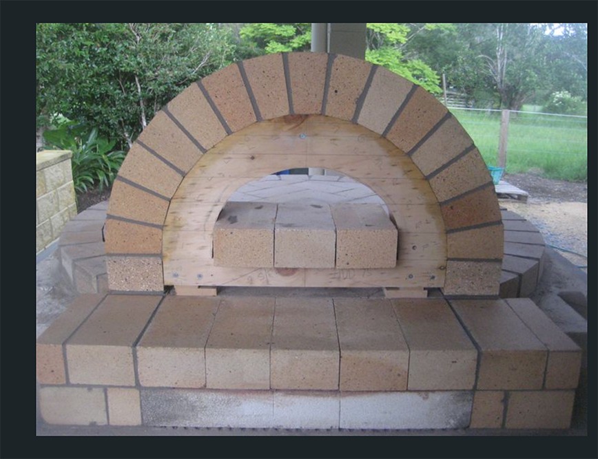

                Does the base arch brick get mortared to the landing floor (see attached)?

                  I motared the arch to the insulating base and have the landing separate. The rest of your floor is seperate, is there a reason that your arch isn't...or is that how everyone has done it and I didn't notice?

                    Arch sits on floor level. My oven floor is same level as landing base. It's all one surface, they are not separate (although I'm still considering adding a thermal break between oven floor and landing).
                    From looking at other's builds I cannot tell if the arch bricks that start at bottom of arch are mortared to the bricks they sit on (oven floor /landing surface). Any suggestions/help would be appreciated. Thanks!!

                      Think I found answer to my question about mortaring the base bricks of arch to floor. Looking at Karangi Dude's build. I see he mortared his arch's base bricks in place. Really nice mortaring he did on all his brickwork. Photo of his build attached showing what I was looking for.
                      Further edit: During a bit of insomnia I went and read through all 20 pages of Karangi Dude's build. I just discovered this gentleman and his WFO build documentation. Really incredible, inspiring and educational. To anyone, like myself, just starting their build.......I'd recommend reading it for many valuable nuggets of information. He is also, obviously, a really nice guy.

                        Looking at other builds it looks like if you are building on the cooking floor then the arch is on there too.
                        If the dome is seperate to the floor then the arch is too. Looking at your diagram #49 and picture #82 you are building your arch directly on the diagnal bricks of the floor, is so you are crossing both types of build.
                        If you look at the arch bricks in Karangi Dude's they look like they are on the straight line of bricks seperate to the cooking floor, not the diagonal cooking floor.

                            In my own build, the first or bottom course of my dome bricks, as well as the first course of my arch bricks, are mortared to the 4" thickness of insulation under the oven. My actual floor bricks, those inside the oven as well as those in the landing, are not mortared to the insulation. They float freely and can be removed if needed.
                            I noticed in your build picture that your oven floor bricks sit inside of and are independent of your dome perimeter bricks, but your arch is built on top of the landing floor bricks. If you're going to continue with that, then yes, I'd mortar the arch bricks to the landing floor bricks. I would recommend you consider running the arch bricks down to the underfloor insulation, and having the landing floor bricks cut to fit inside the arch bricks, just like you did with your dome.

                              Neil B and Mongo, thank you for your comments. This topic is certainly stirring up some thought about this. Mongo I think I see what you mean the way you describe it. I think maybe what is visually making things confusing is my arch is sitting on a herringbone pattern (those bricks that make up the oven floor). So, Mongo, what you're suggesting, the way I interpret it is, either add an additional arch brick(s)(right and left) in line with current arch bricks, extend down to CaSi board and cut the herringbone pattern bricks (the floor) around that. Otherwise, mortar the 2 current bottom arch bricks(right and left) to the current herringbone pattern (which is what my intent and original question was to do, or at least after I looked at some other's builds. I kind of like your idea of adding an additional brick(s), extending down to sit on the CaSi layer and cutting the herringbone bricks around the arch to kind lock it all (the arch) in place. I'll give all this some additional thought.

                                If you look at your post #71 you can see my bottom arch bricks are separate to the cooking floor and cemented to my insulation and outer ring (other oven builders have their bricks longer than mine).
                                You could make an easy adjustment by cutting your diagonal bricks under your arch and replacing with a straight.
                                Everyone has their own opinions on why the floor should be seperate to the dome (or not), it might not make a difference as your floor might not expand, so might not affect the arch...sorry for all the mights but I'm not sure if there is any proof of expansion of the cooking floor.
