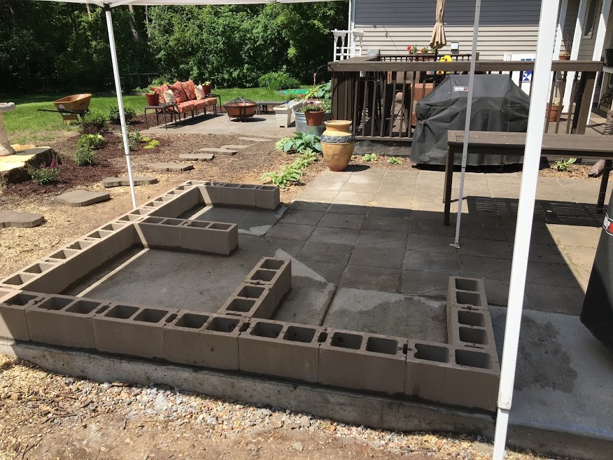

    Alright, so I haven't posted since September but winter came early to Minnesota last fall which threw a wrench into my plans to progress on my project. But, I have got things moving again.
    During the first week of May, I had the slab for the hearth and counters poured. Decided to hire this part out to make sure it was done right and finished well.
    Since that time I was able to get the first course of blocks down and mortared into place. Yesterday, I was able to dry stack the remaining levels. I was happy to maintain the level/plumb through all courses.
    Next on the docket will be the pouring the cores and applying the SBC to ensure the stability and then on the the hearth.
    I will attached some progress photos for context.
    Happy building!
