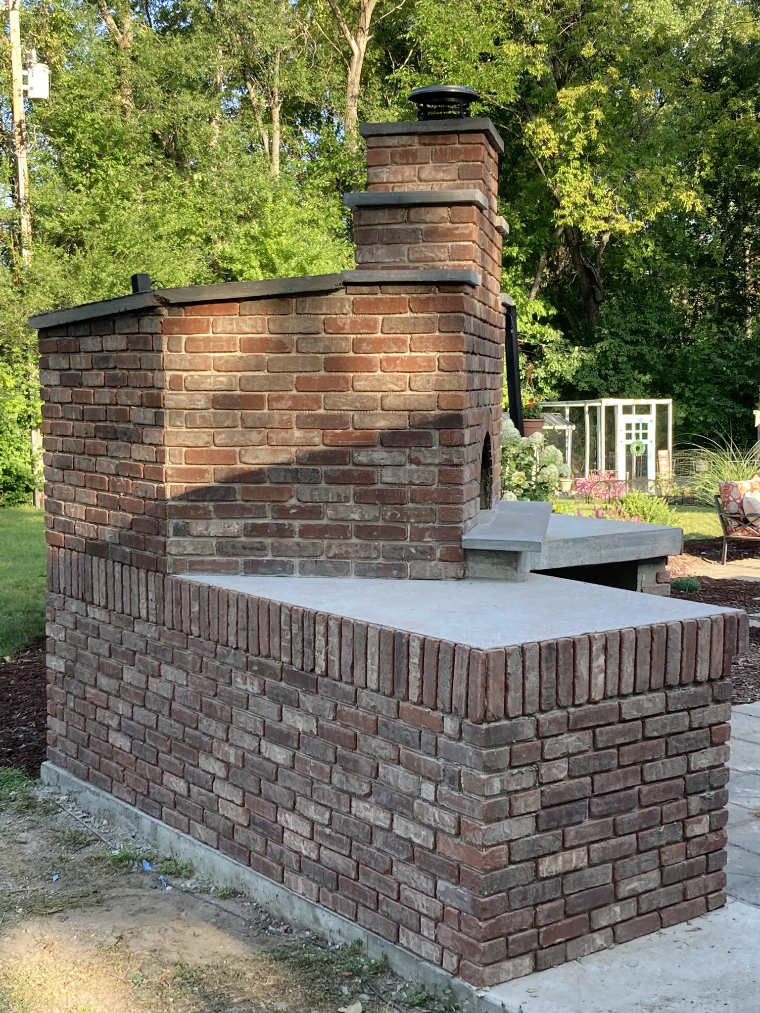

    Impressive brick work. Great volume of wood storage. I was shooting for that amount of counter space but my eventual site would not accommodate it...envious. Enjoy!

    Congrats, those last little items seem to take forever to do.

    At long last, I can finally say it’s done. Finished up the brick and mortar on the face of the base. I never thought this day would come. Need to do some maintenance of water proofing and still need to get the oven door but what a ride.
