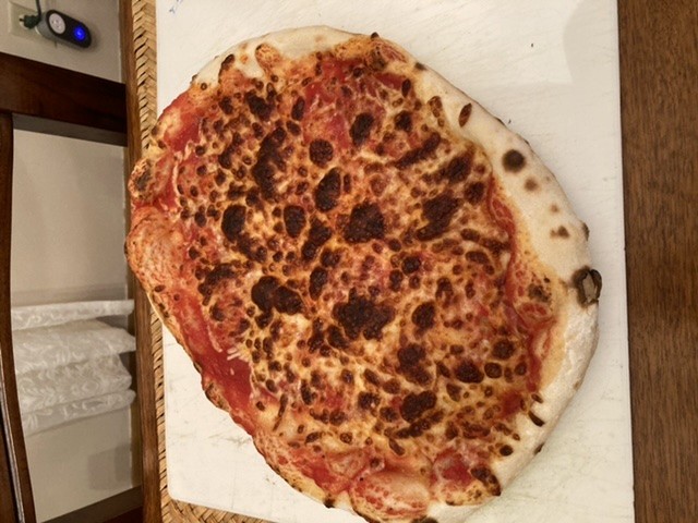

    i preheated the oven for about 2hrs. Reached a relatively consistent of 900+ on the ceiling and 680-720 on the floor.i started with a plain cheese pizza and then made a couple pepperoni. Our granddaughters were over so that’s as exotic as it can get
    I had good activity with the crust and some nice leopard spots on top and bottom. It was a great first run.

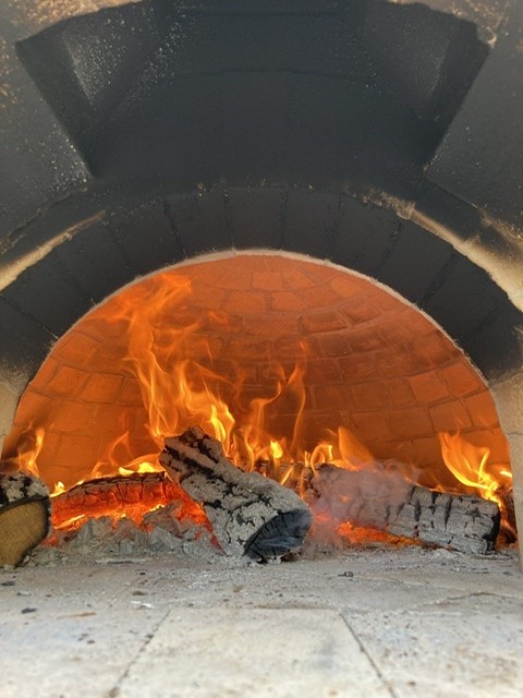

    I’ve finished up the back, sides and top over the dome and applied waterproofing to seam and screws. Also continued with the curing fires after a couple days off due to schedule and weather.
    The fires are mesmerizing. Click image for larger version

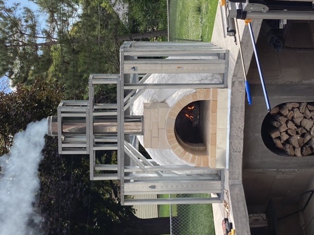

    Sixto - The enclosure five sided with the flat front, two side extending back from the front to the end of counter and then two sides coming to the point at the back of the corner. The back does slope back to the corner. The slope will remain to be topped by a poured concrete cap with overhang. My plan is to get the cement board and waterproof on this week. In the meantime, I am able to cover the entire enclosure with a larger tarp after cooling to protect from any overnight rains. Hoping the forecast remains dry for a few days.

    Gulf - I have a couple of charcoal chimney starters which I have been using to start the curing fires. They are working great in this role. Yesterday I started with 6 briquettes in the foil pan and added kindling as necessary to spark to flames. I'll ramp up the number of briquettes each day until to raise the heat until I'm able to build bigger fires. I'm trying to heed Utah's advise and keep the fires manageable.

    Chris, I love the stepping of the front facade up to the chimney. Nice proportions! Is the surround a hexagon or octagon in plan? Also it looks as if the roofline has a gentle slope to the back, will you do a flattish roof or a gable shedding to each side? Are you also planning to build-on some sort of rain protection for you when working the oven in the rain? I may have to invest in one of those patio umbrellas for sun and rain protection since my dome is exposed.

    The build is looking mighty fine. This device would come in handy for most of the lower temp drying fires. Fully stoked with lump charcoal, they burn very hot, but with no direct flame impingement on the dome. Wood fires tend to get out of hand before you know it. A charcoal chimney starter (Not Galvanized) also comes in very handy for many uses after the oven is fully dry.

    Finished the structure for the enclosure today and Day 2 of curing. A good darkening of the dome has formed which I will patiently burn off in the coming days.
