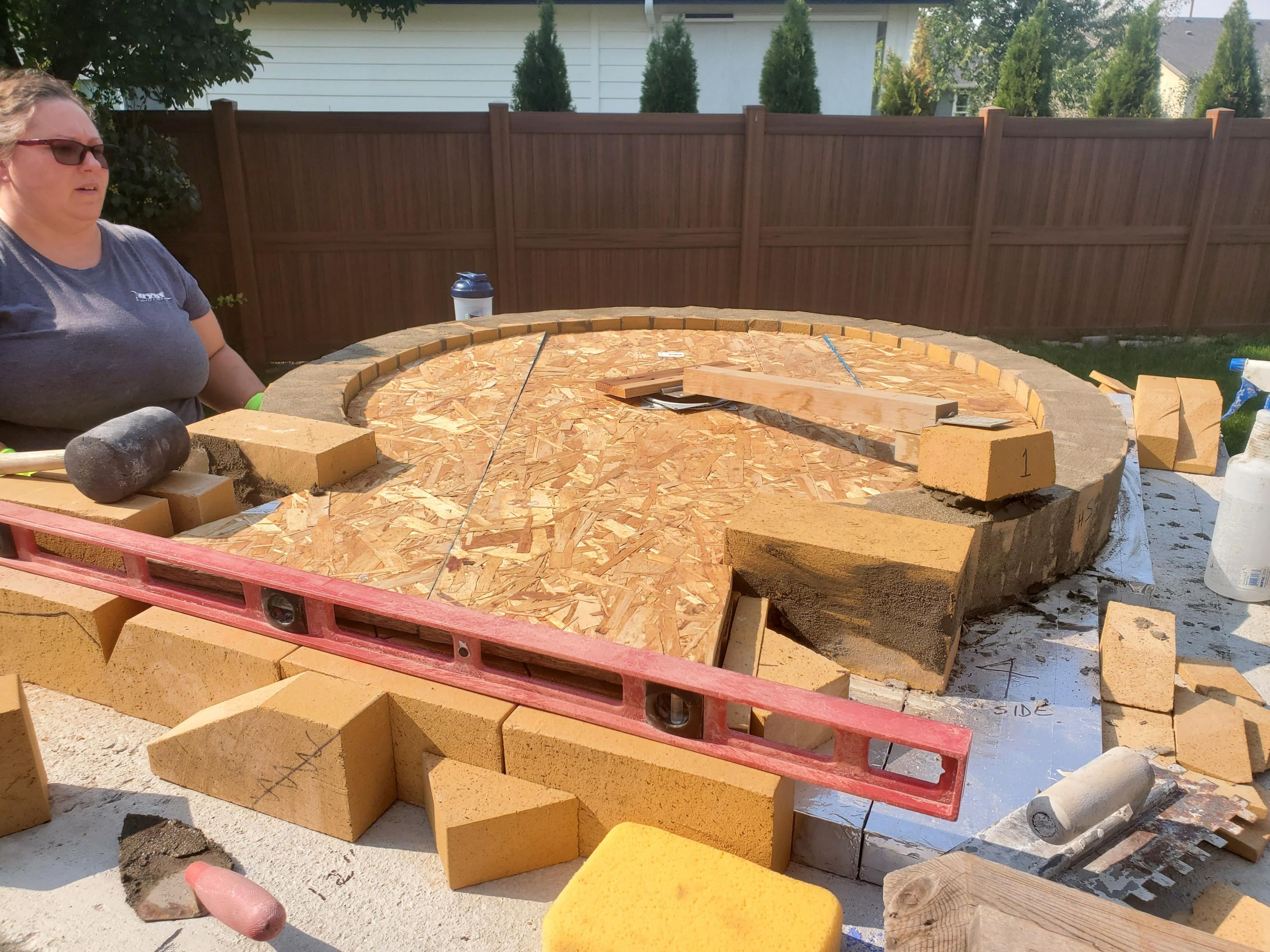

      • #18

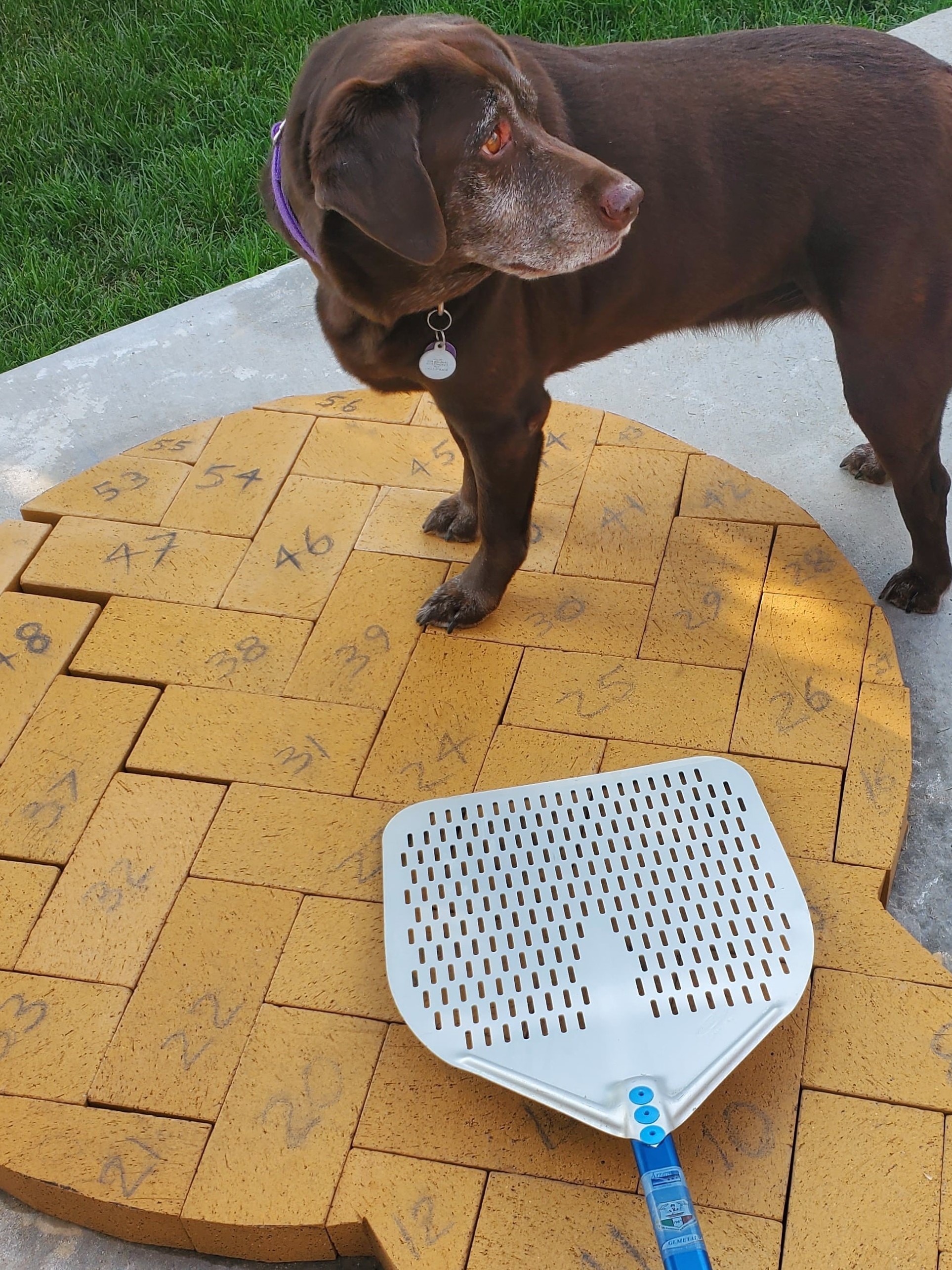

        Floor cut
        • #19
          Chamfered top edges of floor bricks to keep peel from catching an edge.
          • #20
            Passing the pizza peel test with the inspector present.
            • #21
              Half soldiers in.
              • #22

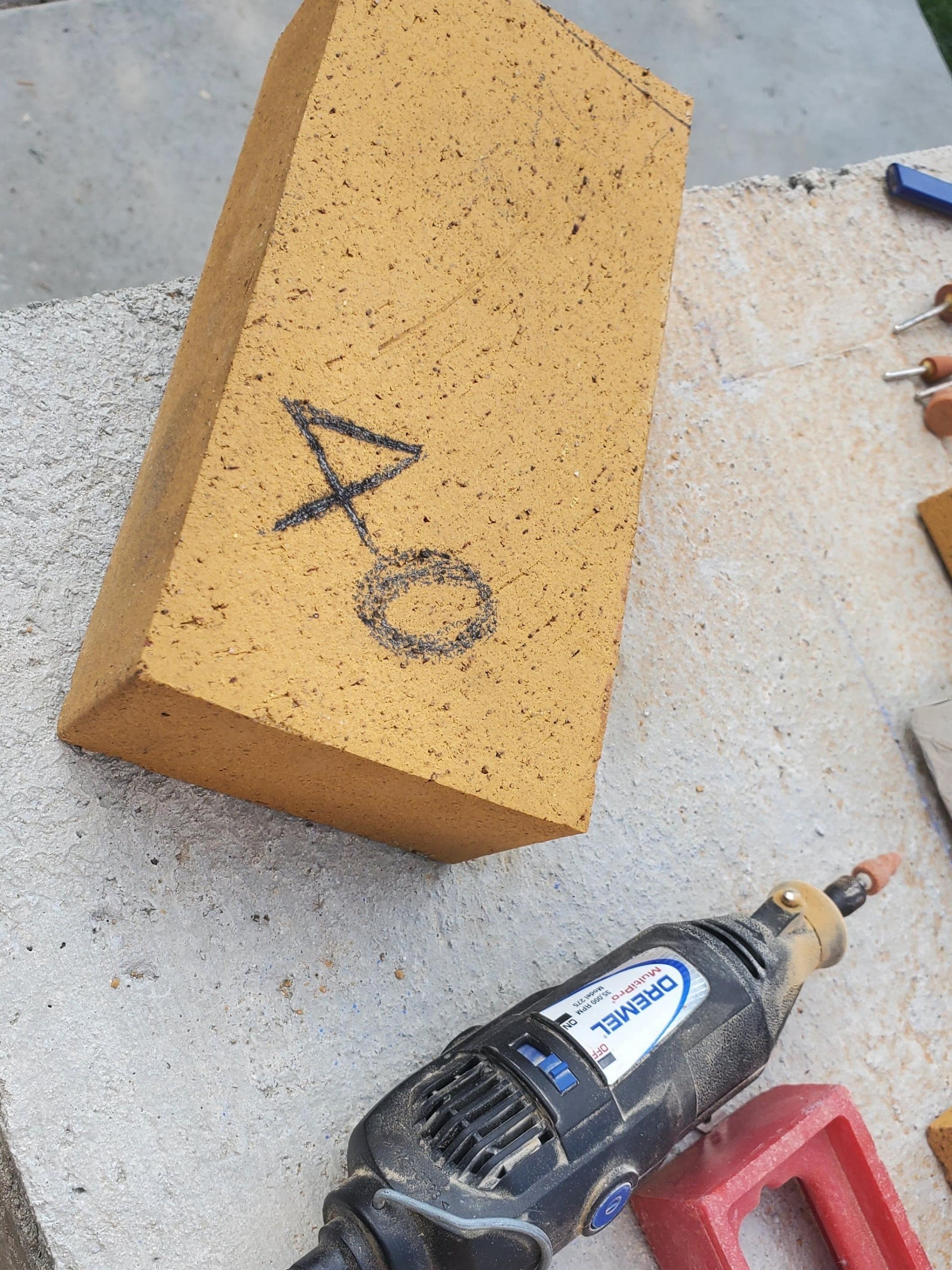

                Checking cut angles for 1st and 2nd courses.
                • #23

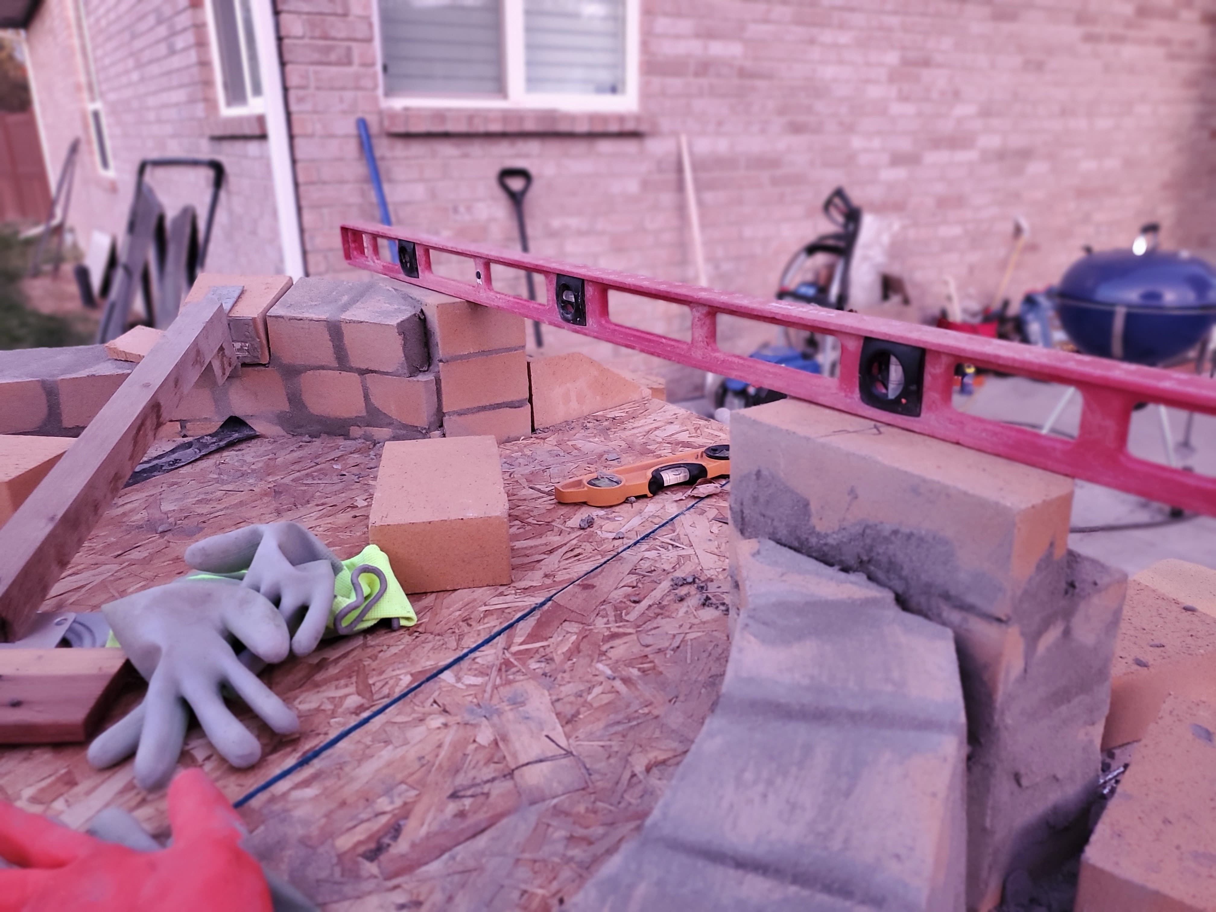

                  First course is in.

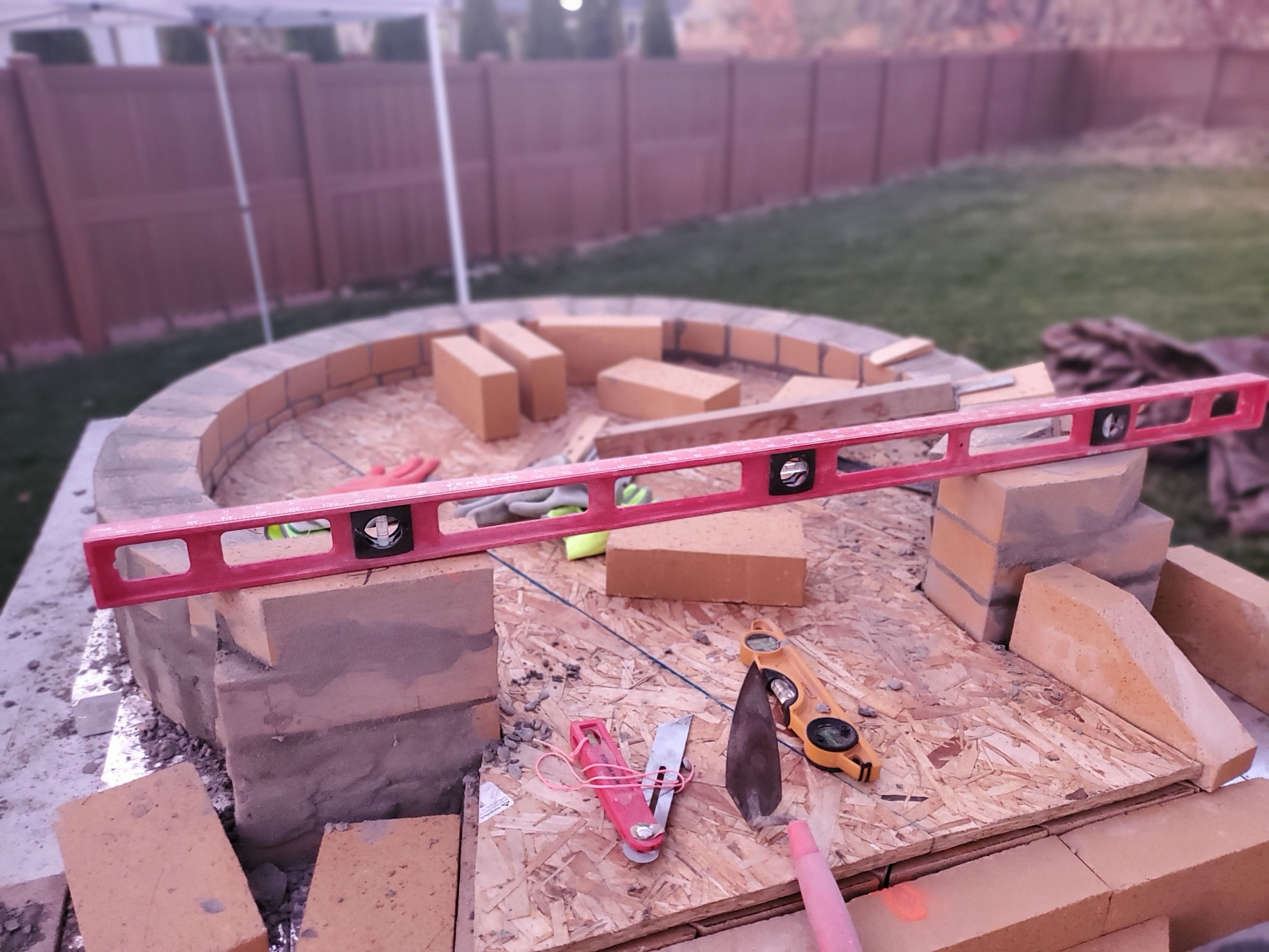

                  • #24

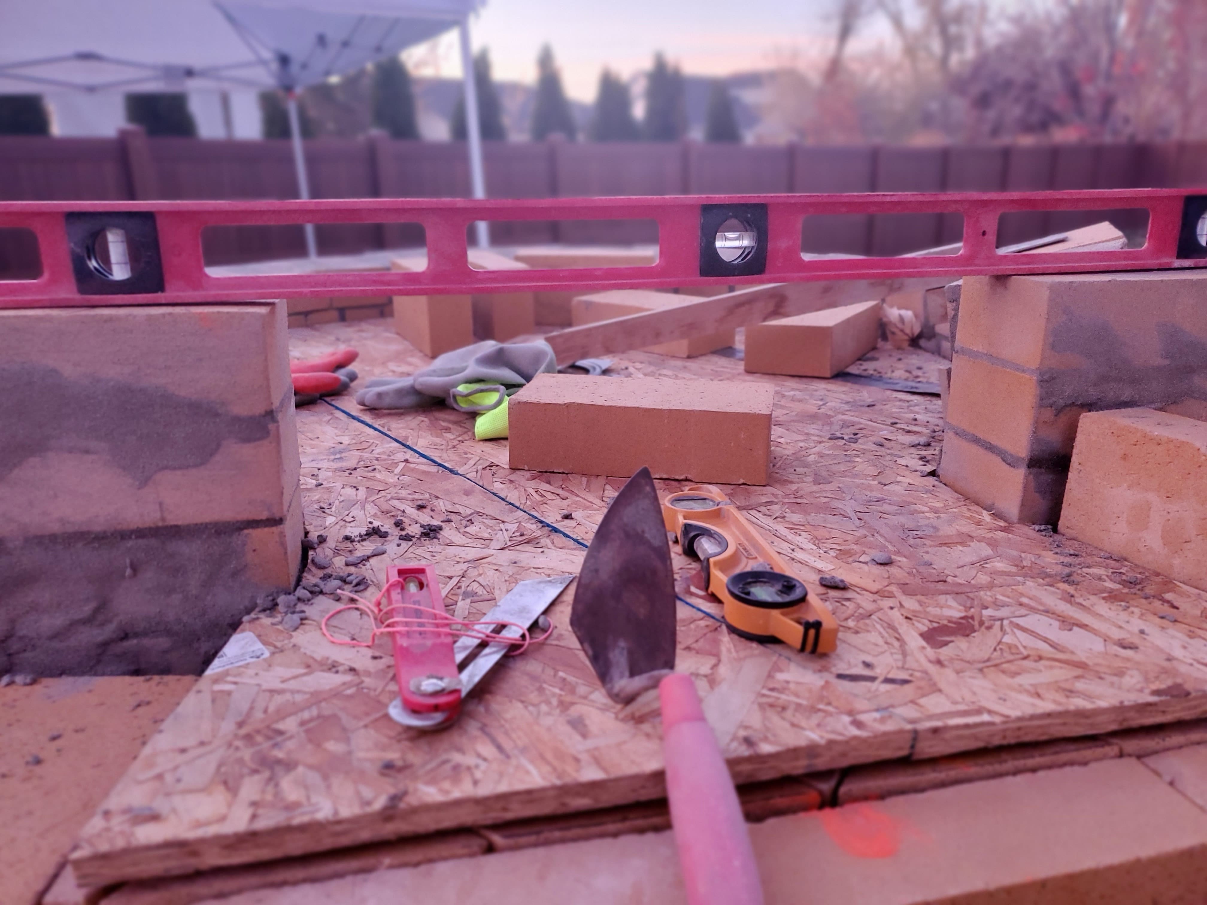

                    This is actually the first course in. Checking for level on the inner arch.
                    • #25
                      Another view of first course in.
                      • #26

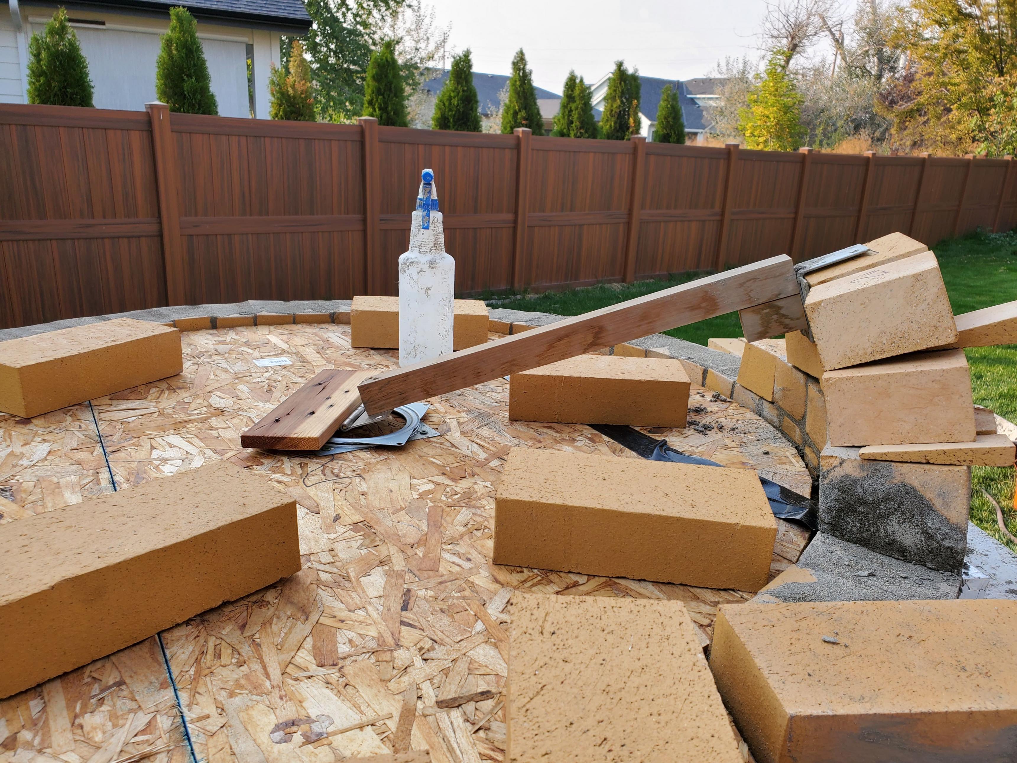

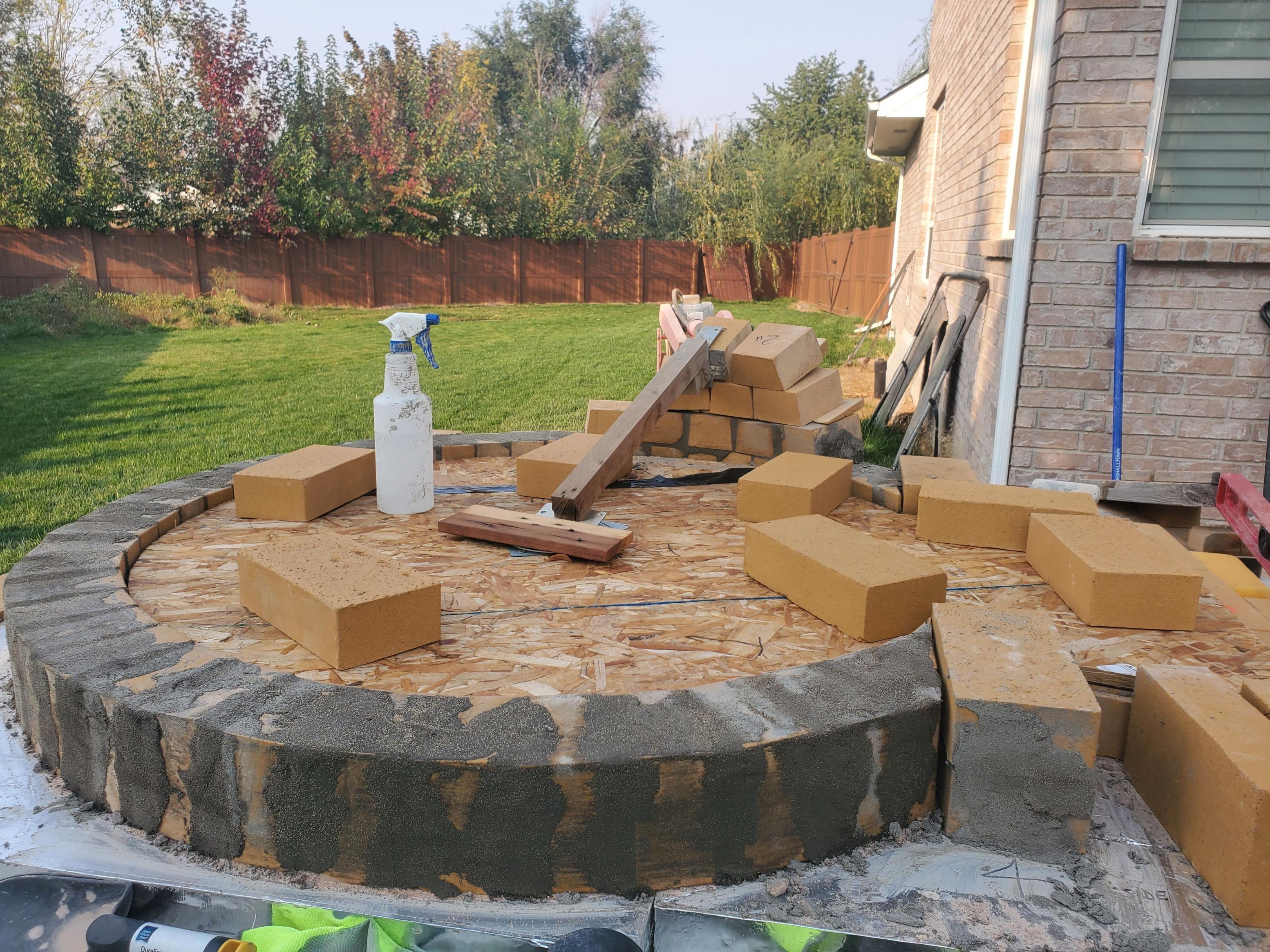

                        Starting second course.
