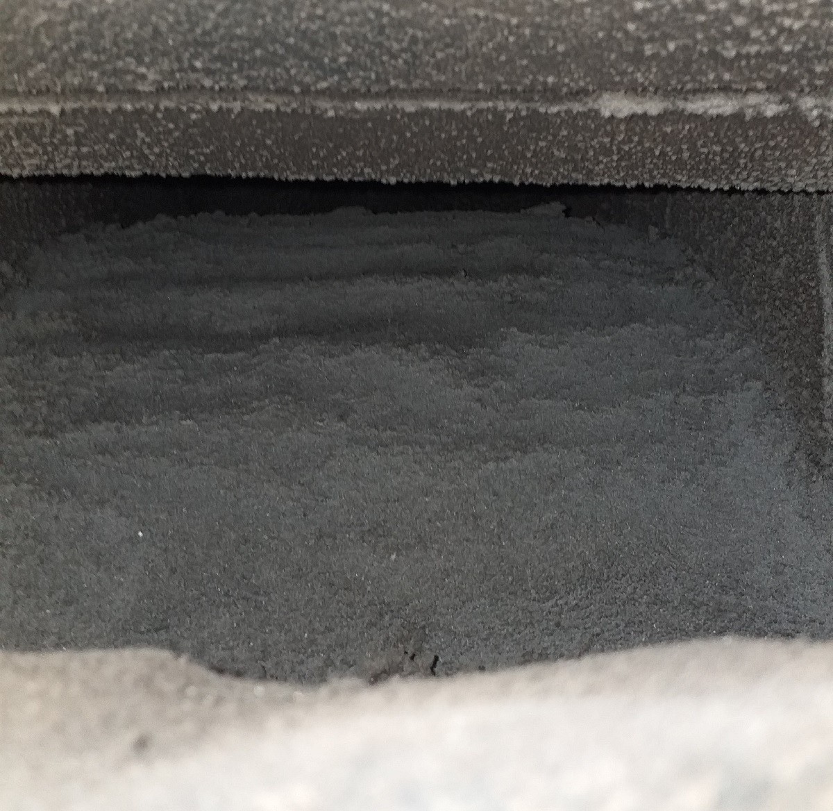

                      No worries. Here's a a photo looking up the chimney as it curves up to the top of the dome. I'm surprised how little soot there is in there. I suspect that the heat of the dome simply burns the soot off.Click image for larger version
