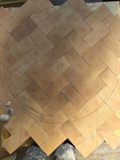

This may be a daft question, but I can't find an obvious answer: is it better to build the dome on top of the floor fire bricks (my current plan) or just outside the floor? Or does it not matter?
New build started in Scotland
The dome, if built on the floor, will work fine, but it will be very difficult to replace the floor should the floor need replacement in future. What I did was to build my first few dome courses and then I set the floor inside. After that, I protected the floor with a cardboard covering and carried on with the dome. Many builders seem to do it this way and it does mean that the floor is easily replaceable in future. It is rare to have to replace a floor with normal occasional household usage, but if the oven gets lots of use then the floor can, in time, require replacement of all or some of the bricks due to wear or damage.
So, in short, for most household use, it does not really matter, but I still think the better way to go is to have the floor inside.My 42" build: https://community.fornobravo.com/for...ld-new-zealand
Thanks Mark, that all makes sense. Since posting the question I looked at a few builds on Youtube and it's pretty 50/50, even some of the large very "professional" looking ones build on the floor (perhaps a school boy error?). Anyways I'm thinking I will tweak my design a wee bit and build around the floor. I kinda feel it will be more stable to do it that way, my only reservation with this method was that if the floor expands it might push the base of the dome out and crack it, but I suspect the tolerances won't be that tight anyway. I could well be overthinking things, but the more one invests the time and energy, the more you want to get it right.Last edited by jjnevis; 04-15-2021, 01:41 AM.
Couple things, if you cut the floor to fit inside you need to leave about a card board thickness around the perimeter as an expansion gap and also requires more precise cutting of the floor bricks. Placing the dome on the bricks allows you to rough cut the floor and leave proud. Either way works so up to you and where you best want to spend your energy and time.
The order you build in also depends on if you use an IT and how you attach it to the floor. I copied the method Gulf used which I called "the wooden brick" where the IT attached to a piece of wood in the center of my floor. This method would probably be more difficult if you tried to build a few rings and then insert the floor, as I used the IT to draw the circle to cut my floor bricks. You can see the marker inserted in the IT in picture #1. As Russell said above, read up and decide what build sequence makes the most sense to you.2 PhotosMy build thread

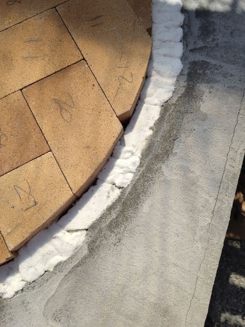

Floor insulation - I did want to add an extra 25mm of ceramic fibre board to the 50mm that I already had, but it was going to take too long to deliver and I also decided it was hard to justify the extra cost, so I just went with 50mm and am hoping that I won't regret that decision.

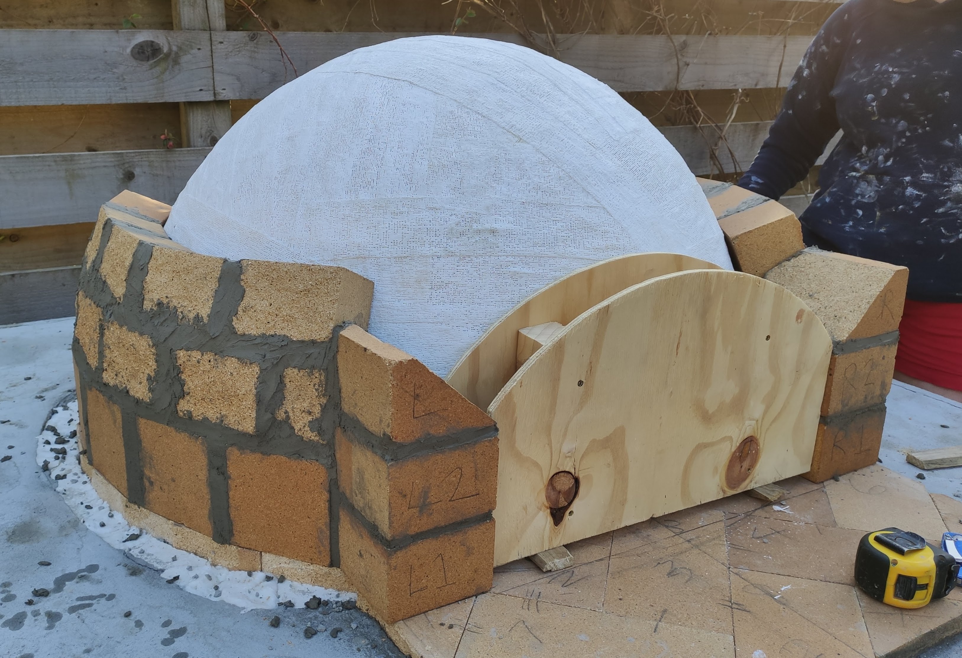

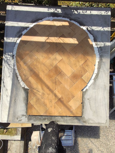

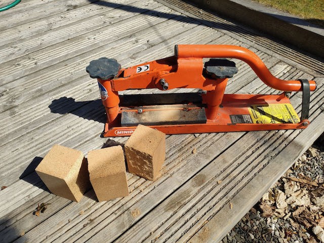

I've also decided to build the wall on the oven floor mainly because (based on the advice above) it appears to be the simplest option, particularly with regards to accuracy of brick cutting - which I am finding quite a bind and pretty hideous process, although I do have a solution for simple cuts going forward - a friend has lent me a brick cutter. I'll try and remember to put a picture of it and the results of using on this thread, but in short - it's bloody brilliant. The cuts are clean enough for me to use on the dome and it's very quick and simple to use. My plan is to use the 76mm dimension of the brick as the wall thickness (which P3 Stoaker thinks may be too thin to provide the thermal mass necessary, but I guess I'll find out [worried face emoji]). This will mean cutting lots of bricks into three and the cutter will be great for this. I was thinking of covering the dome in a 5-10mm render of fire mortar to finish it off / add some thermal mass / improve stability, but not sure if this is necessary or advised?

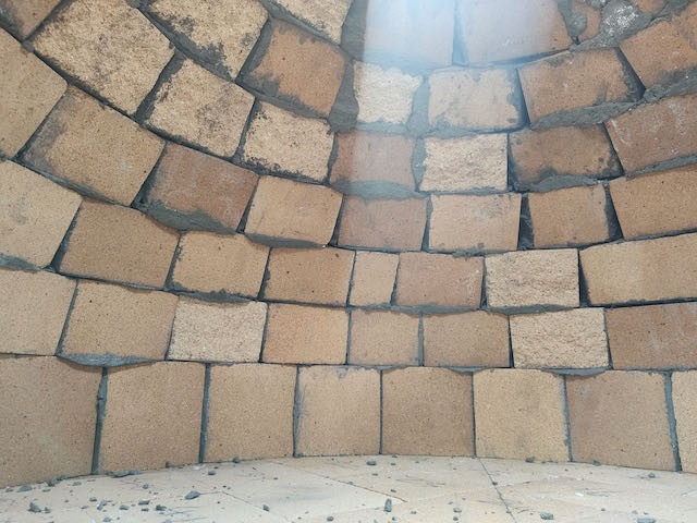

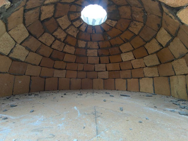

My dome form (plaster of paris cast over a gym ball) is working out great. It does mean that I can't clean up mortar squeezing out of internal joints, but that should be easy enough to clean up after. If I get my joints right, then there shouldn't be any mortar showing on the inside anyway.
Finally, just another shout out for the brick cutter, great bit of kit, well worth trying to borrow or hire one if you have lots of bricks to cut.

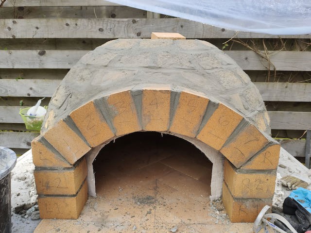

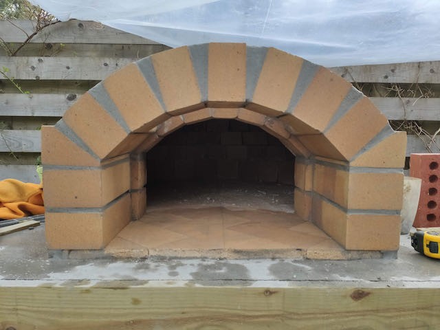

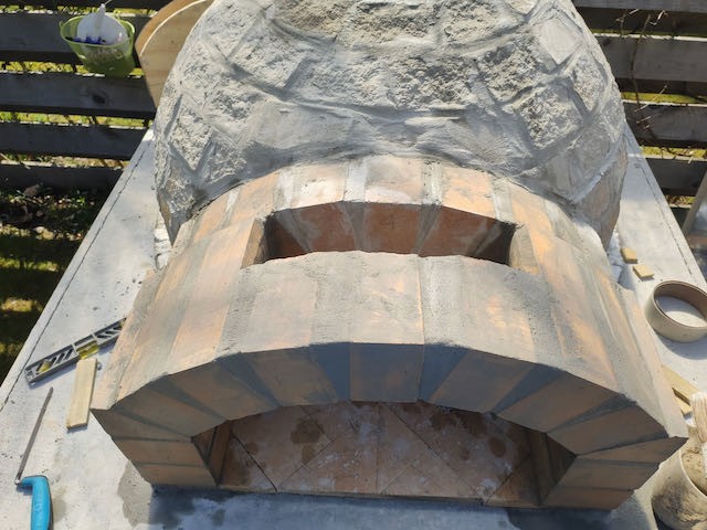

On a different note, I think I've made my first mistake and it's a consequence of not having detailed plans and kinda winging it as I go along. It's something I can easily live with (I'm not going to fix it), but I think I've made the door stop slightly too far away from the oven, approx 50mm. I had wanted the middle inside surface of the door approximately in line with the internal surface of the dome wall, but it's more inline with the outer surface. This makes the tunnel a little longer, the thermal leakage a little greater and the flue slightly further away from the fire. These are all minor issues, but if I had thought it through more carefully I would have set the door stop slightly back a bit. The actual door itself is another issue altogether, haven't come up with a design for that yet, but I want to make a fairly thick insulated one.
Edit - I've just been contemplating my door stop placement issue and have decided that it is probably in about the right place after all. I could have moved it back a little, but the arch bricks would then start to get a little too small (reducing the wall thickness). Also, having stood in front of it, I think the opening tunnel length will be just fine, so feeling better about things again. (I could have just deleted this post but decided to document my thought process instead)Last edited by jjnevis; 04-26-2021, 07:29 AM.

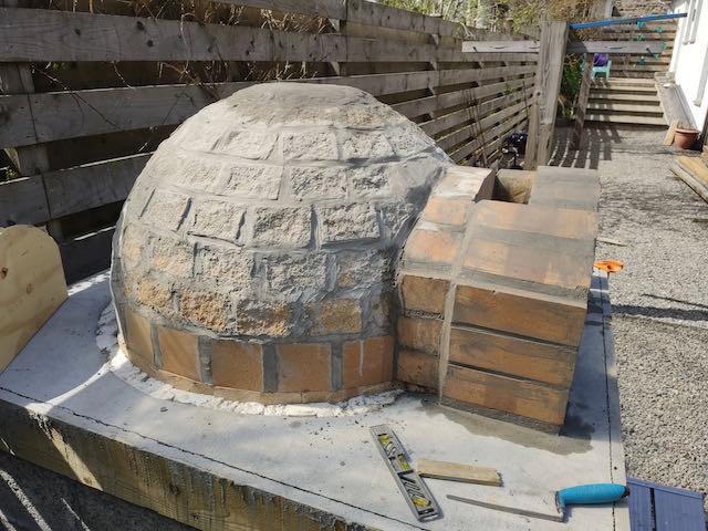

OK, time for an update after a little progress. I'll let the photos tell the story.

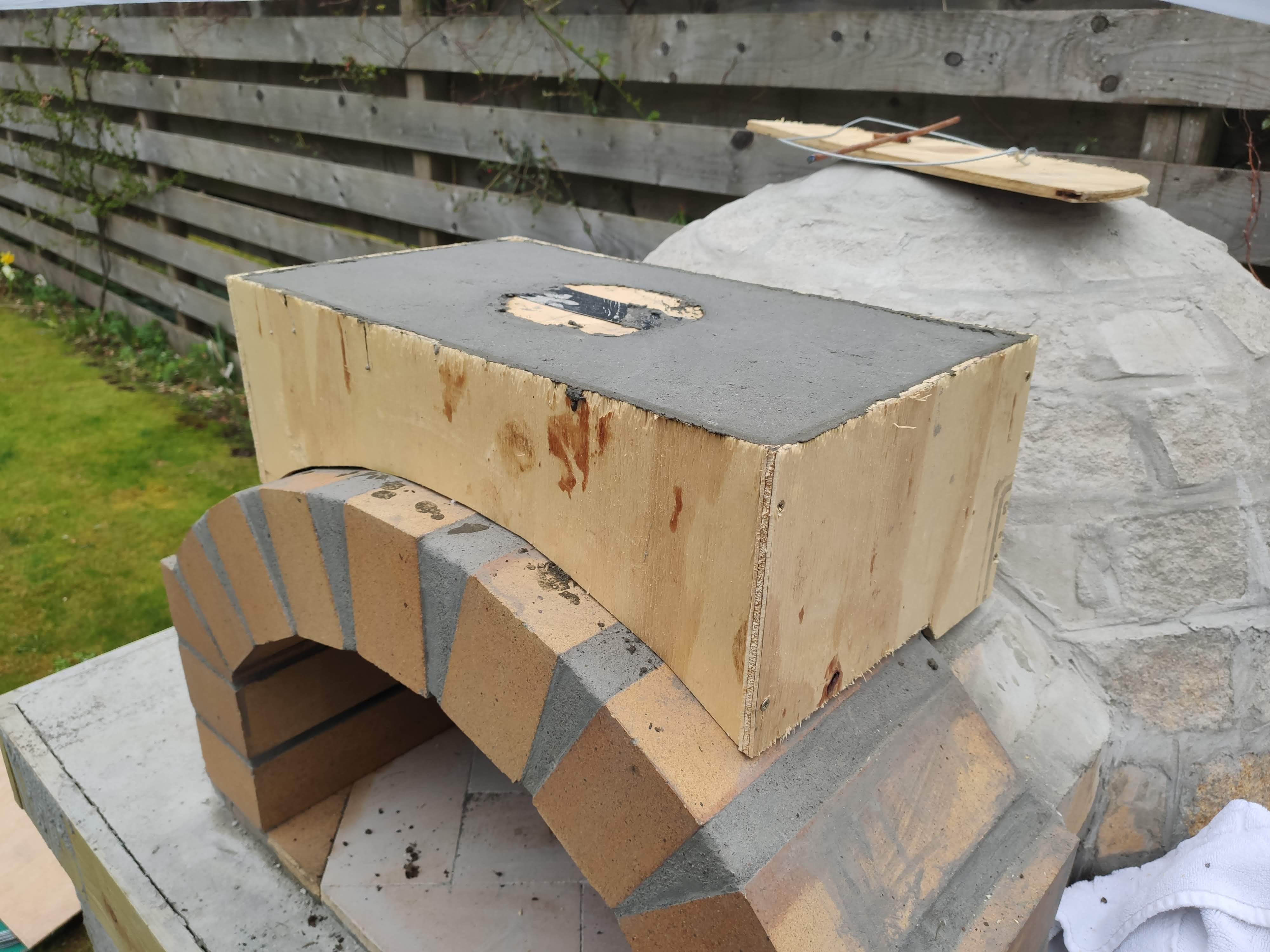

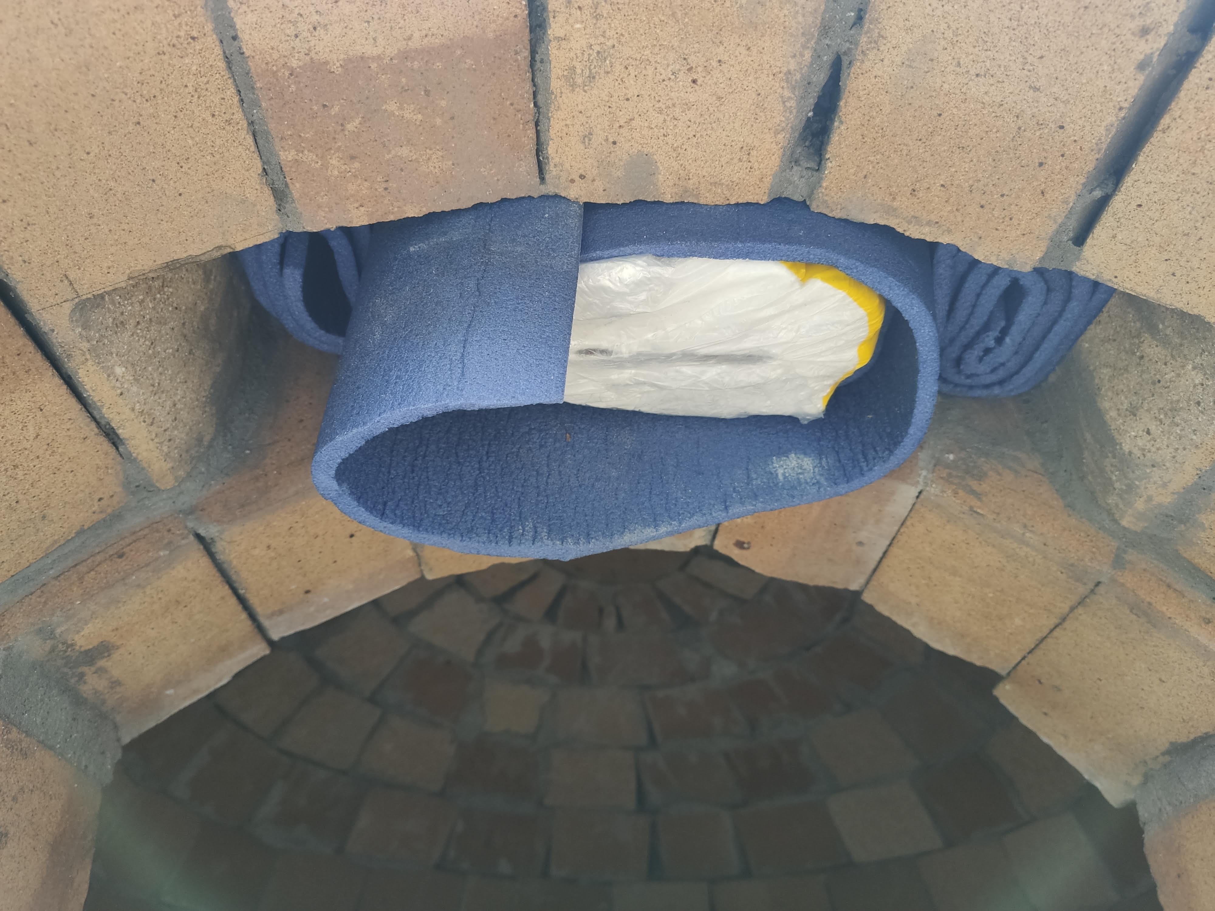

My next challenge is to transition from the curved rectangular (if that makes sense) chimney slot (I don't know any of the correct terms!) to a 6 inch (150mm) circular entrance to a 1 meter twin wall flue pipe. I was going to try and do this in brick and throwing A LOT of mortar at the problem, but am now thinking that building a form and filling it with some sort of concrete mix would probably be easier in the long run. Again - advice and experience on this would be much appreciated.

I've got a week at least to wait before I can start the curing process on the dome, pretty sure I can start that before the chimney is in place, although I am a bit nervous because of the thickness of my mortar joints, but I'll soon find out how things go [worried face emoji]
Decided to go with a concrete cast for transition to chimney. The form work was a real head scratcher, but in the end decided to just chuck gaffer tape and anything I could find at the problem, including a full roll of kitchen roll and an old sleeping mat chopped up. I think it should work ok and was much easier than trying to do it in brick. I also reinforced it so if it does crack, it shouldn't fall apart. The twin wall flue will just be mortared onto that.
