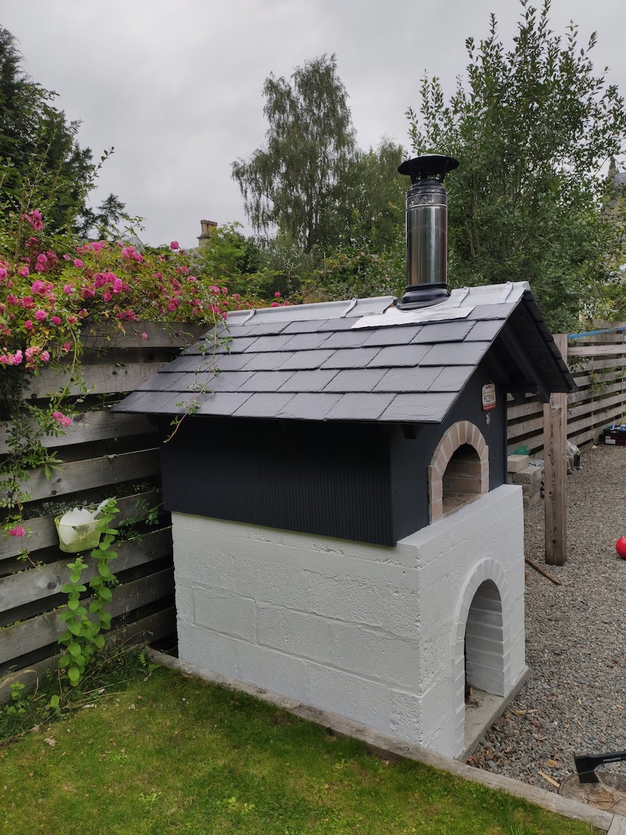

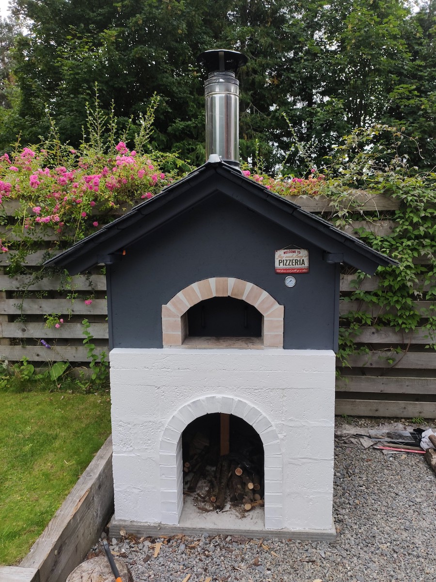

Originally posted by jjnevis View PostSlated roof on and painted.My 42" build: https://community.fornobravo.com/for...ld-new-zealand
Thanks guys for all your positive comments! The oven is working great and has provided many fantastic pizzas and other yummy stuff. It's winter over here and the oven hasn't been used for a couple of months. I'm thinking of a pizza night on Christmas Eve and then cooking the turkey in it the next day, partly because the weather forecast is lovely (below freezing, but still), partly for space in oven in house and partly for the fun! I'm just wondering if I should warn oven slowly over a day or so, just in case moisture had found it's way in over the last couple of months?Last edited by jjnevis; 12-22-2021, 12:05 PM.
Originally posted by jjnevis View PostThanks guys for all your positive comments! The oven is working great and has provided many fantastic pizzas and other yummy stuff. It's winter over here and the oven hasn't been used for a couple of months. I'm thinking of a pizza night on Christmas Eve and then cooking the turkey in it the next day, partly because the weather forecast is lovely (below freezing, but still), partly for space in oven in house and partly for the fun! I'm just wondering if I should warn oven slowly over a day or so, just in case moisture had found it's way in over the last couple of months?My 42" build: https://community.fornobravo.com/for...ld-new-zealand
