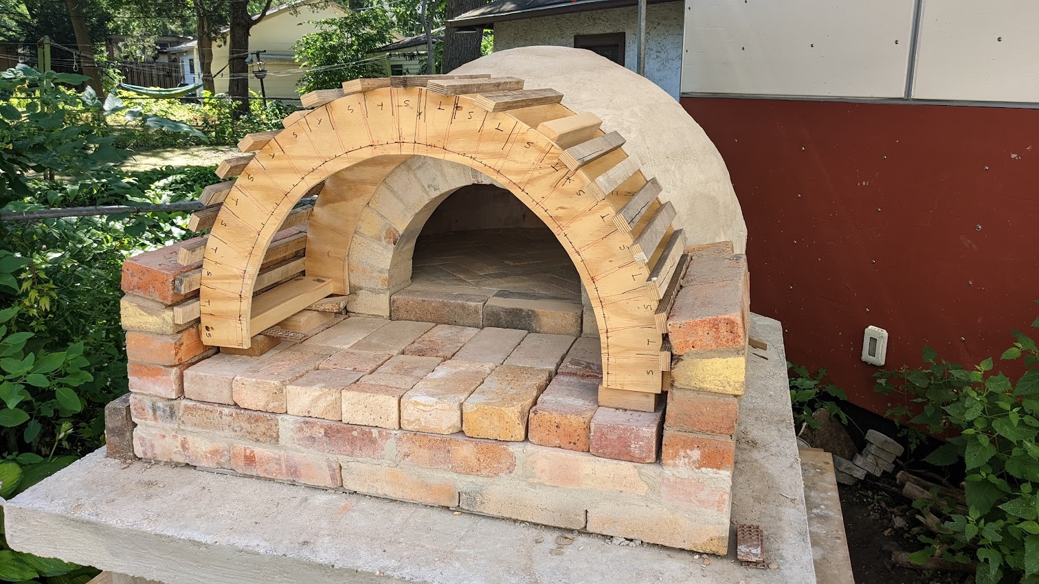

              The dome is closed-off, not pretty, but I think it will hold. I also realized I did not properly describe the gallery arch, so now that it is started, I will show the details, talk about why I went with an arch rather than straight sides, and talk about the possible shortcomings of this design...
              The photo below is an overall view of the gallery arch form and the first few brick courses on either side. I have the form up on wood blocks and shims so I should get about 2" of clearance at removal time.
              Click image for larger version  Name:	Gallery Arch Started.jpg Views:	0 Size:	441.0 KB ID:	448581
              The reason why I went with an arch for the gallery rather than a straight-walled-box is simple, I'm the only one in my family that favored the straight wall design, everyone else liked the arch better. Because of this, I lost about 2" of head-height... right now the bottom of the arch keystone will be about 21.75" above the gallery floor bricks.. Building the arch is going slowly because of the detail below, every single brick oriented radially next to the outside face of the dome arch has to be cut to form around the gasket and insulation, plus they need to be tapered about 1/4" top and bottom at the inner edge to match the alignment of the main gallery courses... The main gallery arch has alternating tapered and standard brick courses, and the straight courses make the 90d turn to meet the outside of the dome arch. (the letters on the face of the form are not an accurate guide to courses)
              As I may have mentioned before, the goal is to be able to use the gallery as a grill area when I'm not making pizzas or bread. The gallery dimensions are: 36" wide, x 18" deep x almost 22" tall at the center...My wife tested the fit of our paella pan, and it fits inside the wooden form, so there should be plenty of room for anything I want to grill. And this does NOT eliminate the option of having a Tuscan grill inside the dome. I can start a fire in the dome early, pull the coals out into the gallery floor and add a grate on stilts to grill.
              This all came as an afterthought, when I realized I had placed the dome entrance about 27" behind the edge of the slab, and reaching-in would be tricky for me if I did not make the gallery bigger, so I could get my head under the arch. I could have made a shallower flue gallery and just deal with the reach issue, but the idea of adding a grill area to the front made sense to me.
              Click image for larger version  Name:	90d arch and rope detail.jpg Views:	0 Size:	633.7 KB ID:	448582
              One possible downside to this design is that the full front face of the dome arch is exposed to the air, (you can see it in the overall photo on top) and may lose too much heat through that surface... I may have to make a bigger insulated door to cover the whole 4.5" of exposed brick arch... I did back up the gasket with 1/2" ceramic fiber insulation, so at least the gallery arch bricks will not be sucking heat from the dome by conduction.
              With this much separation between the dome and the flue gallery, I wonder if I need as much insulation around the flue gallery arch and transition to the stainless steel flue.. maybe just a couple of inches of perlite cement, stucco and tile?

              • #82
                I really like this solution, apart from using it as a grill area, not only does it give you far better access to the inner oven, it also provides a big volume for smoke collection. I think you may have started a trend. We could call it The Sexy Sixto Solution.
                A couple of considerations, as the gallery semi circular arch is so big it’s thickness is proportionally relatively thin. These kind of arches being unsupported at the sides are vulnerable to outward thrust(something the Romans knew very well) Strength can be increased enormously by laying a second layer of bricks with no joints lining up. This would probably be overkill, but a concrete layer enriched with fibres of around 1” over the brick arch might do the trick. I suggest you don’t place too much weight on top of the arch like a brick chimney.

                    I don't think that would be necessary, because your gallery is so far away from the heat. You should be able to hold your hand against the inside of the gallery when the fire in the inner oven is really cranking. Raking coals into the gallery would increase temperature but not that much. You could always trowel over a 1" 5:1 vermicrete after it's finished if you think it requires it, but I don't think you'll need to.

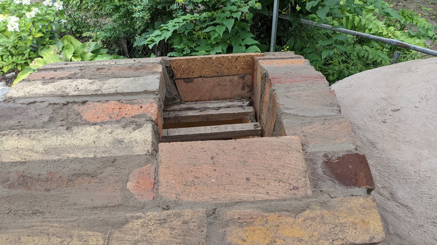

                            Gallery vault is finally closed, and it has quite an imposing presence! (from the front it fully hides the bulk of the uninsulated oven brickwork behind) The vault is so wide because I expect to use the gallery as a grill area possibly more often than I will use the oven, plus I wanted enough height in the gallery to be able to reach into the oven without bumping my head on the gallery arch face. This became a concern when I realized I had placed the face of the dome arch 27" back from the front edge of the counter-height slab, after I made the motions of placing and turning a pizza in the oven using an empty peel with a long handle.
                            The flue opening is the only interruption of the gallery vault. I was a little concerned about the vault bricks at both sides of the flue opening, so I decided to bevel them as keystones supported by the arch bricks in front and back of the flue opening.(See last photo attached)
                            The flue transition from brick to stainless steel will be a fairly simple set of 12 bricks spanning over the 12" x 8" vault opening, and gradually narrowing into a 6" dia stainless base plate. Photos to follow next week.
                            I felt confident enough at this point that I could do a schedule and stick to it. Our first Pizza Party is scheduled for October 7, but I expect I'll be able to do some taste testing before that

                            Flue opening at top of the gallery vault
                            Click image for larger version  Name:	Gallery Flue opening.jpg Views:	0 Size:	464.8 KB ID:	448765
                            Detail of keystone bricks at both sides of the flue opening
                            Click image for larger version  Name:	Gallery Flue Keyed Bricks.jpg Views:	0 Size:	497.6 KB ID:	448766
