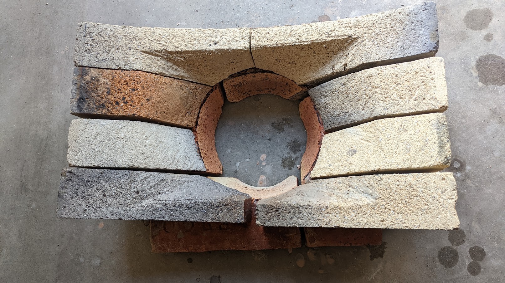

          Arch form removed, interior tuckpointed, and first layer of chimney bricks cut - there are 12 total, but these center 8 are being mortared in-pairs and dried in plastic bags to get a nice strong joint, and make it easier to install since the shorter 4 bricks in the center tended to tip-into the flue cavity.

          First layer of chimney bricks cut - gradual transition from 8" x 12" arch opening to 6" dia. stainless flue.
          Click image for larger version  Name:	Chimney bricks.jpg Views:	0 Size:	571.9 KB ID:	448962

                    Now, the 12 chimney bricks were another story... I tried to mortar the 4 pairs plus the 4 singles yesterday, and had a frustrating time trying to align it all without messing up the fresh mortar joints, so I took them all down and tomorrow I will mortart more bricks together so I end up with 4 sets of 3 bricks each, Then when those are set together, I will mortar the two sets in the the back half first, make sure that is solid and square, and then add the two front sets of 3 bricks each so I only have to mortar and level 2 sets at one time.

                          • Hey Sixto, been watching your build while planning mine. I was thinking that adding a lip on the inside of your gallery might trap the smoke in there and force it to the chimney. I'm not sure if you want to reduce the opening though, but it might help with smoke control and keep the front from getting sooty. Maybe just one arch of bricks inside the main arch?
                            -AJ
                            • Thanks AJ! I thought about having a lip, but like you said, I chose to maximize the interior height. Instead, to encourage the smoke to stay near the flue, I tilted the vault form down 1/2" at the front (only noticeable with a level) and beveled the bottom-rear corner of the bricks in front of the flue opening by 2". I'm hoping this will pull-in fresh air along the top of the gallery into the flue funnel and keep the smoke close to the back.
                              Click image for larger version  Name:	Gallery Flue opening.jpg Views:	0 Size:	464.8 KB ID:	449122
                              We'll find out soon enough, I'm impatient to start drying fires, now that the dome is covered with 4" of ceramic fiber blanket, I can't get perlite this week, so I'm falling behind my schedule. I'm also waiting for my flue bricks to set in their groups of 3 bricks before I can mortar them in, perhaps this weekend???
                              Sixto - Minneapolis
                              • Just catching up on this...your build looks terrific!
                                I did the same thing with my chimney anchor bricks, I made a rectangular wood frame and mortared the bricks up in two groups of six within the form. The next day I mortared the two sets on top of the arch with the wood frame holding them secure. It worked very well, saving a lot of "tap tap tap stay put!" frustration.
