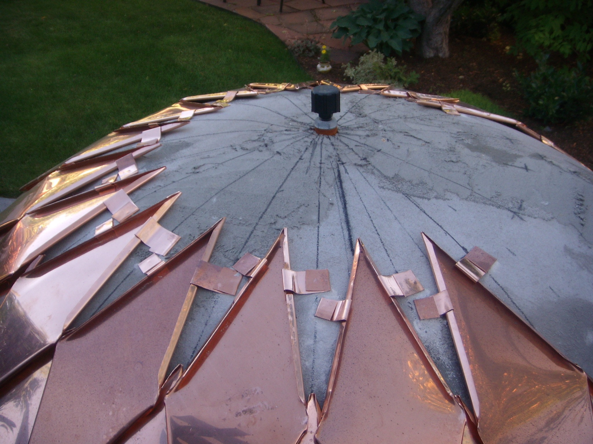

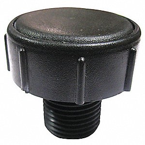

                    #24
                    You can do a forum search and you will see dozens of different types but the purpose is if the insulation get wet then when it sublimates to steam the vapor has a way to vent. Gulf and I use a auto case breather vent that you can get at any auto parts store for less than 10 bucks. it mounts into a 1/2" pvc bushing set in the stucco. Gulf reinforces his bushing with a little wire mesh around the bushing it in the stucco.

                      #25
                      Ahhh ok that makes sense. And something I had not thought of. I will look into just purchasing an auto hydraulic breather vent like you have shown above. Great point.
