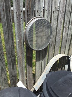

          Originally posted by Gulf
          If all the ingredients are dry they can be premixed for later use. Don screened all his ingredients as he was as adding them to be dry mixed. I have found that a child sized garden hoe is just the right size for dry mixing the ingredients.
          It really helps to have an easy to make screening box that fits right over a project tub for this project. It's fitted with 1/4" wire mesh. A scrap of galvanized window screen is placed on top for the fine screening. I have used this setup also to process brick cuttings. We did some of that too, later in this build.
          I agree and use the sifter pictured. I get bulk graded sand for use in concrete, but dry sift out the coarse grains for mortar or render. My screen removes anything larger than 3mm. A range of grain sizes is actually preferable to a uniform size.
