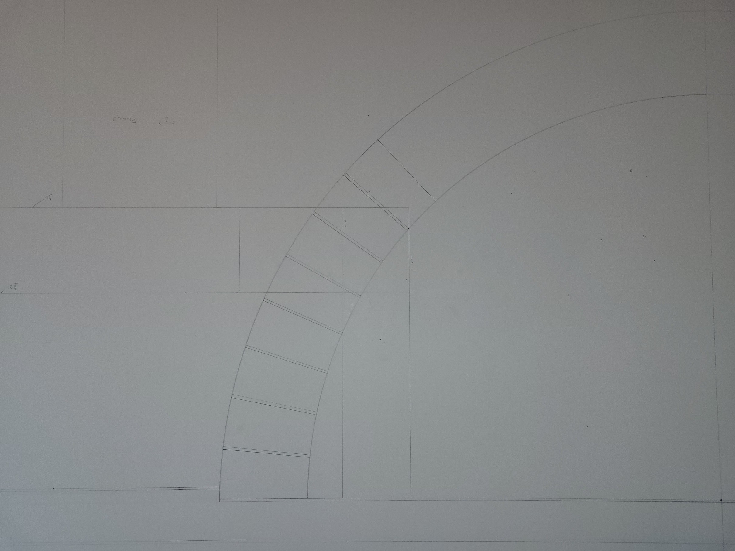

    Ready to pour the hearth! Unfortunately I'm a day behind so I may have to wait a week for Jesus, Constantino and Machete to be ready.
    I setup my fullsize template and it looks good. The front of the oven opening lines up with the front of the yardstick in the image below.
