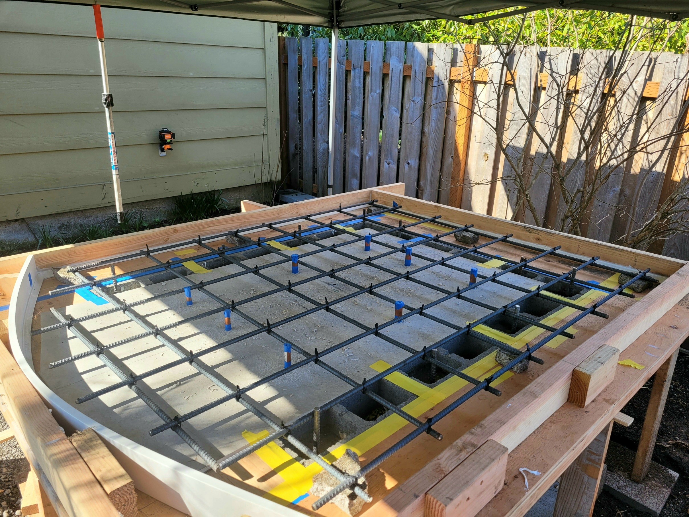

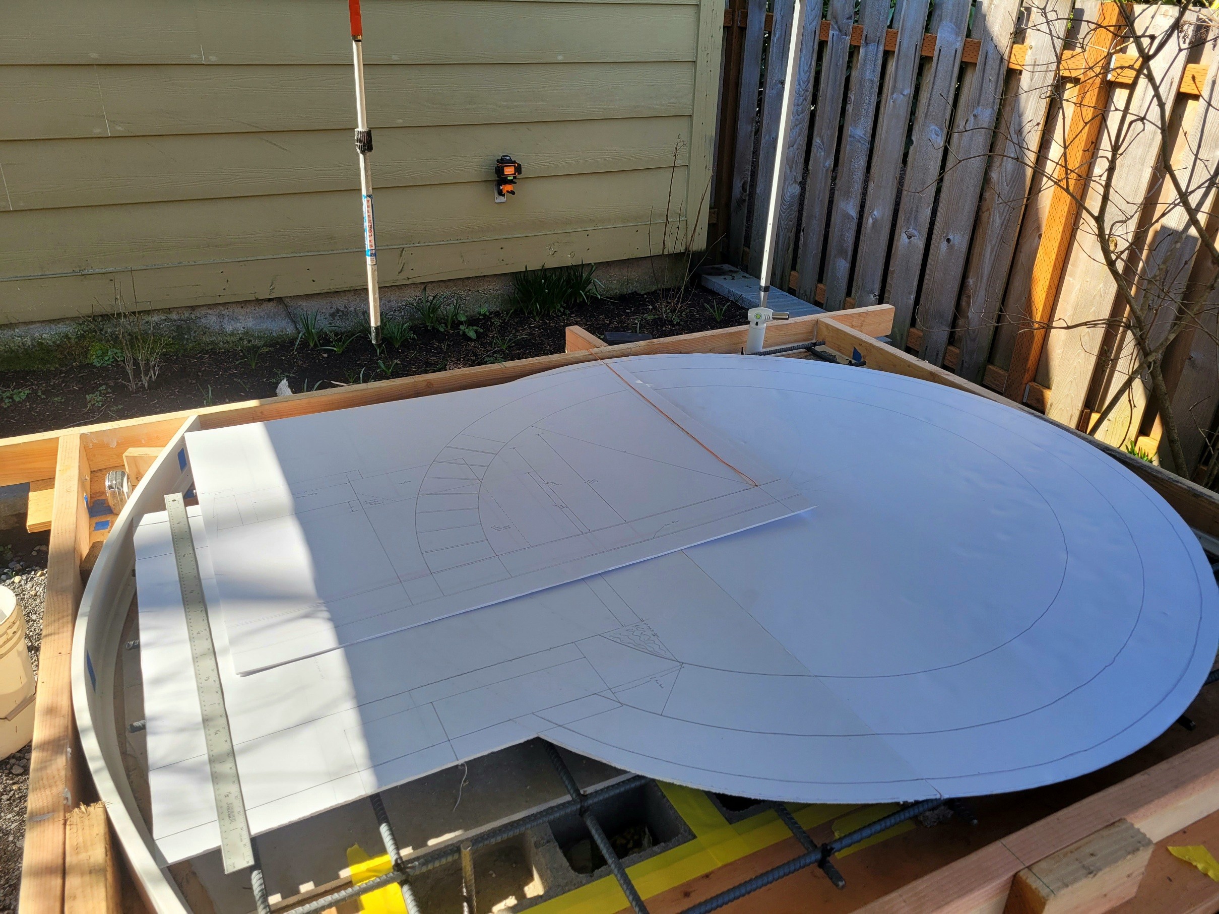

    Ready to pour the hearth! Unfortunately I'm a day behind so I may have to wait a week for Jesus, Constantino and Machete to be ready.
    I setup my fullsize template and it looks good. The front of the oven opening lines up with the front of the yardstick in the image below.

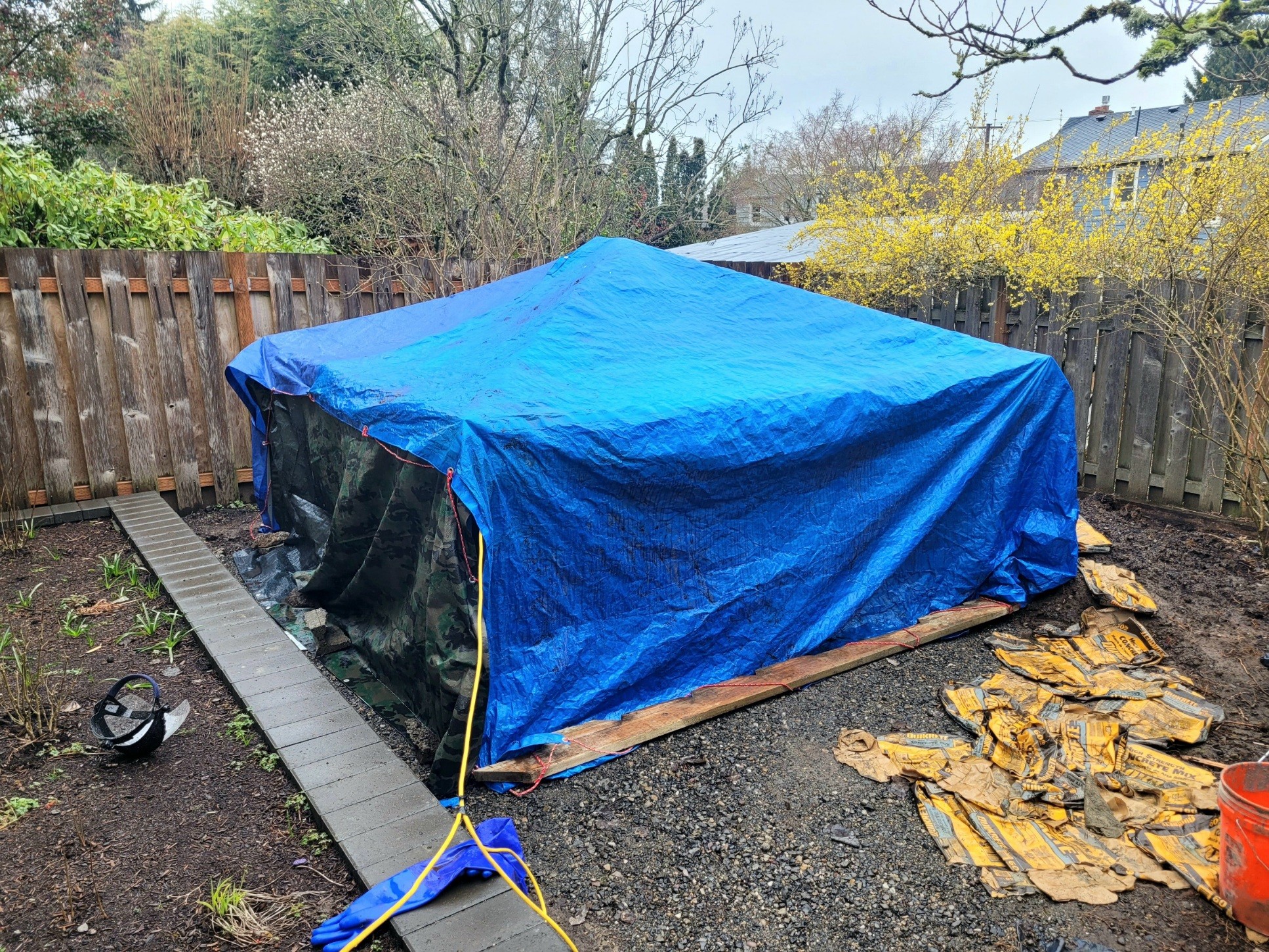

                            I am glad to see the discussion on best methods for cutting concrete. I stopped wetting my slab after NC's comments, but also concerned about freezing per Mark's comments so kept the space heater going under the hearth since we are experiencing freezing Temps 3 nights this week. Also setup the canopy again and used large tarps to build a tent structure all around for protection from rain, wind (thankfully not much to report) and temp variation. I just checked today and my temp in the tent with space heater going is 60F (15.5C). Outside it's 47F and raining.
                            I do not have plastic directly over the slab, but I could add that. The tend structure seems to be retaining humidity. My inspection today I can see there are areas of the slab that have firmed up on the surface, but others other like they have a thin sandy layer on top of solid surface. I plan on leaving in the forms for 2 weeks. Possibly longer if I'm not ready to move on by then.
                            I did get a measure water to concrete ratio as well, and found that I couldn't work with the ratio of 2 liters/60 lb bag. After some experimentation I landed on the ratio of 3.5 liters/60 lb bag. My method was add 4 liters to the mixer, then a 60 lb bag. Then mix about 5 minutes before adding 3 liters and another 60 lb bag. My observation was that if I did <4 liters on the first bag the concrete would cake to the bottom of the mixer and I'd end up with wet concrete spinning around on top of 2 inches for cake-like material. A few times I scraped that material off with a shovel, but found that process was too slow and also just left me needing to add more water to get a workable texture.

                            Forgive the mess - I finished this tent at dark on Sunday and rushed inside. Actually covering a muddy area with those concrete bags so I don't track a mess all through the house.
                            My build thread: https://community.fornobravo.com/for...-pdx-42-update
