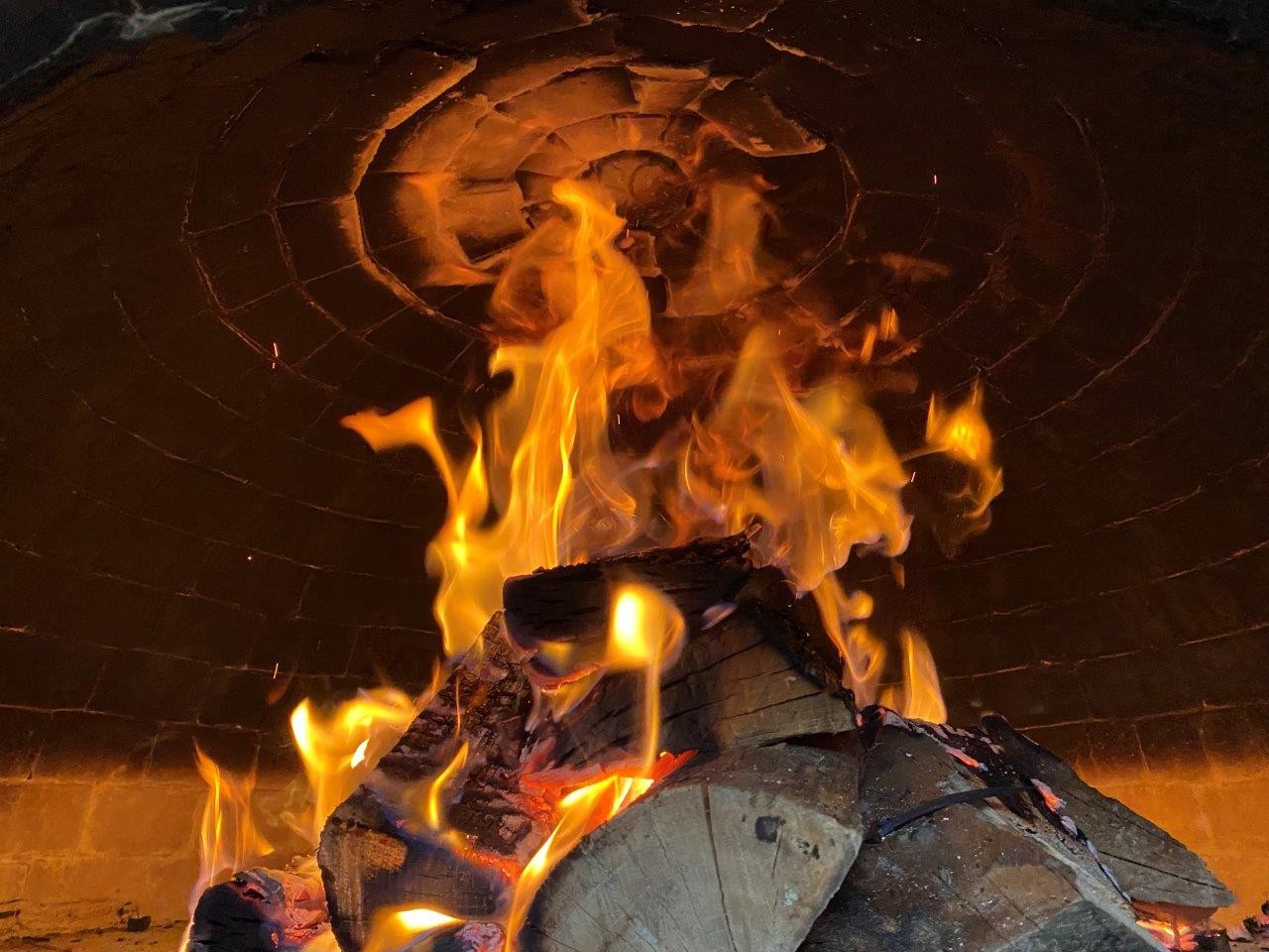

          I think the curing fires are complete, but still not finished with the enclosure. Approx two thirds of the work is complete.
          Luckily, I did some fires where I reached full temperature, to test it. This oven is really a magnificent thing.

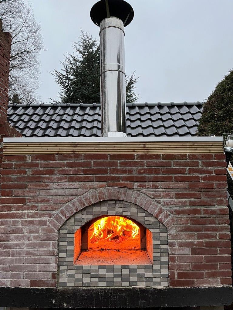

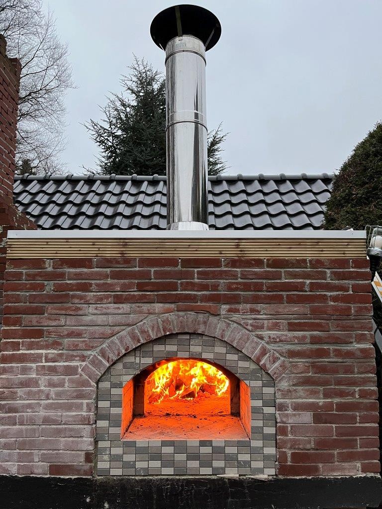

                          So, after a couple of months, it looks almost ready.
Name:	2023-02-12 17.44.59.jpg
                          I finalized the enclosure, built some roof, which was lined on top with some sort of EPDM cover, installed total of 1.5meters of chimney, and put some outdoor weather resistant tiles around the entrance of the oven
                          We are using it almost every weekend. This weekend was the first time we used it, that it was not dark.....
