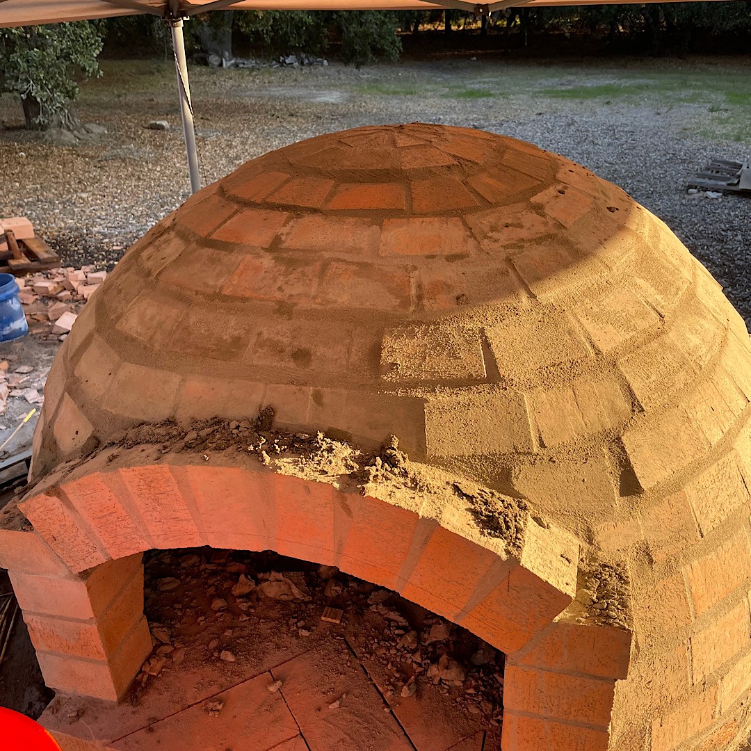

UtahBeehiver and Mr. Slowhand Thanks you have given me some fresh ideas on how I will approach the gallery arch and vent.Comment
Scraper and wire brush. Much easier to clean as you go with a damp sponge before it's fully cured.Comment

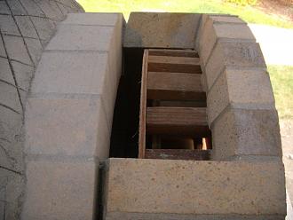

My oven drawings: My oven drawings - Forno Bravo Forum: The Wood-Fired Oven CommunityComment

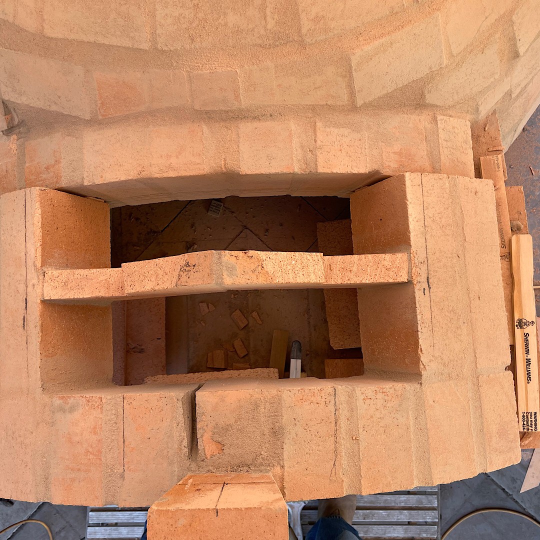

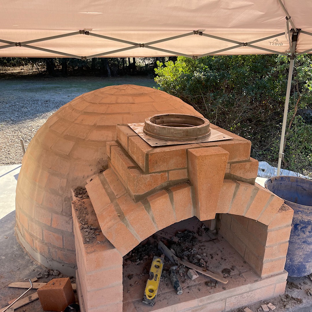

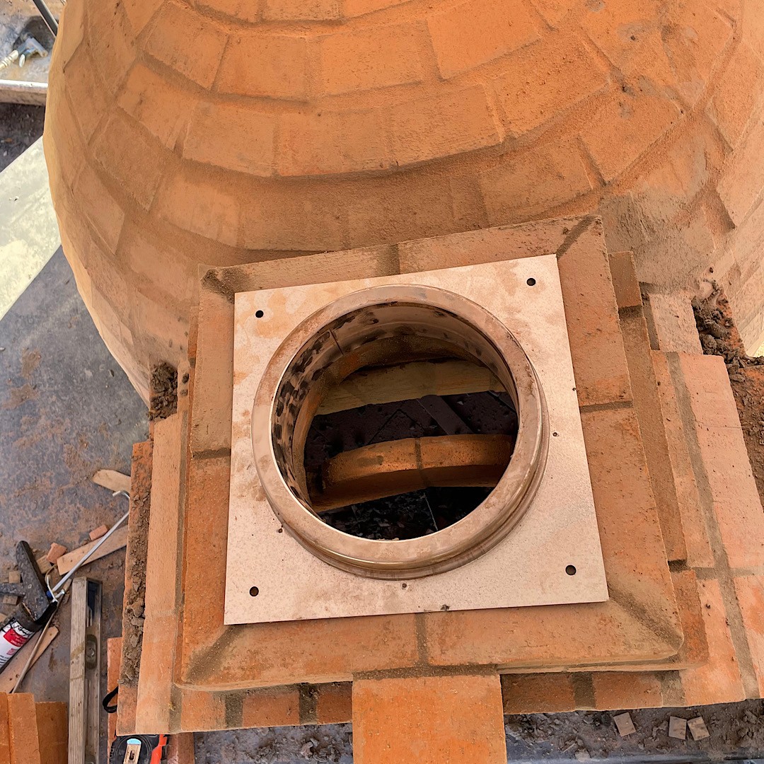

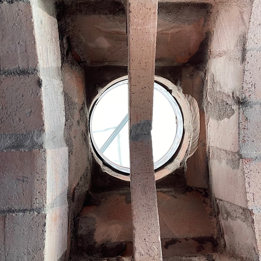

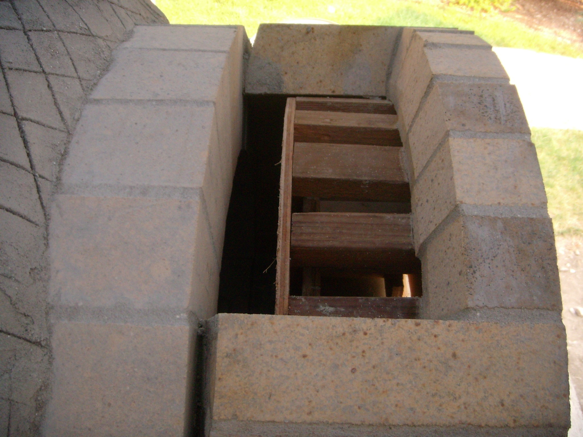

Follow up on the outer arch connection I was asking about. I ended up up making the gallery a brick and a half deep. The inner brick is spaced from the inner arch so I added a gusset arch to stabilize. Then I overlapped the inner arch for the chimney bricks so I could center the 8” flue. Almost done. What a challenging project

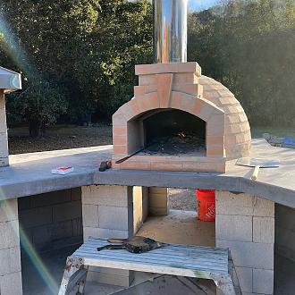

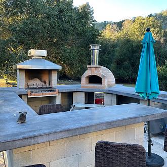

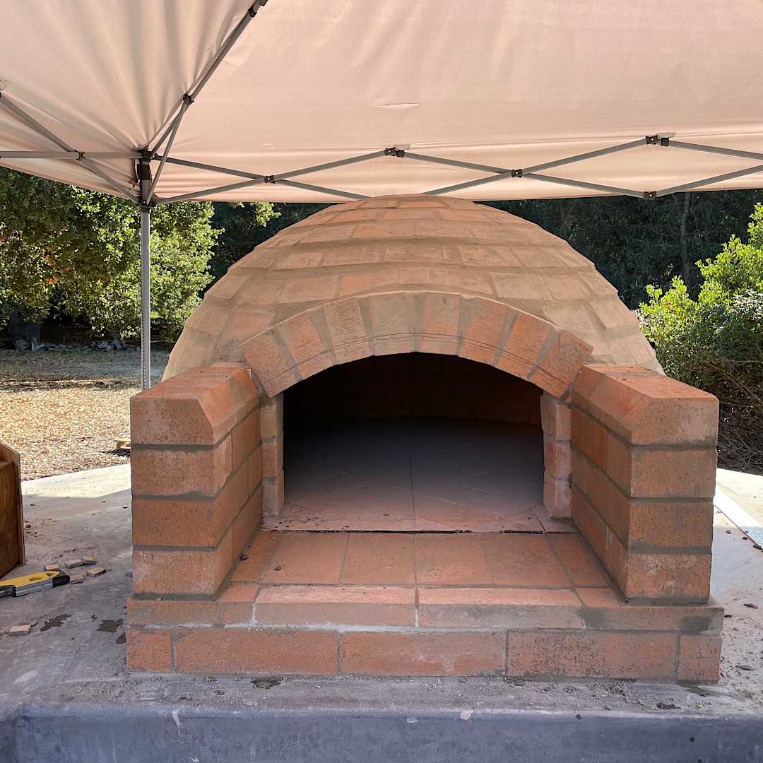

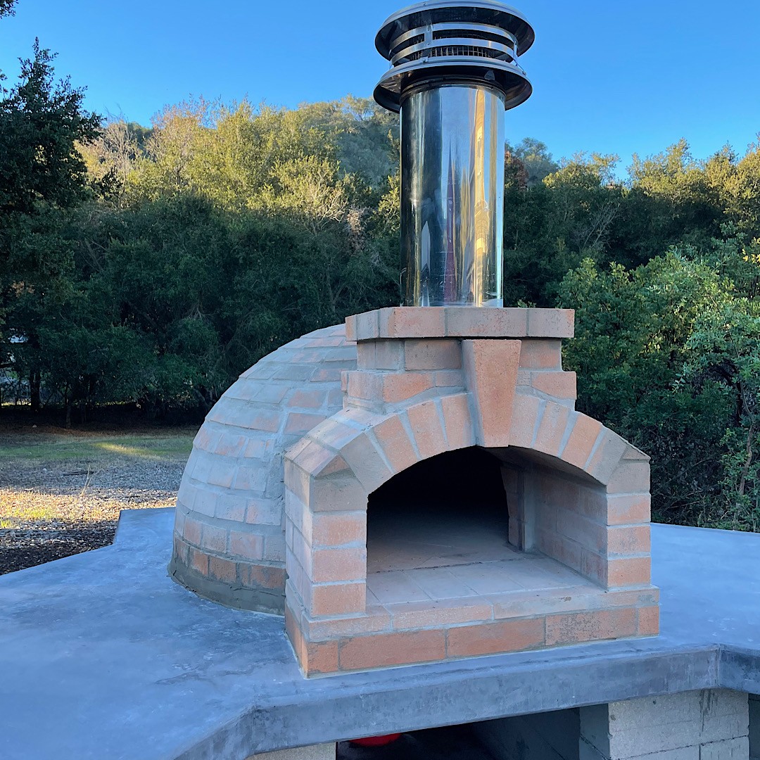

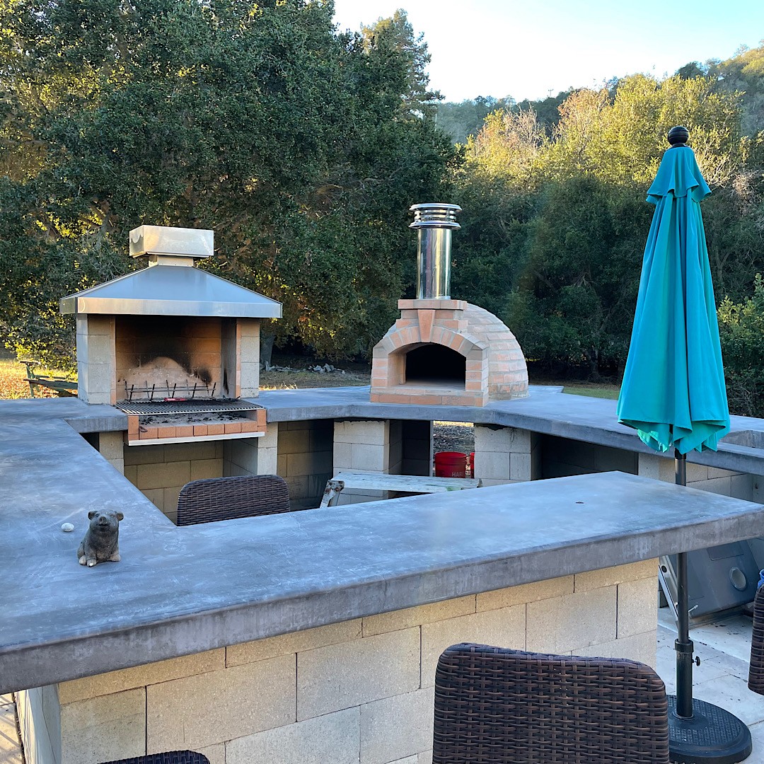

Well friends there you have it. 42” Pompeii oven and Argentine BBQ. I can’t wait to fire it up. I will eventually add some architectural finishes, But first some thanks are in order. First to the people at Forno Bravo who so graciously host this forum. Enabling our communications has been essential to the process. Second to all the senior builders whose patience to repeat the answers to the same questions over and over again to each new builder. And to do so with so much sincere support saved me from more than one mistake. And third to the Forno Bravo fraternity for sharing there struggles, successes and creativity. This continues to be a labor of love that has been a pleasure to experience with you. In my family we have a salute to friends “Cent’anni” a hundred years to you and your ovens. Michele

I would like to suggest that you insulate the dome "before" you start the cure. This minimized thermal differential between the inside and outside of the dome which will reduce cracking potential. The first few fire you can use charcoal briquettes which gets you about 200F with minimal flame and you can cook a dutch oven while you're at it. Great job PS I really like the Parilla, a main stay in outdoor kitchens in BA.Comment
Insulate your oven before any more fires, or you risk cracks from thermal shock. Particularly once the ambient temperatures are dropping. The internal temperature for pizza should be obtained around 20 mins of firing once all the black inside the dome has burnt away.
You have more weight on the un-butressed large radius arch than is comfortable IMHO, especially as thermal expansion/contraction cycling challenge structural integrity, but we do what we can get away with.Last edited by david s; 11-20-2022, 01:02 PM.Kindled with zeal and fired with passion.Comment
What I've found using my IR gun is that the floor needs to be 650f or hotter in order to cook the dough well... I tried doing it when the dome was cleared, but the floor was under 600F and learned a big lesson with the center portion of the pizza not cooking thoroughly. My top of dome temps get to be over 1000f in the process. Don't rush it, though... the bricks have to soak in the heat evenly for good cooking performance. It takes me one hour to get to temp, and I have to be watching and feeding the fire pretty much constantly, can't just set it and forget it, or it cools down.
BTW, your oven looks beautiful inside and out, but I completely agree with David about insulating before building temp further inside that beautiful dome!Last edited by Sixto; 11-22-2022, 12:40 PM.if it's worth doing, it's worth doing to the best of your ability!
Sixto - MinneapolisComment
Thanks guys. I have ordered 3" of blanket insulation from Forno Bravo and will secure that with wire and build a hut around that to waterproof the dome.
