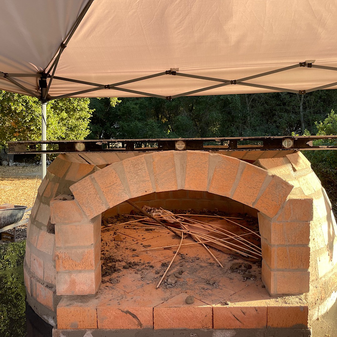

ID:	449163 Five courses up and still on the bubble.

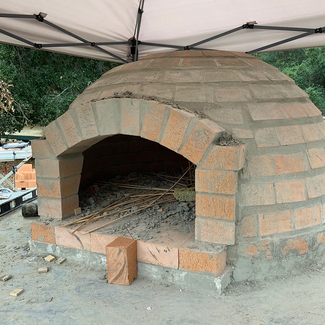

                          #42
                          Hello all, I have been quietly making progress and am close to closing the dome. But the part I just can’t seem to get my head around is the interface between the inner arch, the outer arch and the flu box. In some photos it appears the outer arch is really a double arch and in some photos it butts the inner arch to allow for a thermal gap.
                          I guess my question is how do you span from the face of the outer arch to the face of the inner arch with the bricks that make the sides of the flu box. I will be using an 8” dura tech flat plate to mount the chimney pipe to this structure. And my bricks are a standard
                          9 x 4 1/2 x 2 1/2
                          Any help would be greatly appreciated.

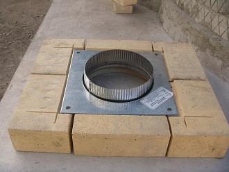

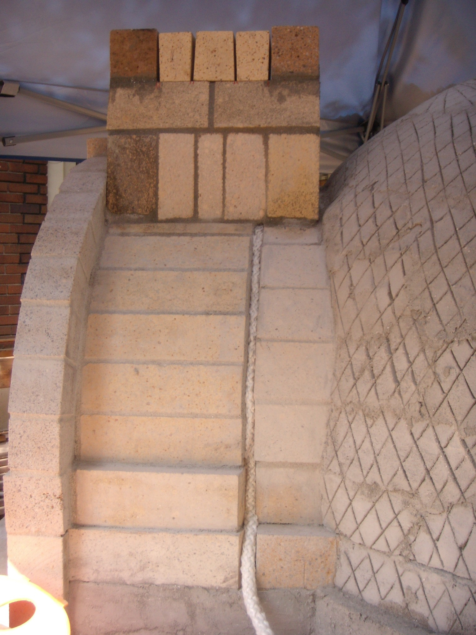

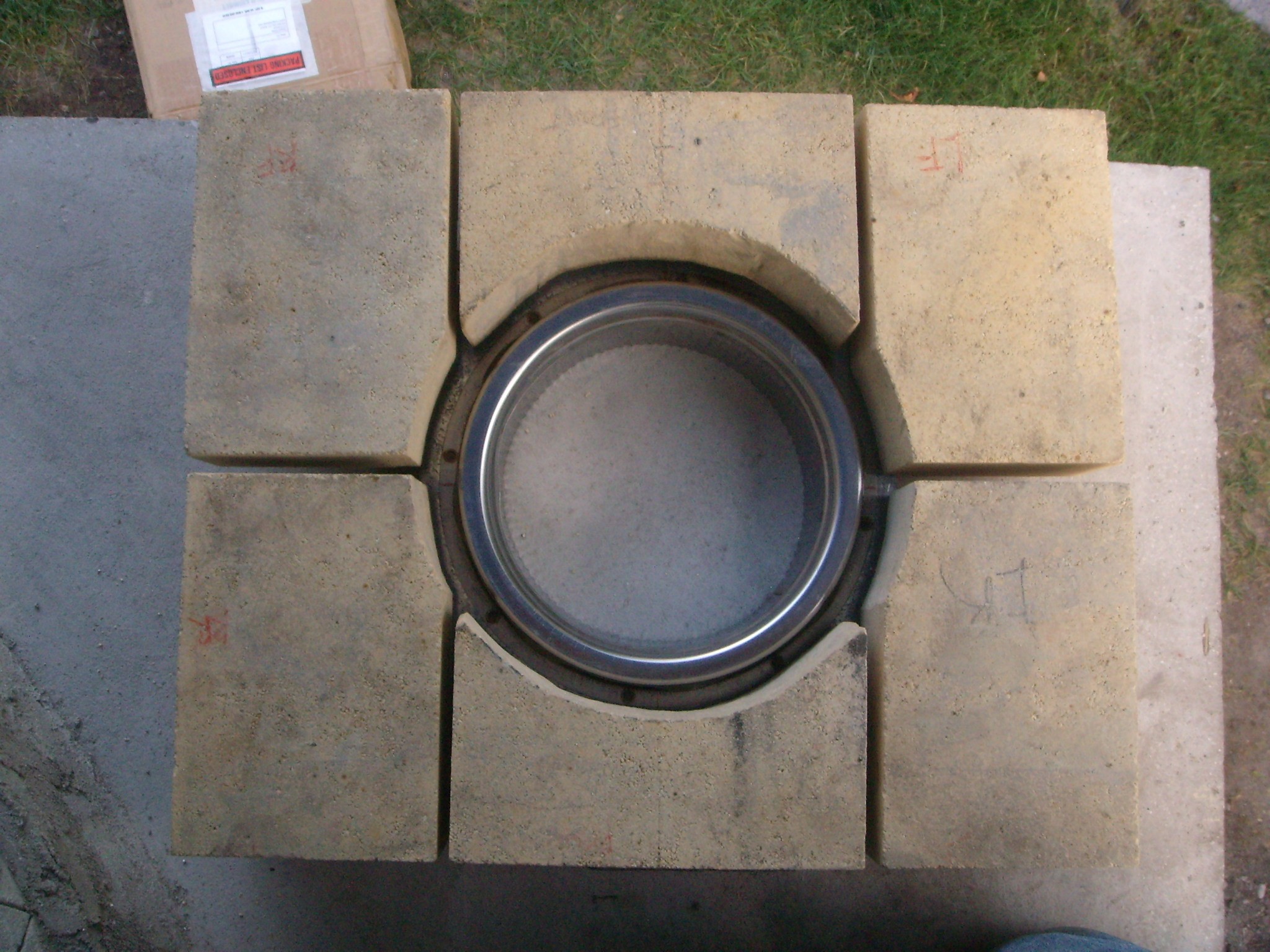

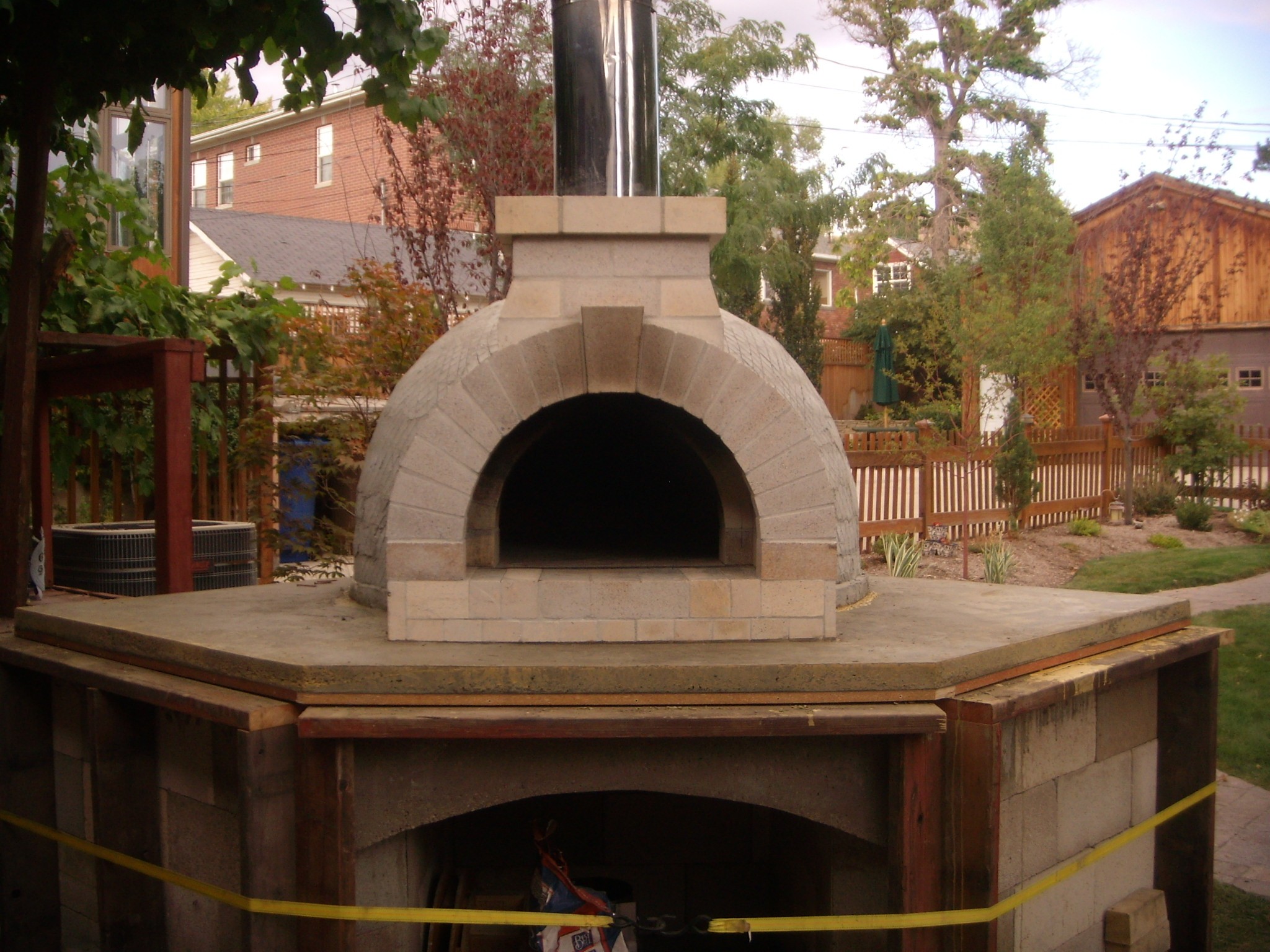

                            This is how I did mine but there are other ways as well. Be sure the you vent opening in the brick vent chamber has at least the same square area as the ID of your 8" duratech.
Name:	61A Ceramic Rope 8.25.12.JPG
ID:	449904 Click image for larger version
Name:	62A Cap Bottom 8.30.12.JPG
ID:	449905 Click image for larger version
Name:	62B Cap Top 8.30.12.JPG
ID:	449906 Click image for larger version
Name:	71A Unforming 9.24.12-001.JPG

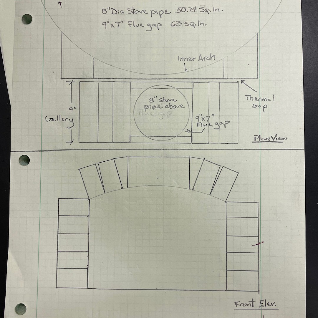

                            • Michele Enrico
                              • May 2021
                              • 53
                              #44
                              Russell thanks for the reply. It looks like you really have two arches that make the gallery. The outer and the inner horizontal bricks. As the outer arch is purely a architectural and continuous I am not concerned with that. With regard to the gallery is there a 1” brick at the front and the back at the top of the horizontal brick arch to keep the horizontal gallery bricks in tension and create a flue hole? I would need to see the top view of the gallery before you placed the flue box bricks. Below is a quick sketch to show 1” bridge brick front and back to support the gallery arch and ultimately the flue box. Am I on the right track?Click image for larger version
                              • Mr. Slowhand
                                • Jun 2022
                                • 77
                                #45
                                Michele, your WFO is coming great. As you say - silently coming along.
                                I will put in my 2cents on the flue gallery, for what it is worth. Just completed my WFO structure and for the flue gallery I have two arches and a heat gap.. I was planning to make the flue and "seat" for the chimney anchor also with bricks.
                                After some discussions, I just used the sand mould, and casted the flue. Ended up looking good, and was an easy exercise. I could have made the outer part much smoother and nicer, but did not spend any time on it, as I am making an enclosure, so will not be visible.
                                Most of all, even with high smoke levels, nothing was coming out through the front of the oven. As I understand, that has to do with the natural smooth slopes of a casted flue, compared to one you could make while doing it with bricks. It is made with the homebrew, while adding PP fibres and some AR fibres (I used basalt).
                                Another thing that helps is that you need to do only the vertical bricks of the flue gallery. As soon as the "arch" begins, the casted part of the flue takes over.
                                There are some consideration if you are casting the entire WFO, should you do it in sections, to allow for differences in heat expansion. This is absolutely not the case for the flue gallery, as it does not heat up significantly.
                                Anyhow, however it goes, I hope you will finish it soon!!! Good work!!
