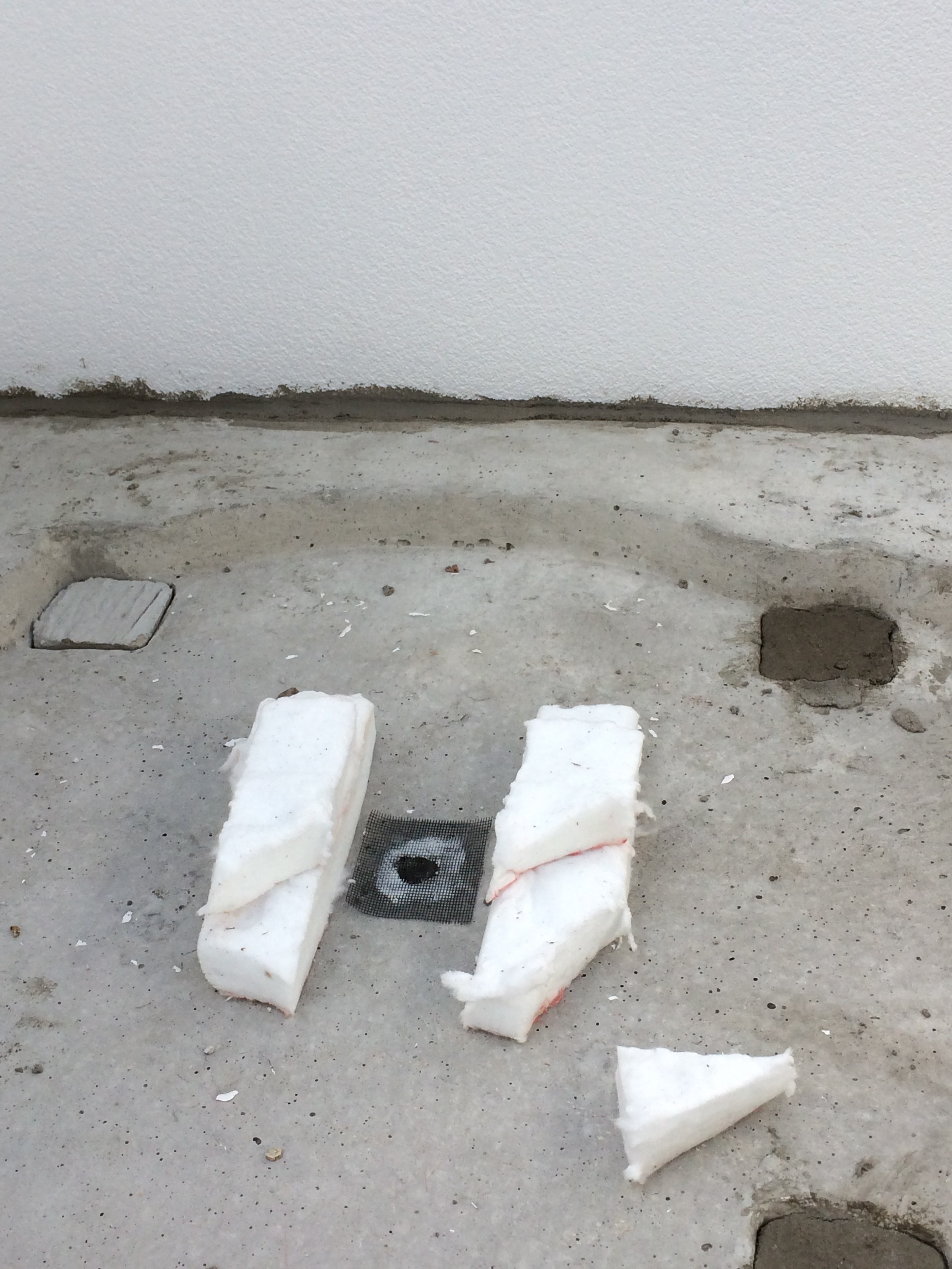

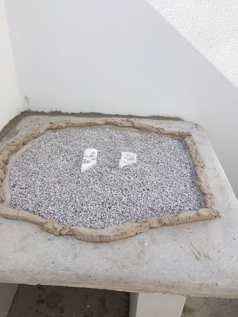

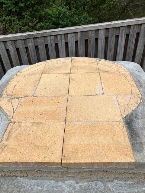

                          Here's my own solution which takes advantage of the higher insulation value of loose perlite in a recess in the supporting slab, but incorporating a two piece, triple sandwich, tongue and groove floor. But probably not suited to a single hand built project.
                          Click image for larger version  Name:	IMG_0346.jpg Views:	0 Size:	1.09 MB ID:	449487 Click image for larger version  Name:	IMG_0347.jpeg Views:	0 Size:	87.9 KB ID:	449488 Click image for larger version  Name:	IMG_0137.jpeg Views:	0 Size:	117.7 KB ID:	449489

                              My solution employs a 5:1 vermicrete as the bottom layer of the two piece floor which sits on top of the loose perlite contained in the supporting slab basin.
                              Thermal conductivity comparisons are difficult because they vary at different temperatures and there are lots of different units of measurement.
                              Perlite at 400C is 0.08 W/mK while isowool blanket is 0.09 according to Engineering toolbox, which places it as a slightly better insulator than blanket.
                              https://www.engineeringtoolbox.com/p...es-d_1173.html
                              Once you start adding cement the value changes rapidly (eg a 10:1 verm. or perlcrete contains more mass from the cement than from the vermiculite or perlite.
