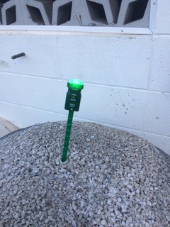

                  Also is there a good way to check when the perlite cement is dry and no longer storing moisture?
                  Also... would you recommend weep holes around where it meets the concrete?

                    david s commented
                    Editing a comment
                    When the surface appears dry you can be sure that it will still be moist deeper in. Like a pile of sand that remains moist deeper in for months, when it appears dry on the surface. A cheap garden moisture meter is a pretty good tool for this purpose.
                    See my experiment on weighing an insulating slab to measure its drying.
                    Weep holes through the supporting slab do a good job of allowing the moisture to escape as it runs away from the heat source. If not already cast into the slab they can be drilled, or if the insulating slab is already cast over the supporting slab, they can be drilled from underneath.
                    I've done a few repairs on ovens that had no underfloor weep holes and the recommended build had called for marine ply over a steel stand. Accumulated water in the underfloor insulation had nowhere to escape, so consequently sat there, rotting the plywood floor. Half a dozen1/2" holes drilled through the mushy ply floor allowed the moisture to escape restoring oven performance once it all dried out.Heat and moisture is a bad combination for steel and wood and for this reason is best avoided for ovens.

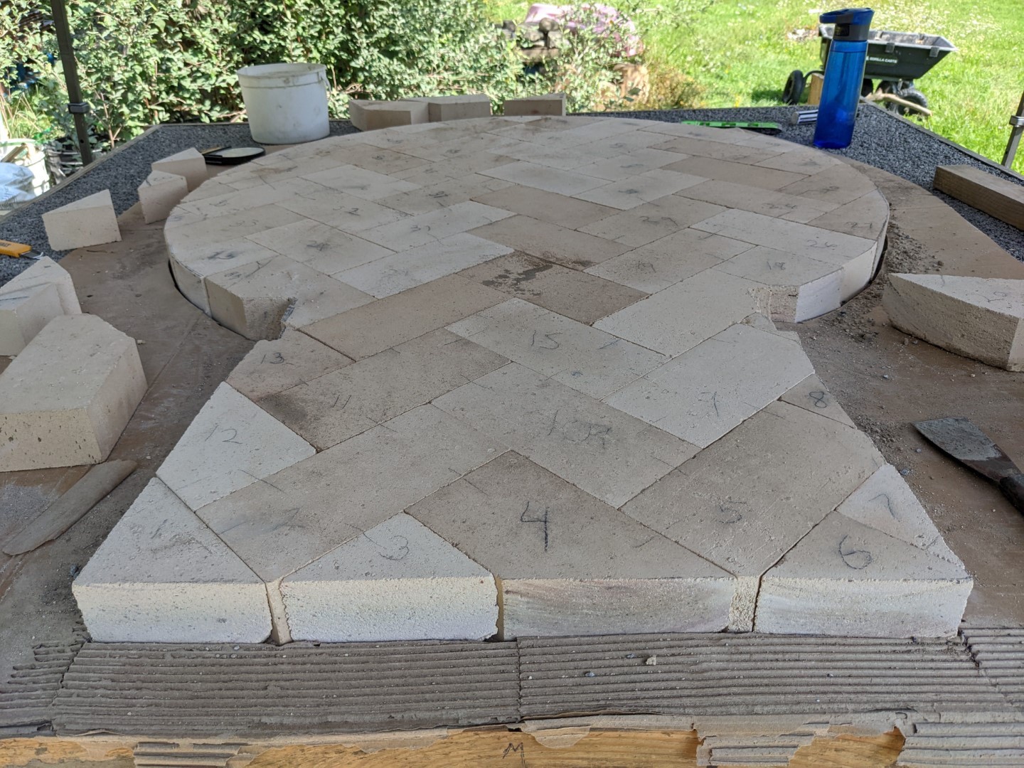

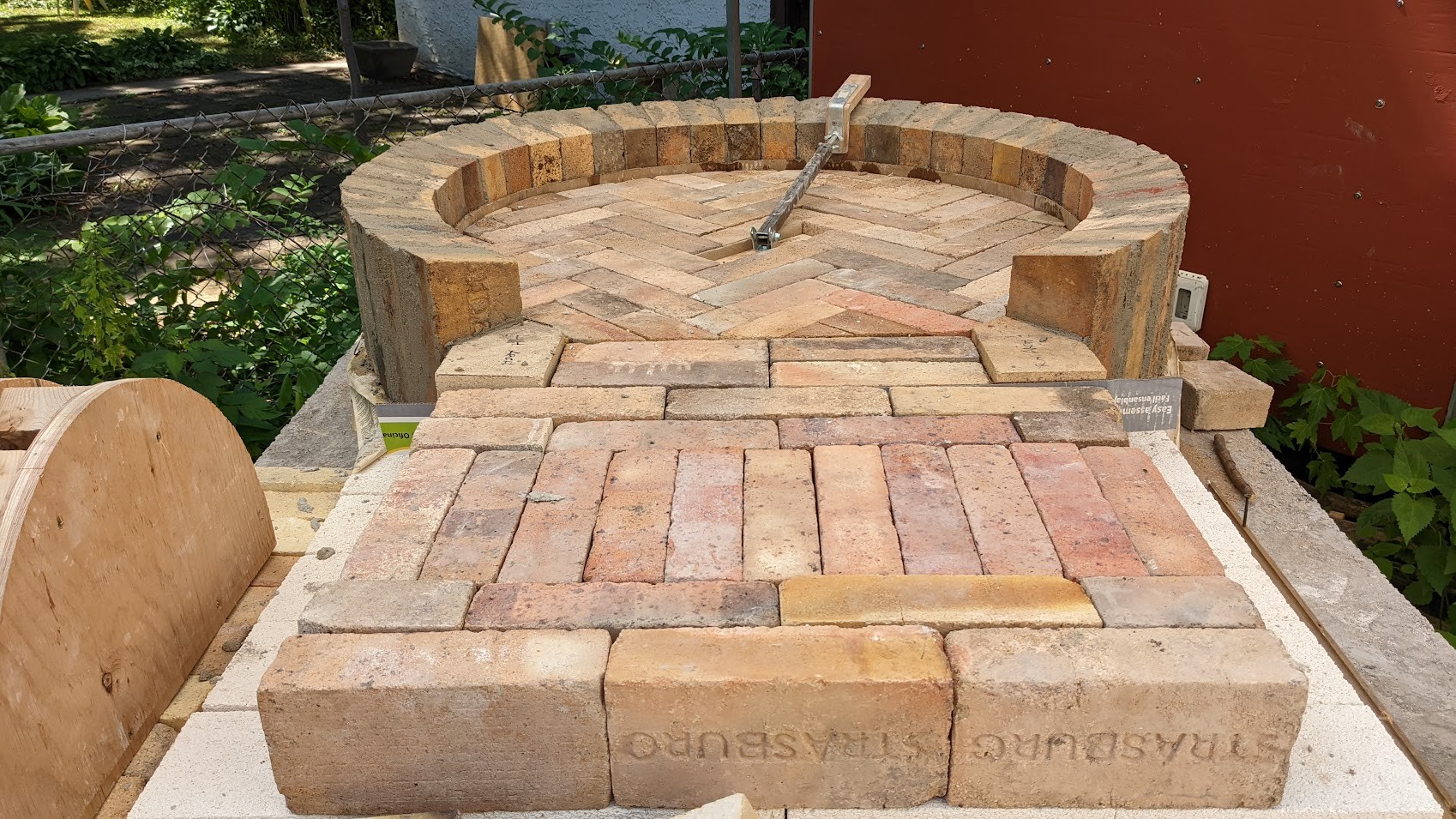

                      1) would using full size soldiers be ok or should i make them shorter?
                      2) do you cement the soldiers to the floor (in this case perlite cement) or do the firebricks? or not at all they just cement to each other in a circle?
Name:	PXL_20220918_181714332 (Large).jpg
                      • Sixto
                        Sixto commented
                        Editing a comment
                        Originally posted by lowspeed View Post
                        Can someone post a picture of the right way to do it? cause it's pretty confusing.
                        I understood that the best way is to lay down the 9" flat on the narrow part in a circle around the brick floor. So that from the sides of the brick floor you would have 9 inch bricks extending out and then the 2nd layer sits on it.
                        it would stick out above the brick floor in this case 2 inches. (4.5 brick width -2.5 floor height)
                        Here's how I did it.
                        And here is a link to my thread, in case you want to look further... lots of helpful comments to my questions from other forum members... https://community.fornobravo.com/for...inneapolis-wfo
                        UtahBeehiver commented
                        Editing a comment
                        If you feel you need to use a soldier then use half height soldiers or use half headers. I would only use a thicker floor if you envision doing lots of bread making. Thicker floors provide more thermal mass but take longer to heat up and use more fuel.
                      • Sixto
                        Sixto commented
                        Editing a comment
                        in the above image it's set as soldiers right? (Sixto image)
                        https://community.fornobravo.com/fil...etch?id=449790
                        Yes, my first dome course was a full-soldier, and my floorbricks are a shiner or rowlock in a basketweave pattern. What Russell is recommending is that for most people, a 2.5" thick floor would have enough mass, and then a half-soldier would have less side-thrust since the height and width are the same 4.5". The first course above the half soldier would be 2" above the floor. I fully agree with him, but I wanted more mass in my floor for baking bread. It does take longer to heat it.
                    • #29
                      Full soldiers are more prone to horizontal pressure from the dome above and may require buttressing of the soldier course. Half soldiers or half header would be better
Name:	brick orientation.jpg
ID:	449764 Click image for larger version
Name:	arch force.JPG
                      What about sailors? I actually am planning to put the narrow side all around
                      • #30
                        The blocks are 2.5x4.5x9 inch
                        I want to clarify, you're saying 9inch going up is fine as long as they are set going around the surface bricks but with narrow side touching the surface of the bricks?
