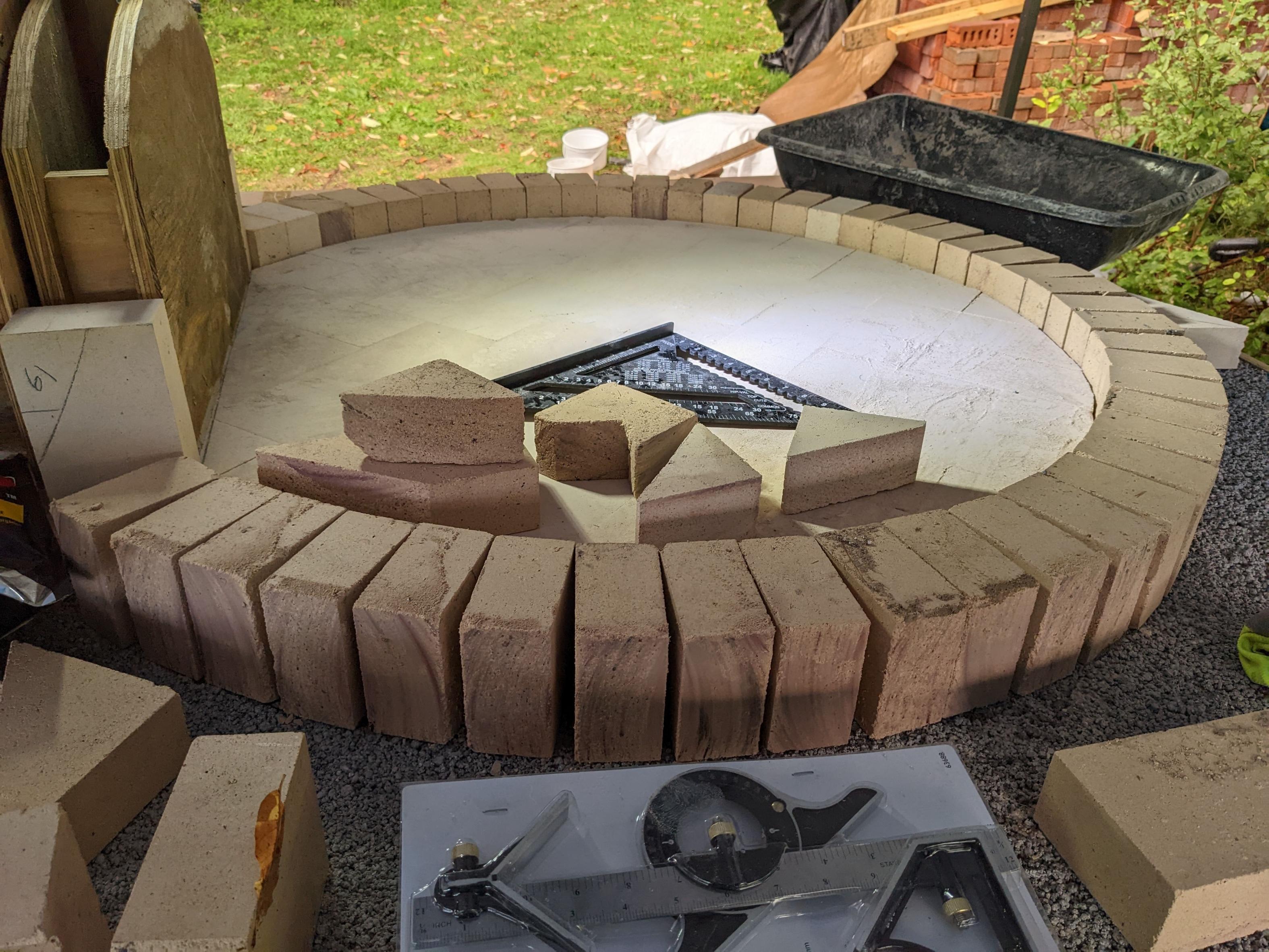

    Can someone post a picture of the right way to do it? cause it's pretty confusing.
    I understood that the best way is to lay down the 9" flat on the narrow part in a circle around the brick floor. So that from the sides of the brick floor you would have 9 inch bricks extending out and then the 2nd layer sits on it.
    it would stick out above the brick floor in this case 2 inches. (4.5 brick width -2.5 floor height)

      Thanks, that's a thick floor. is it work going that route? I right now mine 2.5" thick, I can still change it...

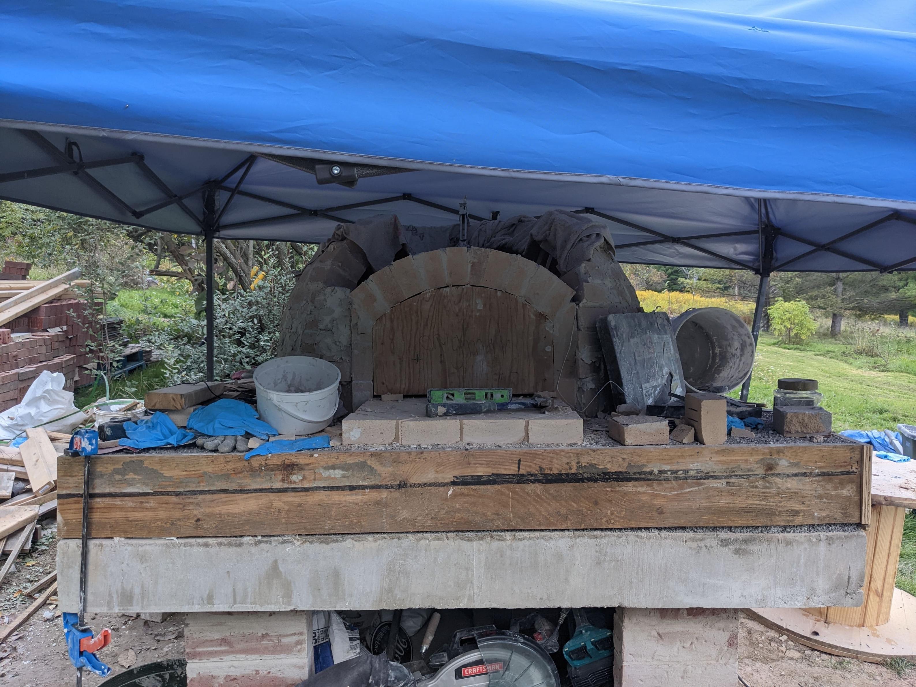

                Should the flue opening be as close as possible to the arch or should it be further away in the opening tunnel?
                So in the case here should the flue hold be right there or should i build out the tunnel a little more and then the hole?
                  Peope have done it both ways and they all work.
                  My flue opening is right next to the dome arch, in order to do that, you either build a secondary arch just around the dome arch (with an insulated gap), or you support the flue directly ON the dome arch. I chose to have an insulated gap between the dome and the flue arches because I did not want the chimney to pull heat from the oven by being in direct contact with the arch. Some people build an arch in front of the dome arch and seal the joint with one or two high heat gasket rope lengths. Some people make the arch out of custom cut ¨L¨ shaped bricks so that the flue arch wraps around the front and top of the dome arch. Other features of building the flue opening closer to the dome are the opportunity to have a reveal for the door to close tightly, and a shallower gallery to make it easier to work the oven.
                  You had also asked how someone would find a question buried in a thread, The answer is by using the forum´s SEARCH function…. Íve spent many hours looking selectively through others´´posts to find alternative ways of doing things. I can understand someone wanting the answer quicker, but sometimes the answers I got were not enough (or my question was not clear enough) so the SEARCH function has become my best advisor in my quest to find answers.
                  Finally you had asked me about my floor bricks, I thought I had answered, but I don’t see it now. My floor is 4.5¨tall because I wanted more retained heat for baking bread. The downsides are more bricks and more joint to level, and it takes more wood to heat up. Most people build their floor 2.5¨thick, and that works fine. Some people use 12¨square bricks (2.5¨deep) to minimize joints. I just wanted more heat stored in my deeper floor. I have not yet built an insulated door, so I dońt know how well my oven retains heat from one day to another. I use bricks to close the arch right now… Íve only made Pizza 3 times, and last time I also used it to roast a brisket the day after pizza, and with no added fire, the oven was at 350f the next morning, and went down to 240F after 6 hours of cooking the brisket and another pan of sweet potatoes. I unbricked the opening 3 times during the roast. A good insulated door is tops in my priority list.

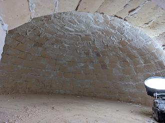

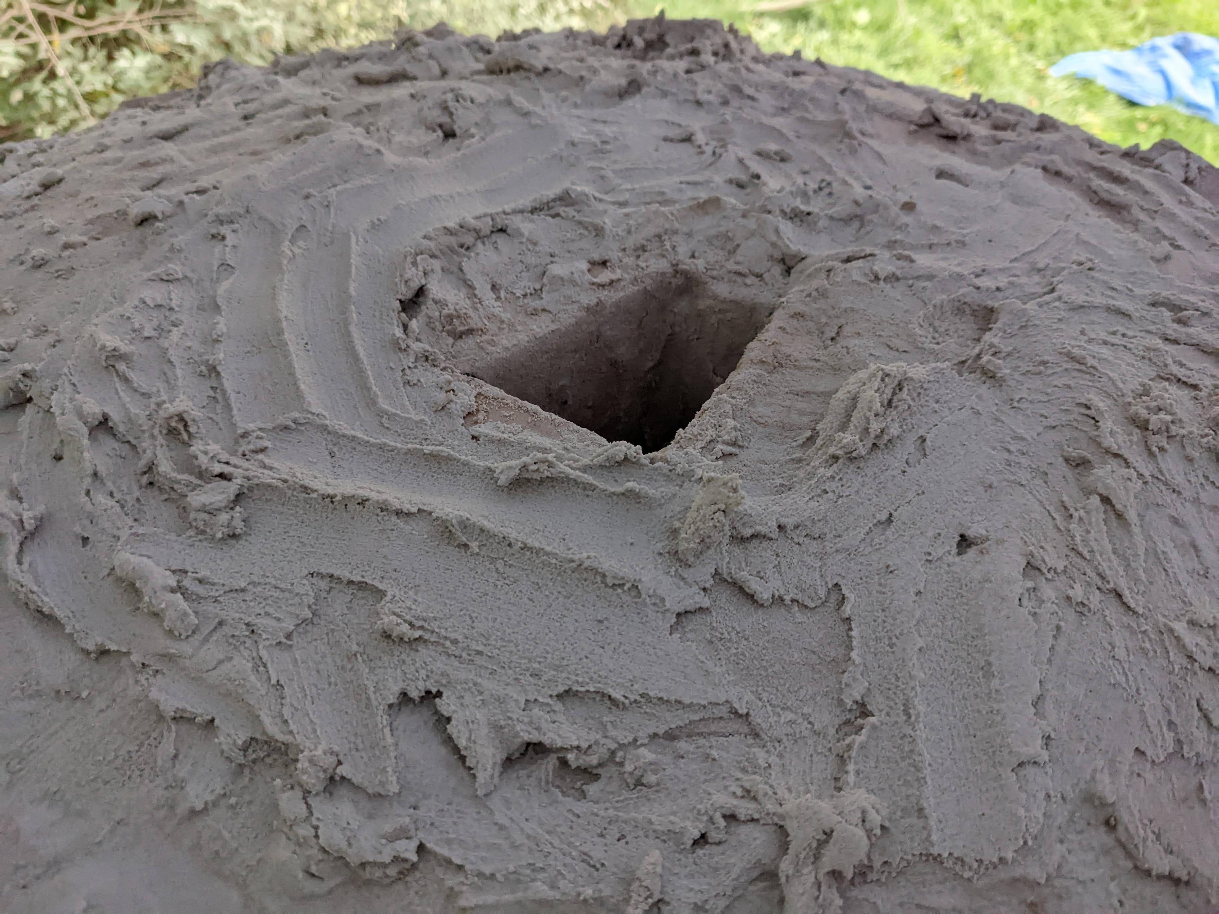

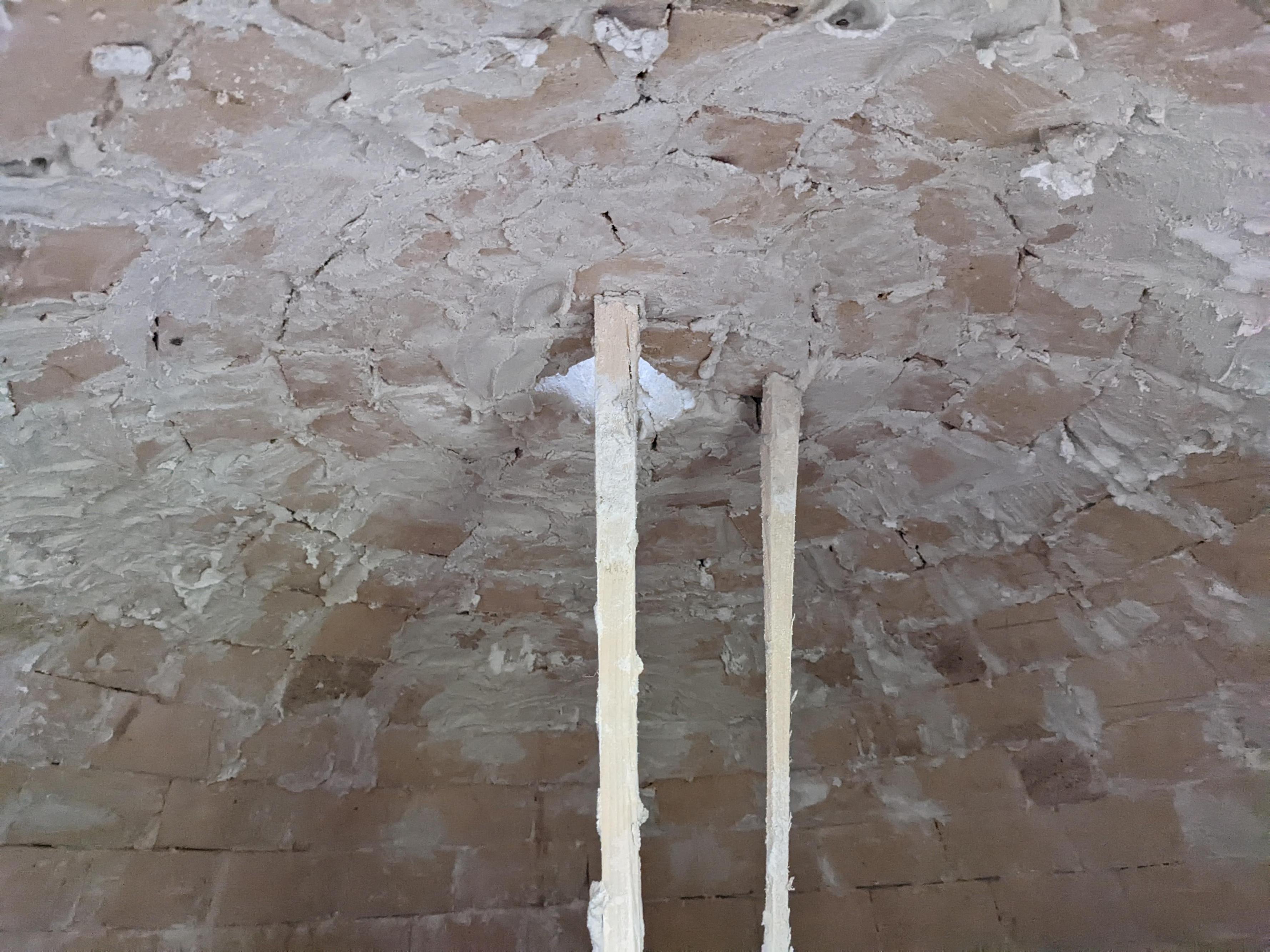

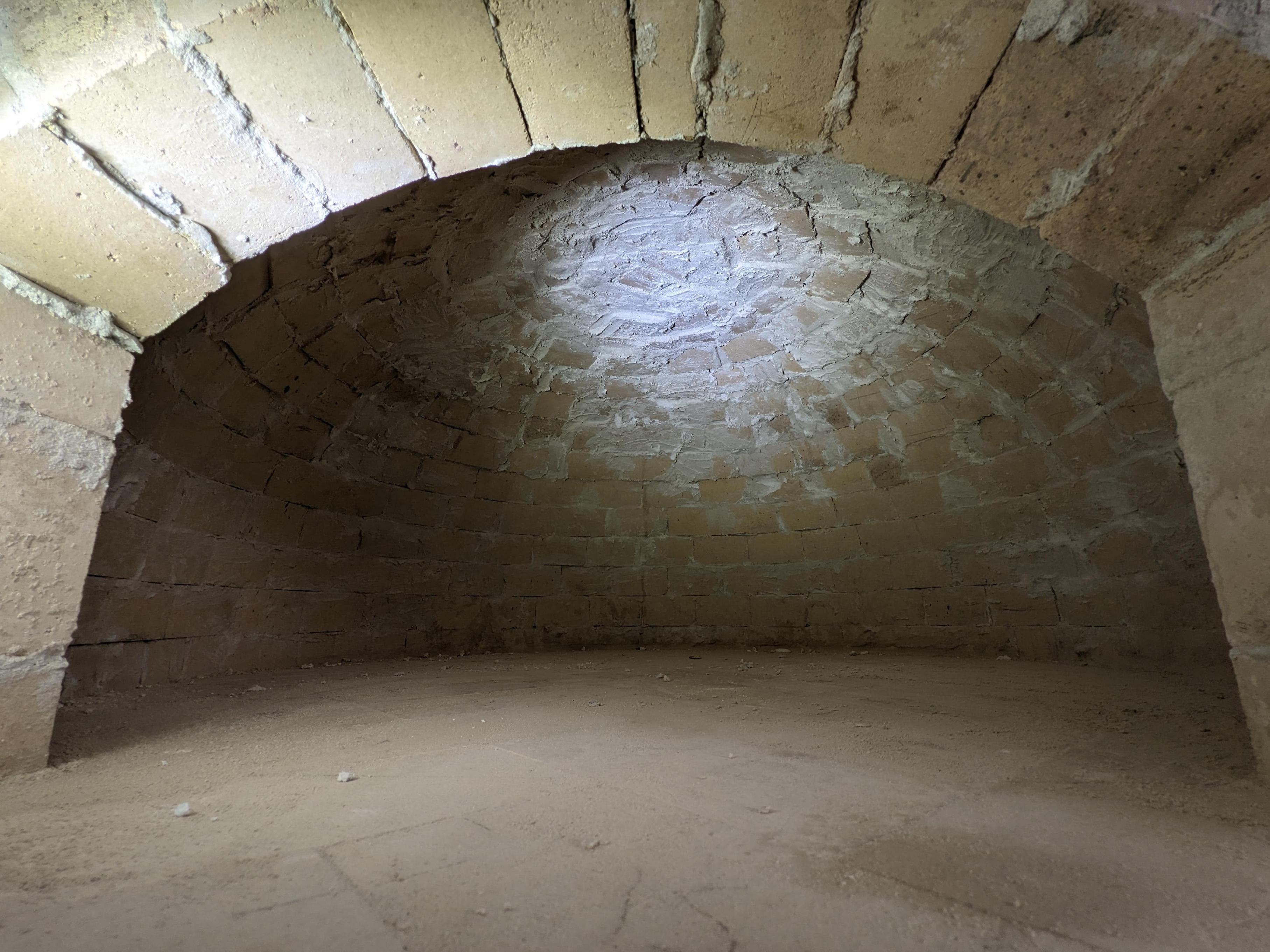

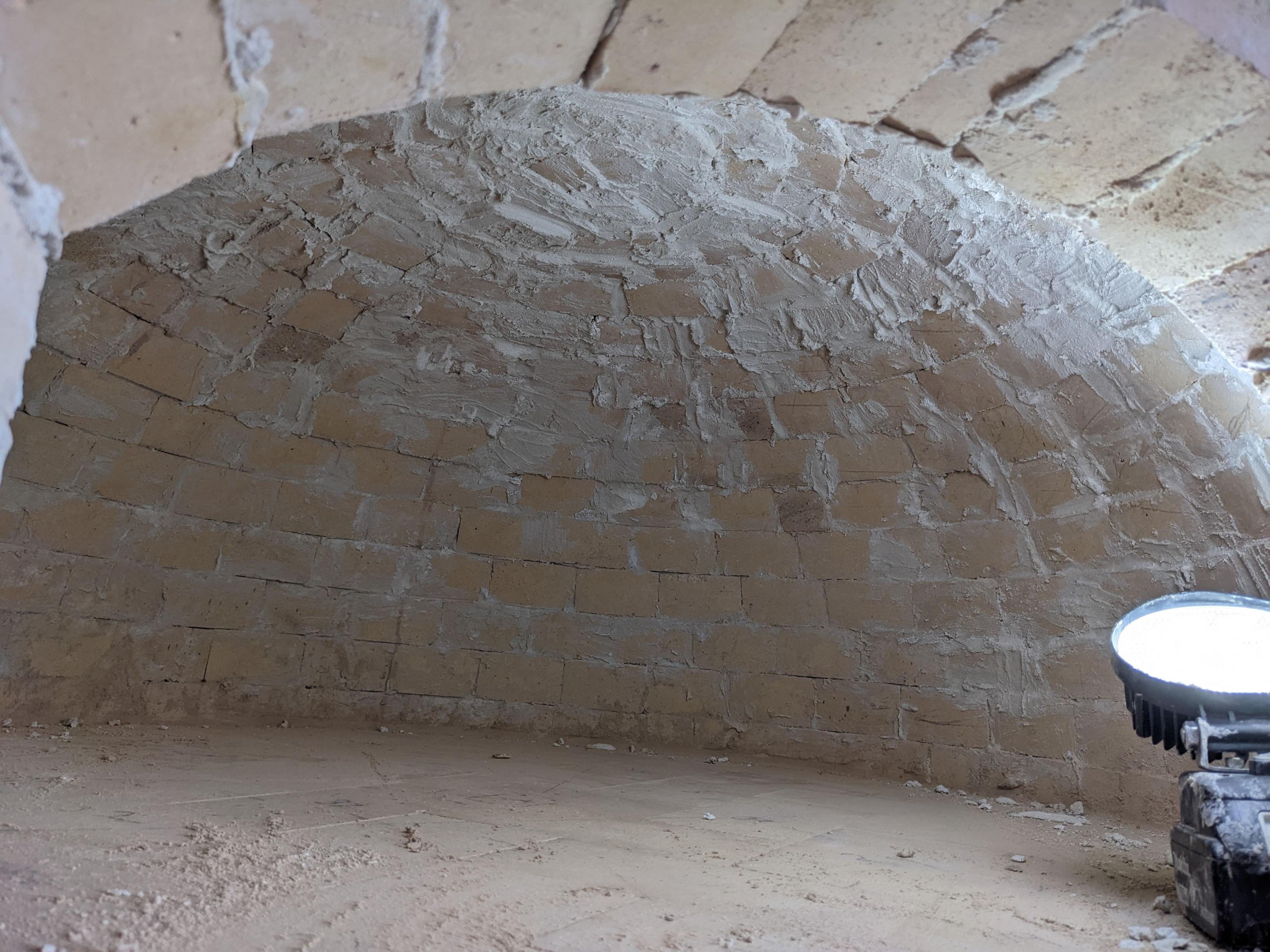

                      Finished the dome!
ID:	450224 Click image for larger version
ID:	450227 Click image for larger version
ID:	450225 Click image for larger version
