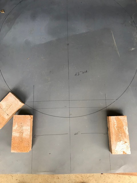

            Just getting my template ready for the oven floor. Cant seem to get my head wrapped around where to start the opening bricks. Should they start where the radius of the oven and the width of the opening intersect ? Click image for larger version

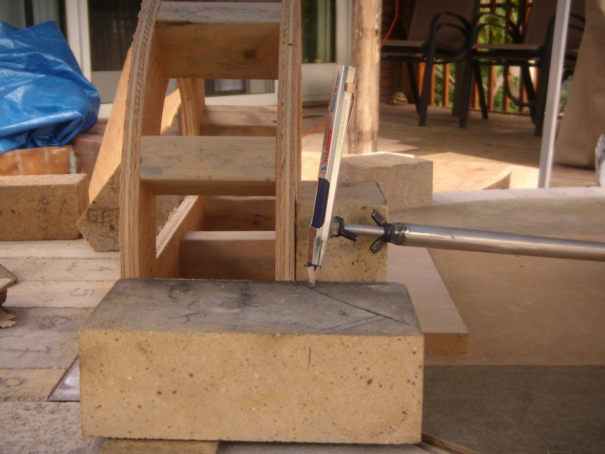

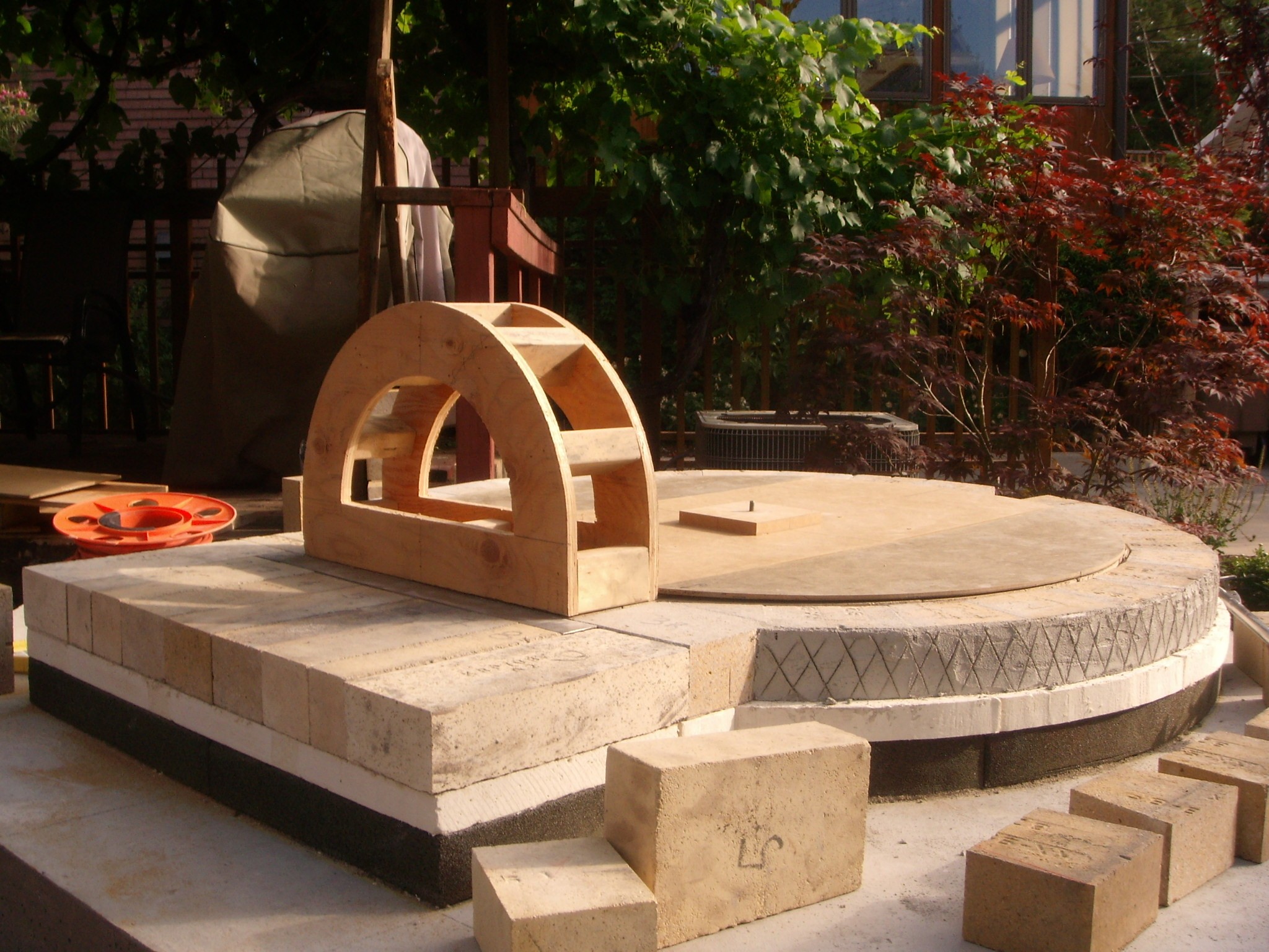

              The inside of the inner arch bricks need to intersect the ID of the dome.

                Thank you , thats what I was wanting to know.

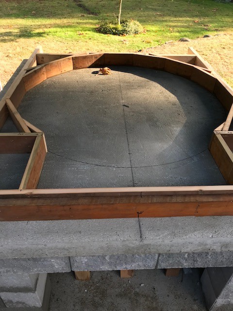

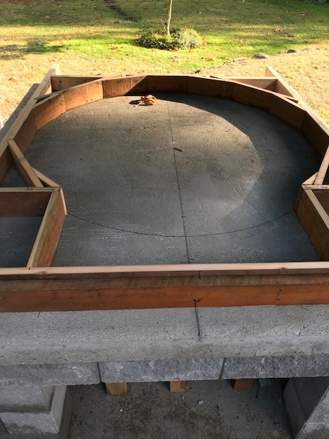

ID:	450465 Trying to figure out where on my slab to place my form for vermiculite insulation concrete. What would be a good place to put it in relation to the front of the slab for a good to work the oven distance.The problem is I dont know where my front arch will end. Is there a general measurement from the center of the oven to the front arch ? It is a 42" oven. I am kind of guessing with the form where the front will be. Should it be right at the front of the slab ?
