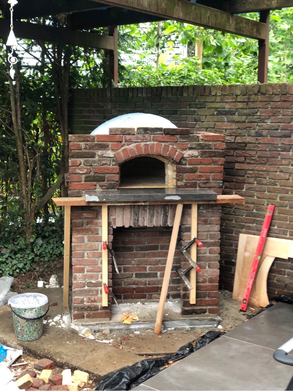

    Finished the first arch from the chimney. And put on two layers of super wool insulation.
    because I will put the dome in a square box it will be filled with “normal” glass wool. So the on top of the dome a lot of insulation.
    there will be a roof over the dome itself and the oven will be under a flat roof completely so rain will not reach the oven itself.

      Almost done. In two days the chimney will be connected first some concrete drying time.
      I will start firing up around Thursday. First some low temperature heating and then slowly building up the fire over several days.

        I let the oven dry today. So we put in the floor tile. It’s starting to come together but still a lot to do.
        • Bartolomus
          • Mar 2023
          • 22
          #19
          The door still needs some work because the fit is to tight (It does not go all the way in).
          the gas burner is only for the first two days with a maximum of 60 degree in the dome.
          in the end the dome went to 63 degree Celsius and after placing the door and 10 hours later it was still 43 degree Celsius. We will see how it will hold higher temperatures.

                      Well oven temperature was yesterday 130 degree Celsius at the top and 100 at coldest spot. 12 hours later with door as is closed the top dropped to 100 and coldest spot was 85. Not too bad I think.

                        First fire after the two gas runs. Temperature went to 300 to 375 degree Celsius in the top.
                        next will be 400.

                          Well after the initial wood fires which slowly build up to maximum after 4 days. I can say it works very well.
                          last weekend party with 30 pizza’s which where no problem at all. Today baked bread for the first time with other things as well from the retained heat. I could fill the oven two times and learned I could do 4 fillings.
                          each filling would be around 8 breads of each 800 gram.
