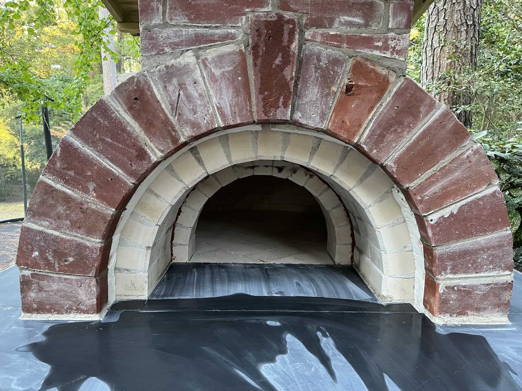

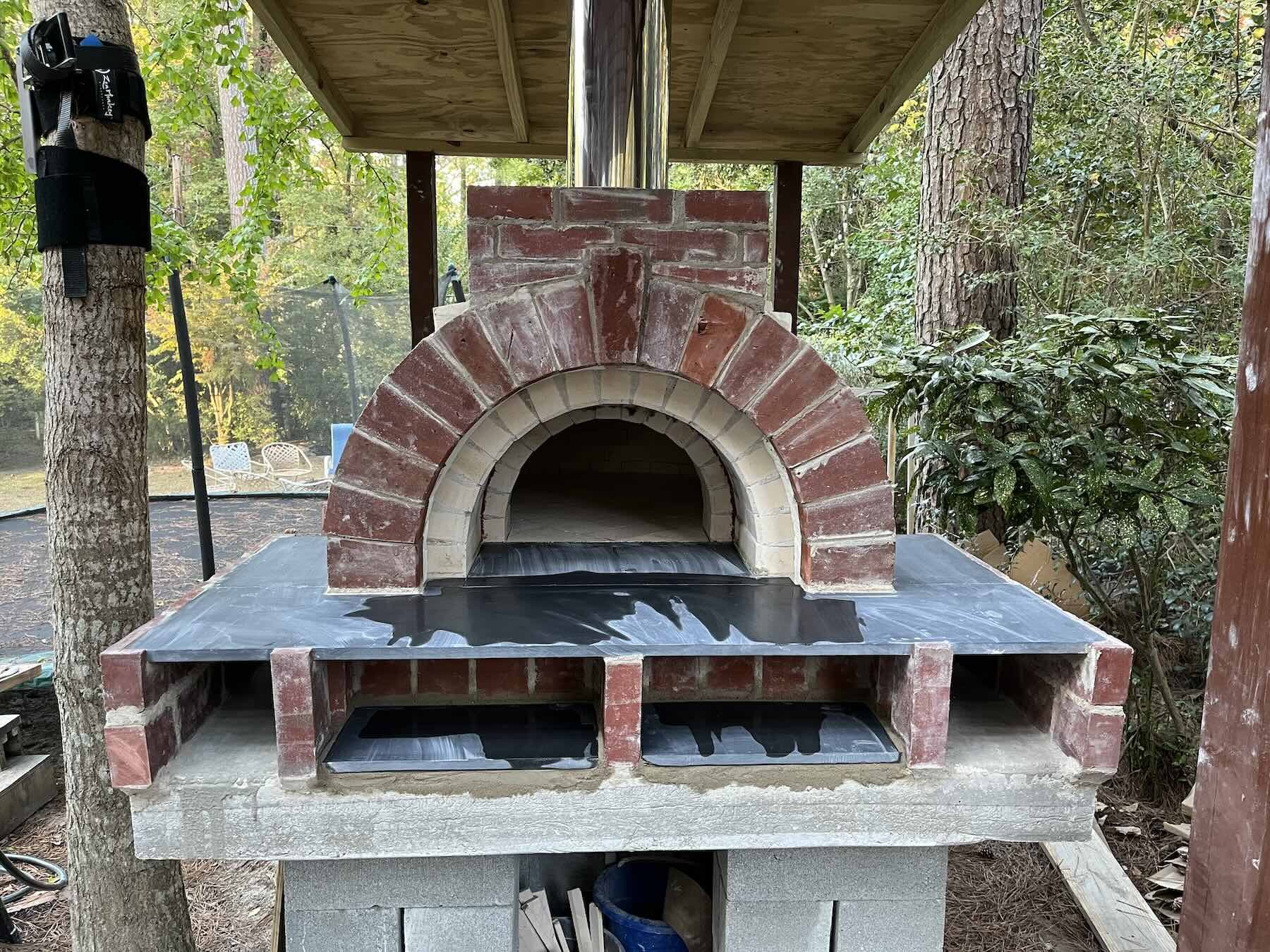

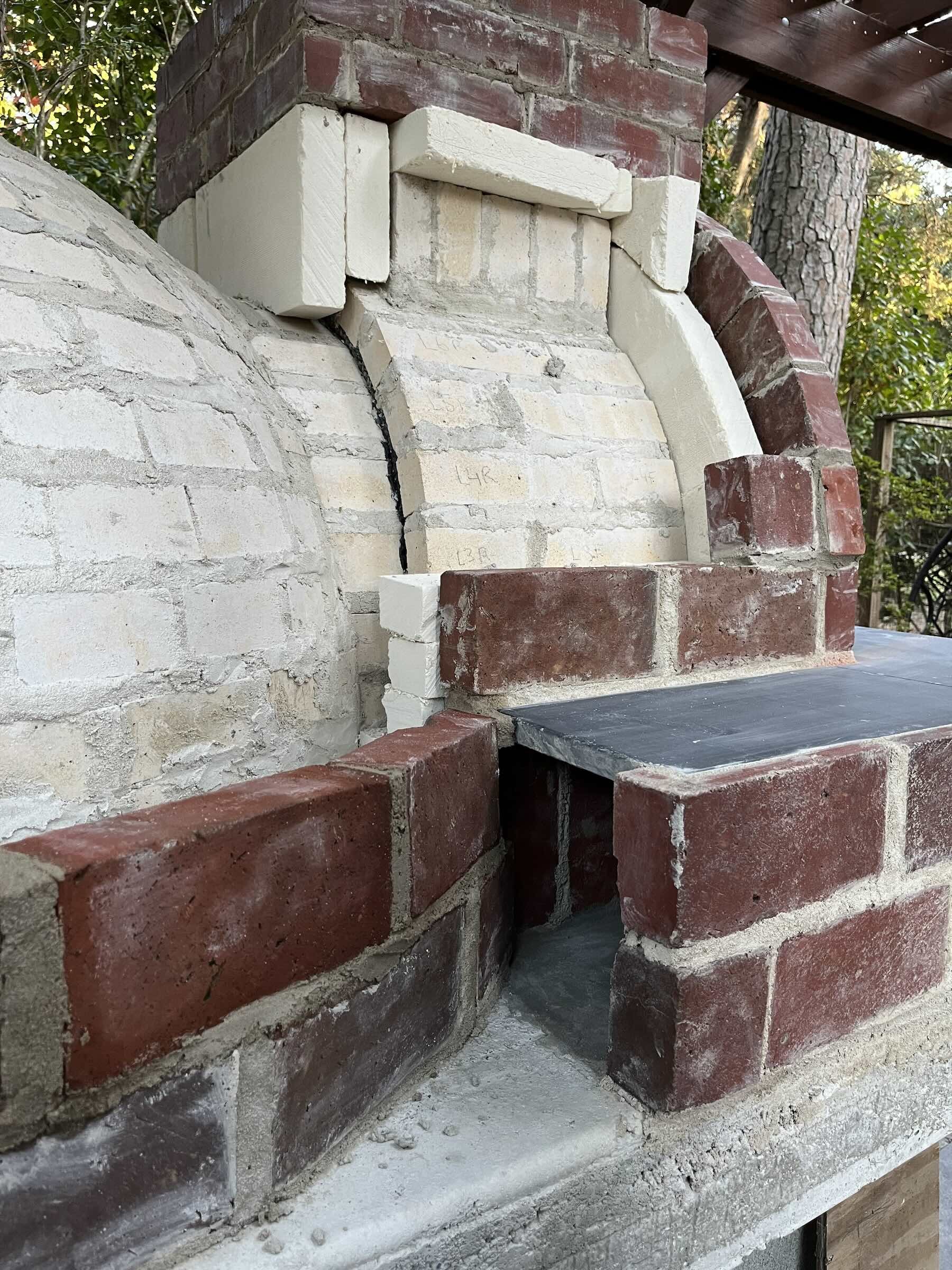

    This weekend I built the decorative arch. I was quite nervous about it being a pretty thin (bricks are vertical), freestanding unit, so I also constructed a short brick outer chimney connected to the decorative arch. The chimney is separated from the inner chimney transition by 2 inches of the CalSil board, so the whole thing is pretty rigid and able to provide a good connection to the decorative arch.
    The arch itself is separated from the front of the vent arch by a piece of CalSil board as well. I plan to cover the exposed part of the insulation (on the inside) with vermicrete, covered in turn with a thin layer of render.
    I also went ahead made the keystone stick out proud, with a thin piece of brick behind it to help the arch structure. I'm quite happy with how it turned out.

      I decided to put a silicone gasket around the bottom of chimney anchor plate, I used the red high temp permatex silicone for that, as well as for the space between the oven and the vent arch. It is super-tacky stuff, so it is not as neat around the arch as I would have liked, but with a little bit of extra clean-up it will be fine.

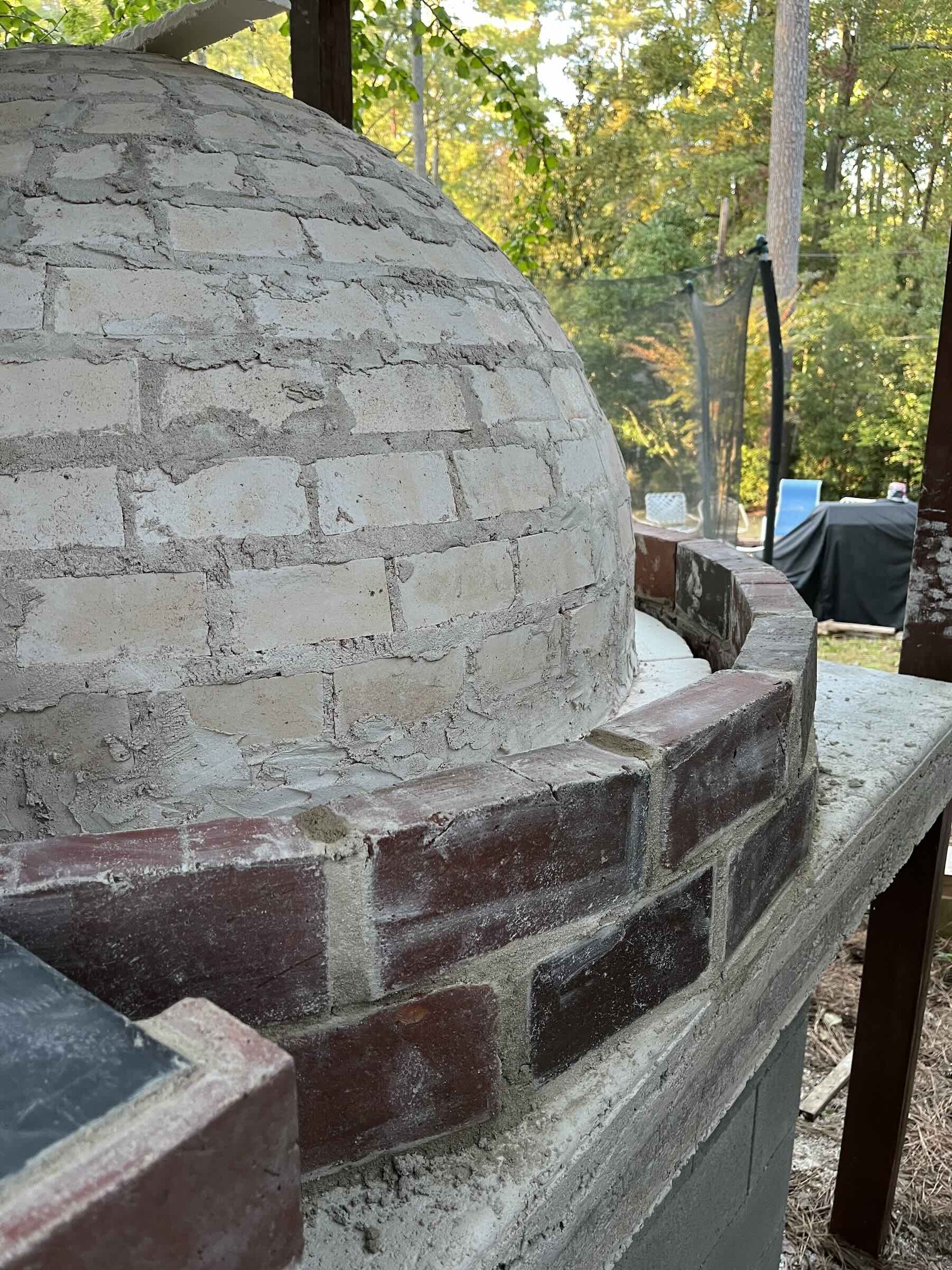

        I also mortared in place the bottom courses of the outer shell for the oven. These are two rows of old bricks, which reach up to match the level of the landing/workspace. For the remainder of the outer shell, I plan to use the same thickness as the bricks (about 2.25"), with about 1" for a vermicrete layer to shape the dome, about 0.5" of render, and then 0.75" for brick veneer, so that the entire outer surface looks to be made of brick.

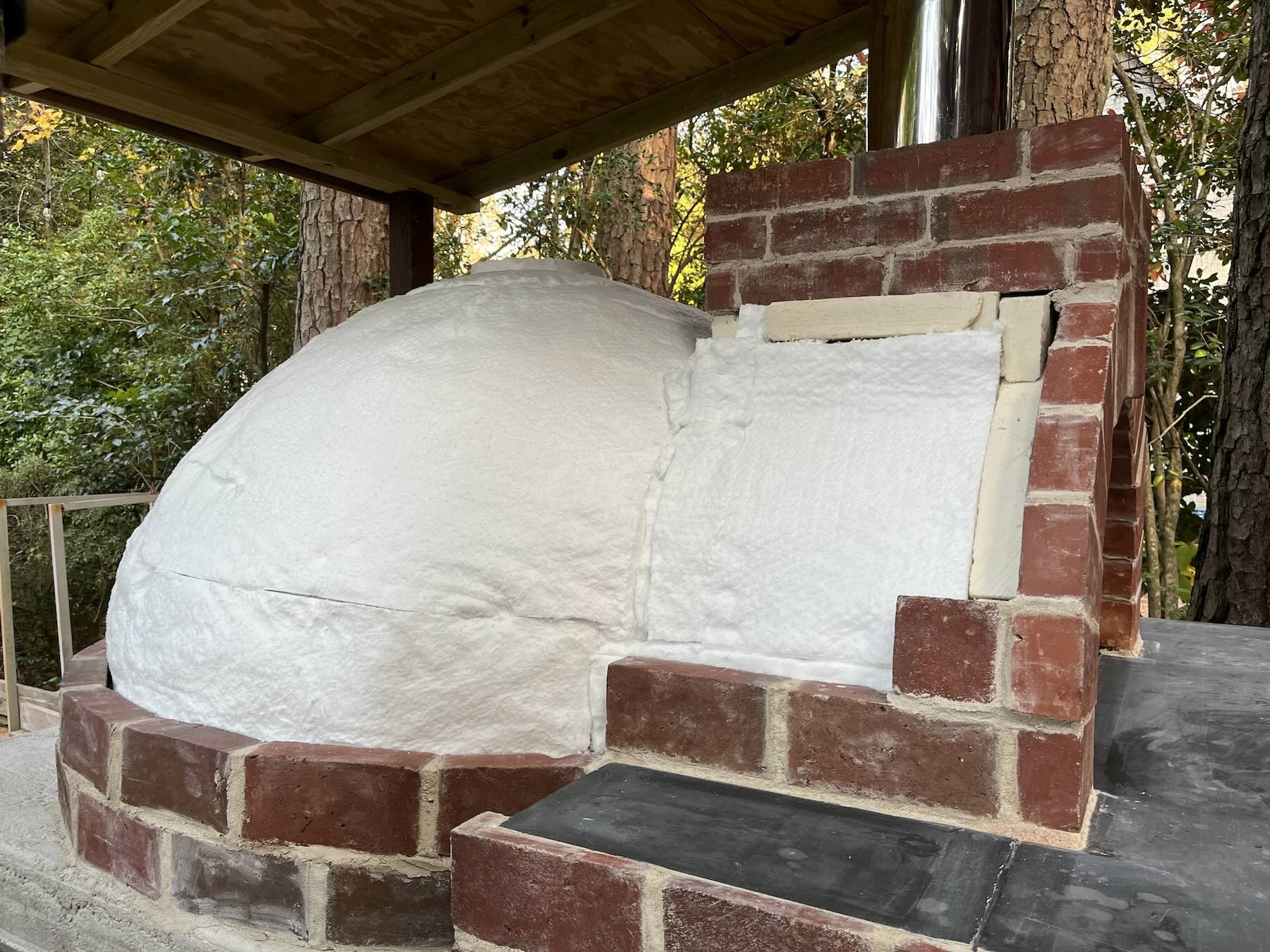

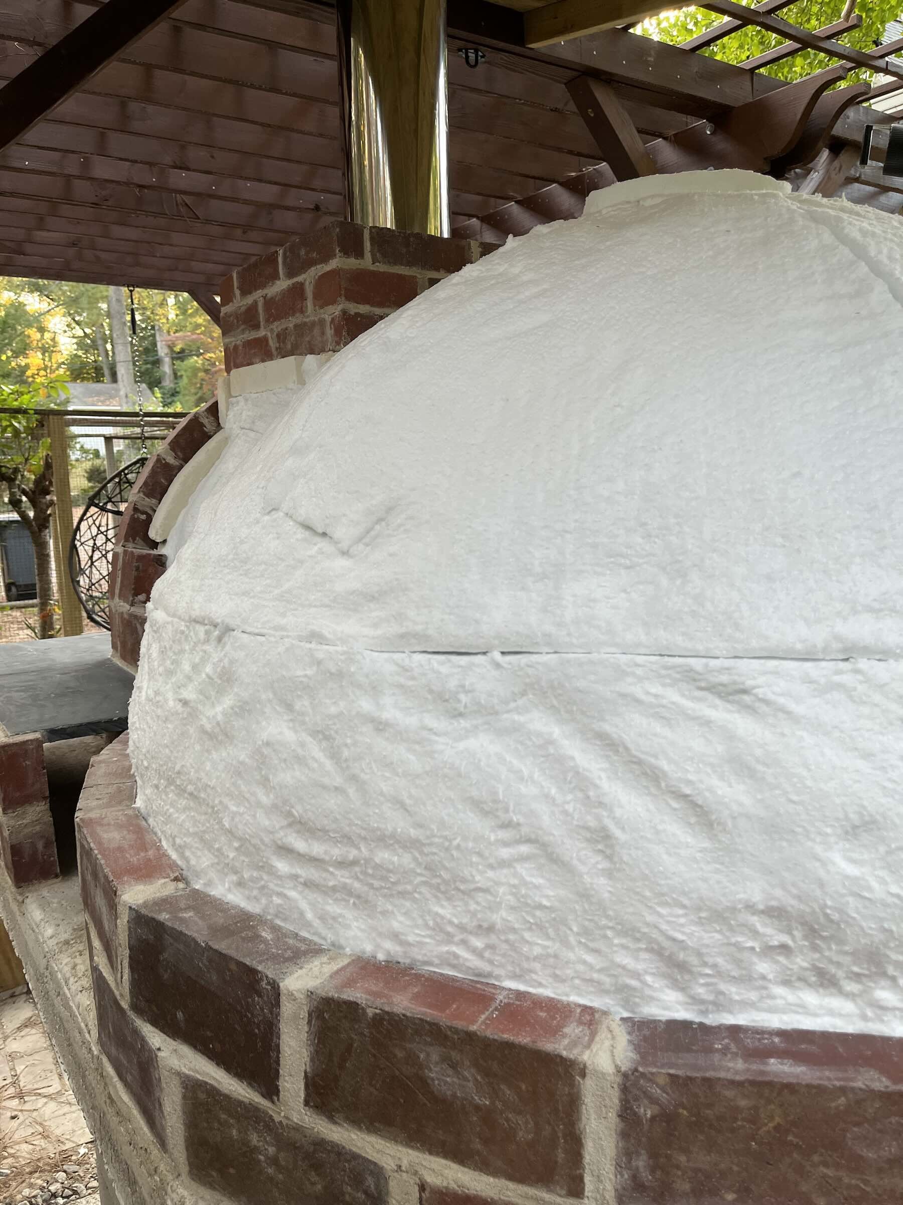

                        After some cleaning, and adding silicone caulk to the expansion joint between the vent arch and the front landing, it was time to start on the insulation.
                        In the planning stages, I had aimed for 4" of Superwool; I calculated this required 3 boxes worth. Those initial calculation may have been for a 39" oven -- I'm not sure. With a 36" oven, I had calculated that those 3 boxes would suffice for 5", so that's what I set out to do.
                        I used all the off-cuts for the top and edges of each layer, which helped prevent wastage. As it stands now, I have 3" inslulation (mostly superwool, but some CalSil) throughout, and 5" for the dome. I added an extra inch (making it 6" thee) for the top of the dome, since my dome height is close to 1" below where a true hemisphere would be.
                        On the whole, I found the Superwool pretty comfortable to build with. it wasn't too hard to keep the shape of the dome pretty smooth, and to fill in gaps with off-cuts.

                          • 9208
                          #117
                          It looks like you have a permanent roof over your oven in which case you won’t have any rain running down the outside of the pipe, so no real need to seal the collar against it. However if it’s all out in the weather then seal the collar against the flue pipe. I have a second collar sitting over the first one in my build and the imperfect fit becomes the escape for moisture and pressure.
                          You could also drill a few holes (carefully) through the sides of the collar that you can plug up when the oven is not in use.
                          Nice work with the blanket fitting by the way. Isn't Superwool a dream to work with?

                            #118
                            Yes, Superwool was really nice to work with. It made it quite easy to keep a nice round dome shape, so now I'm much less worried about the final shape. I also see why you feel chickenwire or some other lath is not really needed.
                            As for the collar: yes, I have a permanent roof, and the storm collar at the top of the chimney will prevent water from sliding down the pipe. But we do get rainstorms from time to time that have sufficient wind that rain will get in from the side. So I want to be prepared for that just in case.
