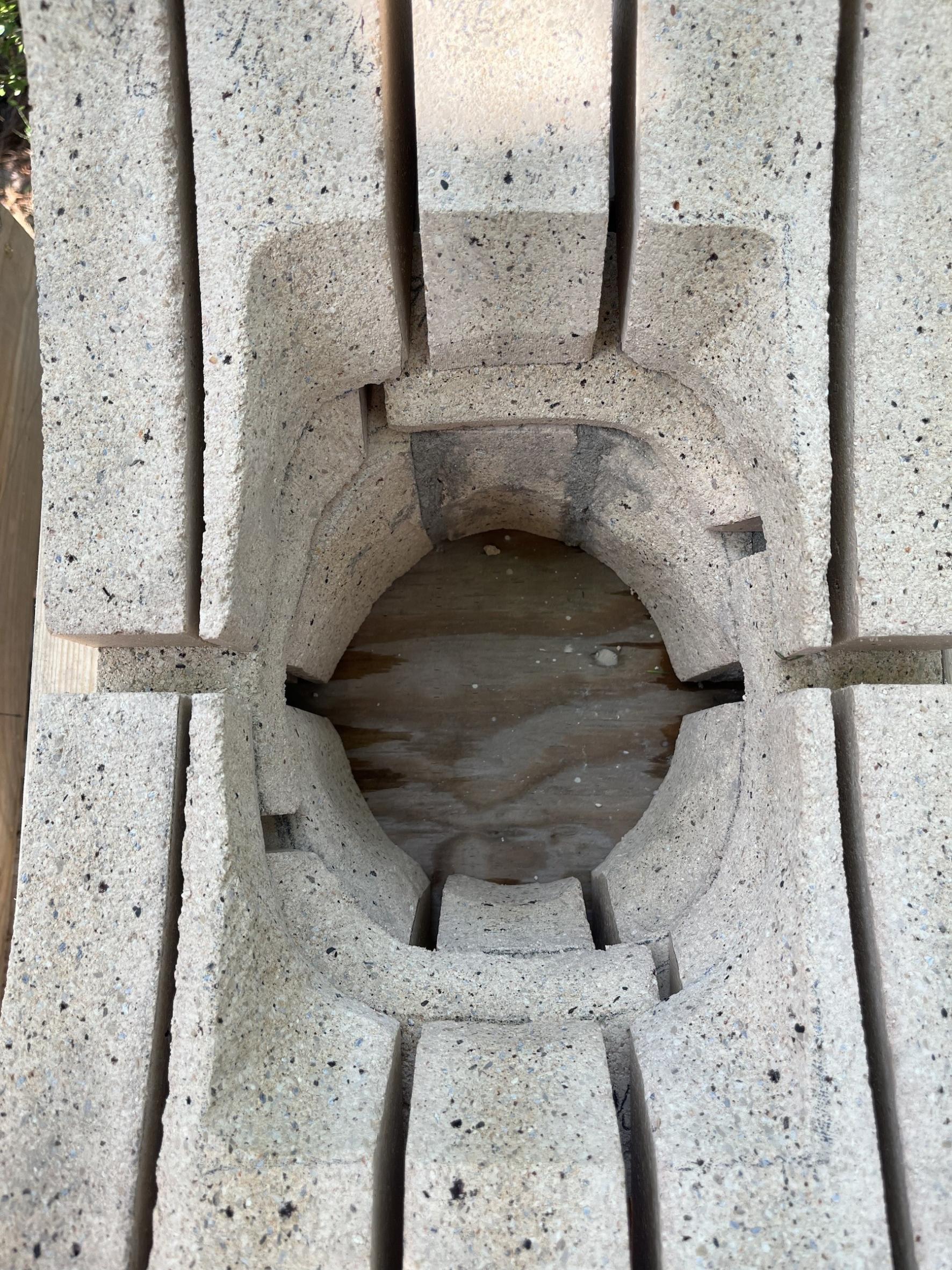

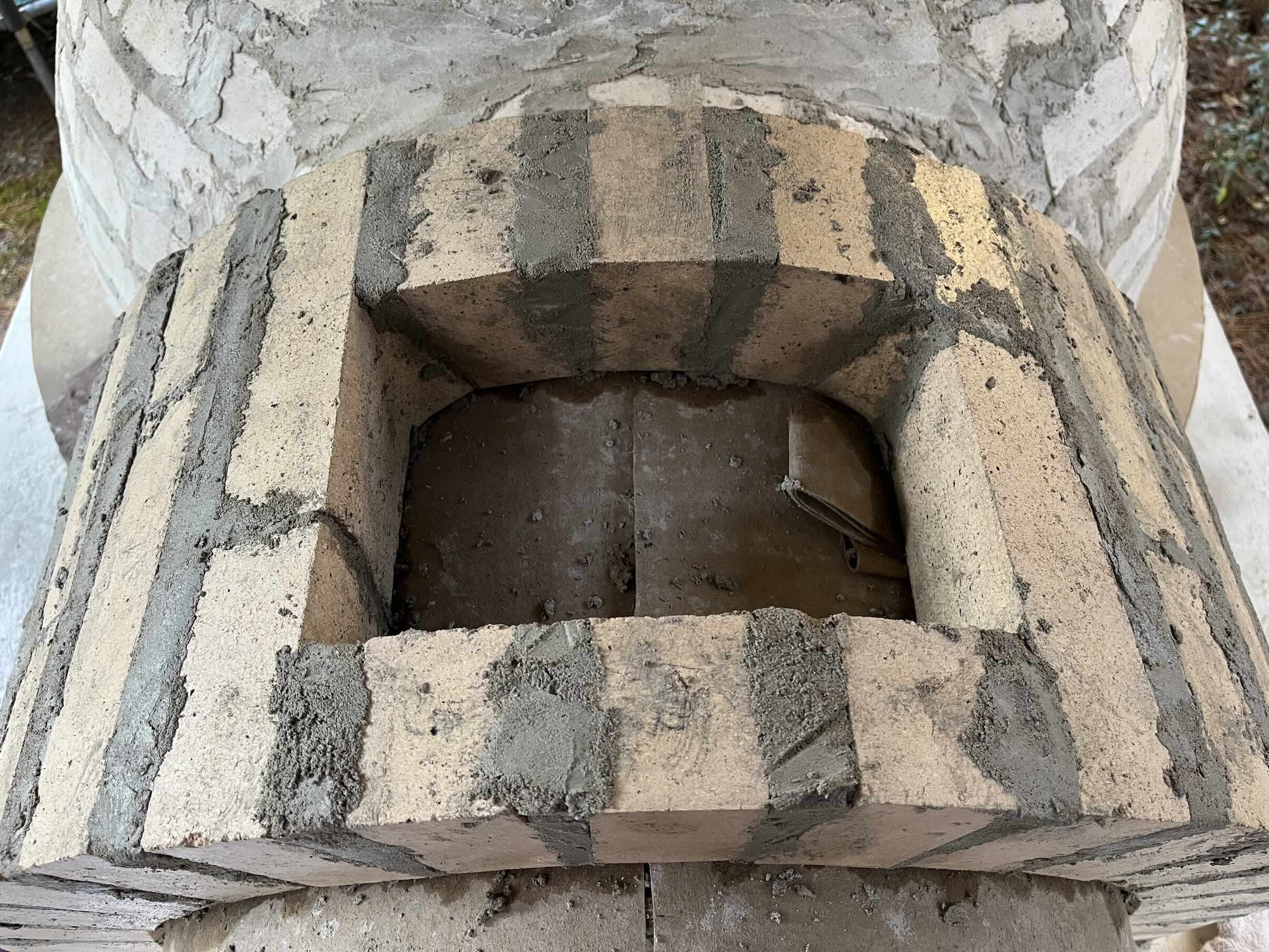

            With the dome closed, I spent the past 2 weeks thinking about how best to do the vent arch, calculating how deep it needs to be, how big the chimney hole should be, how much brick I want to have on either side, etc.
            The piece of slate I cut for the vent landing is 14" deep. In front of it will be a piece of slate that is the full width of the hearth slab; together they are sized to reach the front of the slab. This meant that I did not want to cut the vent landing shorter, even though once I decided to cut the chimney anchor plate, I was able to make the arch less deep.
            Fortunately, I have been planning to add a decorative arch to the front, so instead of putting that in front of the vent landing, I'm now going to put it right up to its front edge, making the actual vent arch a little more than 2" less deep than in the original design. This does mean I'll have to cut 2 small pieces of slate equal to the size of the reveal of the decorative arch, but that should be straightforward.
            So now I have a vent arch that is approx. 12" deep (about 11.75 actual arch, plus 0.25" expansion break). I put gasket rope on the top/outsides of the inner arch, with all the pieces that butt up against the inner arch L-shaped, overlapping with the inner arch about 1.25" (enough to cover the gasket rope).
            I wanted to have at least 2" of brick on all sides of the brick part of the chimney, and I wanted a relatively smooth taper to the actual chimney, which is 6" inner diameter. With a 12" deep arch, that means the front-to-back dimension of the opening is about 8". I dry-fit the arch to figure out which brick was the first to allow a taper that would make for a vertical opening. It was the 6th brick in the arch (7th overall, because there is 1 brick below where the actual arch starts). Tapering these bricks made for a left-to-right opening of about 10". The corners are rounded, but the initial opening is close to 80 square inches.
            Each of the bricks at the top of the arch starts 2" wide and finishes 2.5" wide. That means the front-to-back opening is down to about 7" at the top of the arch. Left-to-right is still about 10", because I didn't want to make the bottom of those bricks too thin, so that part of the opening is basically vertical.
            The picture shows the opening as it currently looks.

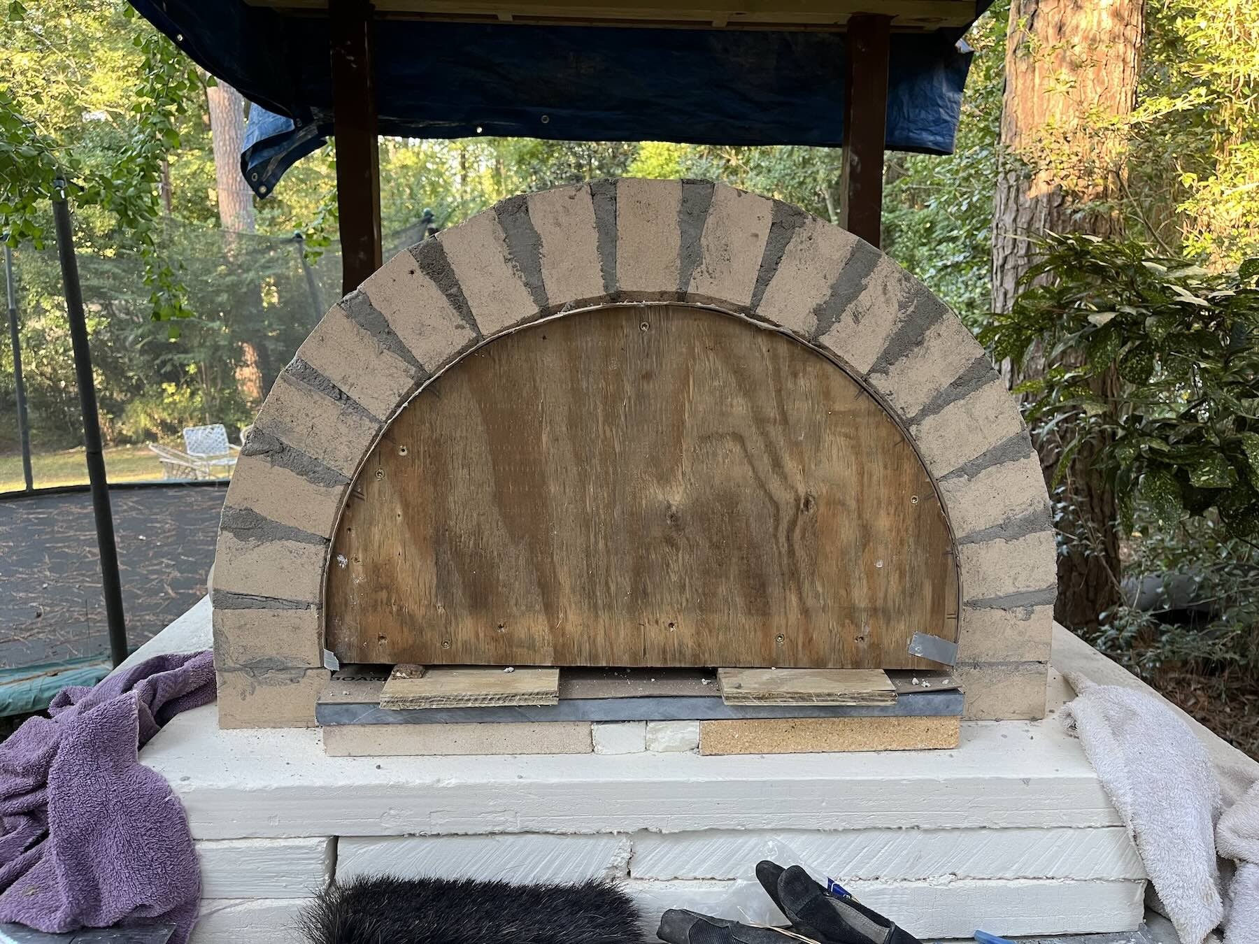

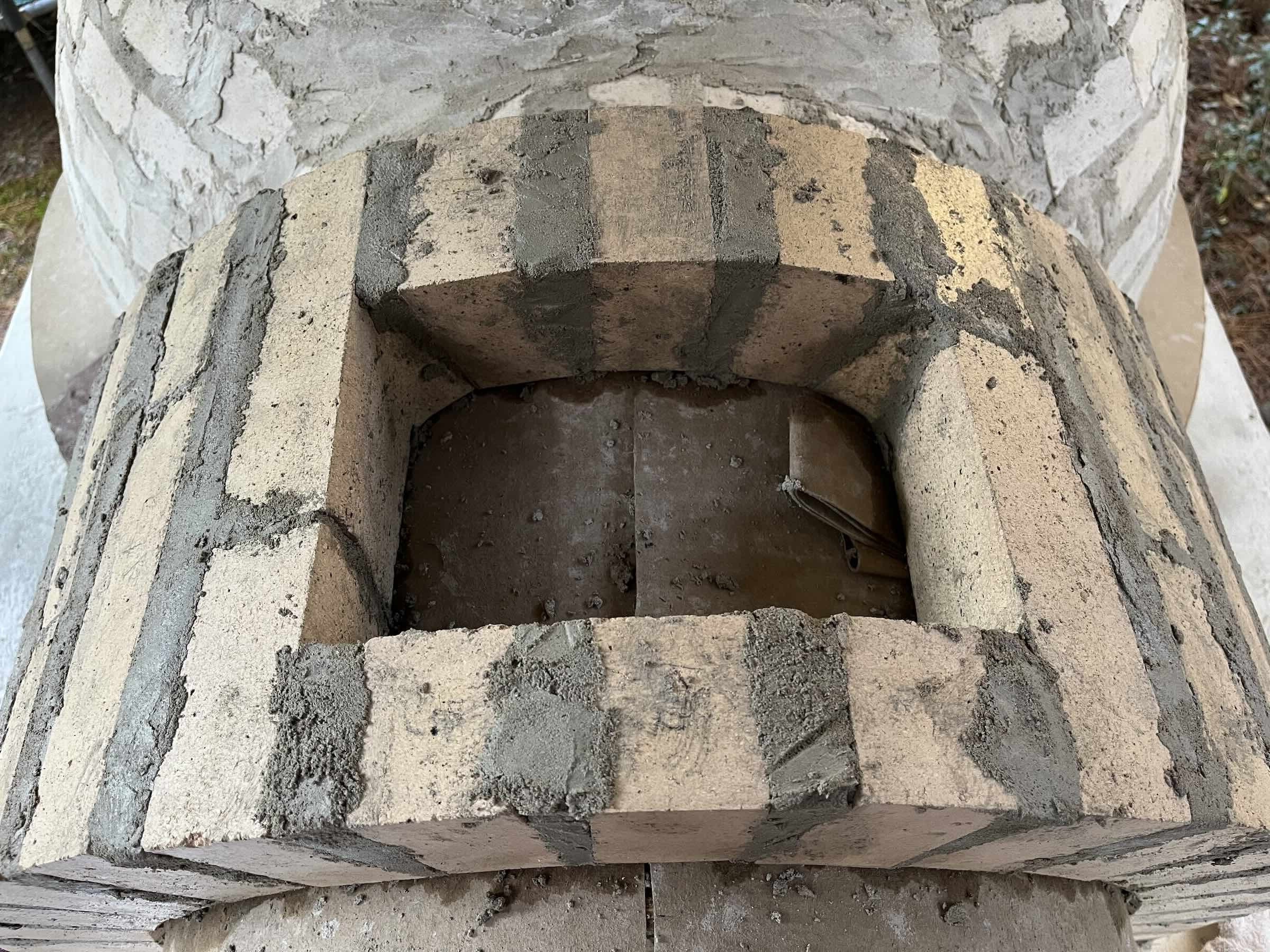

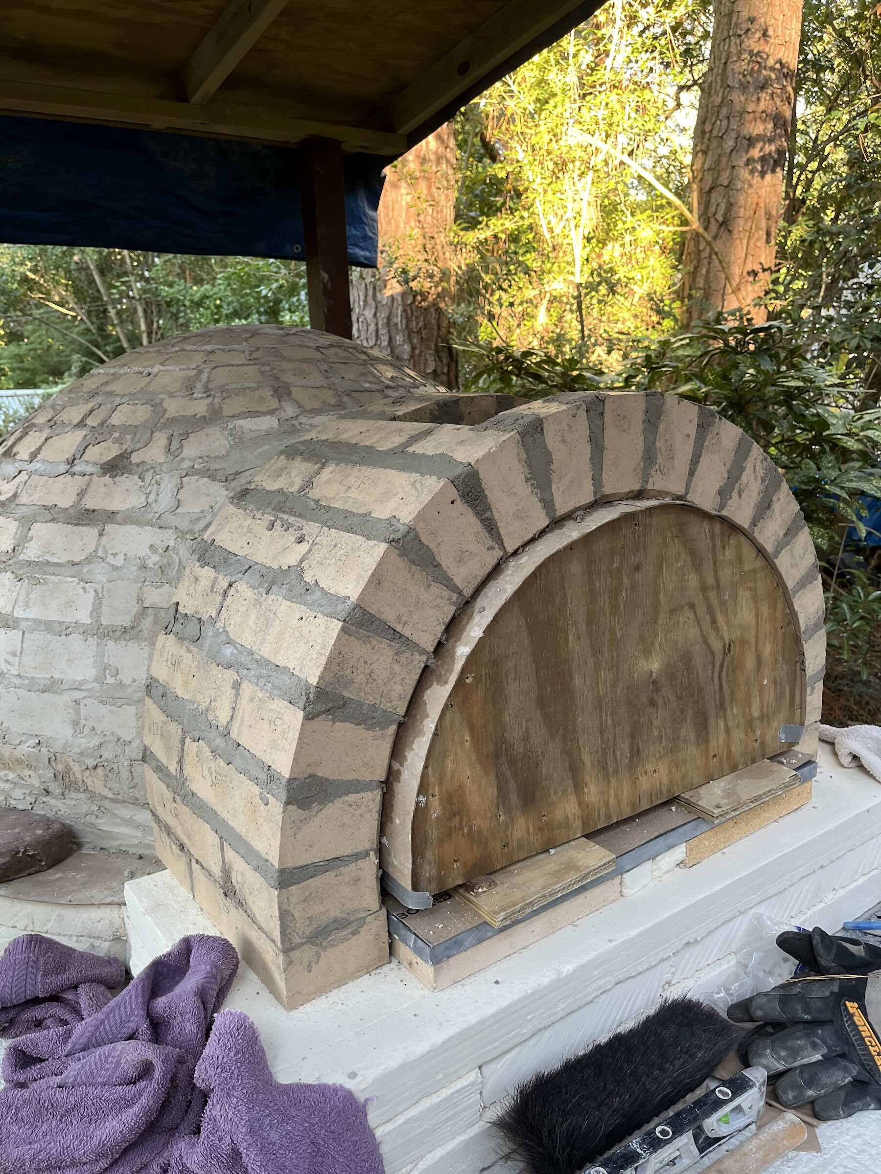

              In the end, the vent arch was an easier build than the inner arch, both because I now have more experience and because I dry-fitted it beforehand to measure what the cuts at the top needed to be like. It did take more mortar than I had anticipated, so I had to mix an extra batch, but other than that it went pretty smoothly.
              I did forget to put plastic wrap over the arch form, which david s had suggested. Hoping that the ram board covering the form won't stick too badly to the arch. At least I do have the half inch pieces that raise the form, so hopefully that'll make the removal a bit easier.
              On the first picture, you can see that the landing sticks out in front of the arch. This is where the decorative arch will go (see previous post).
Name:	Vent arch side.jpg
ID:	461617 Click image for larger version
Name:	Vent arch front.jpg

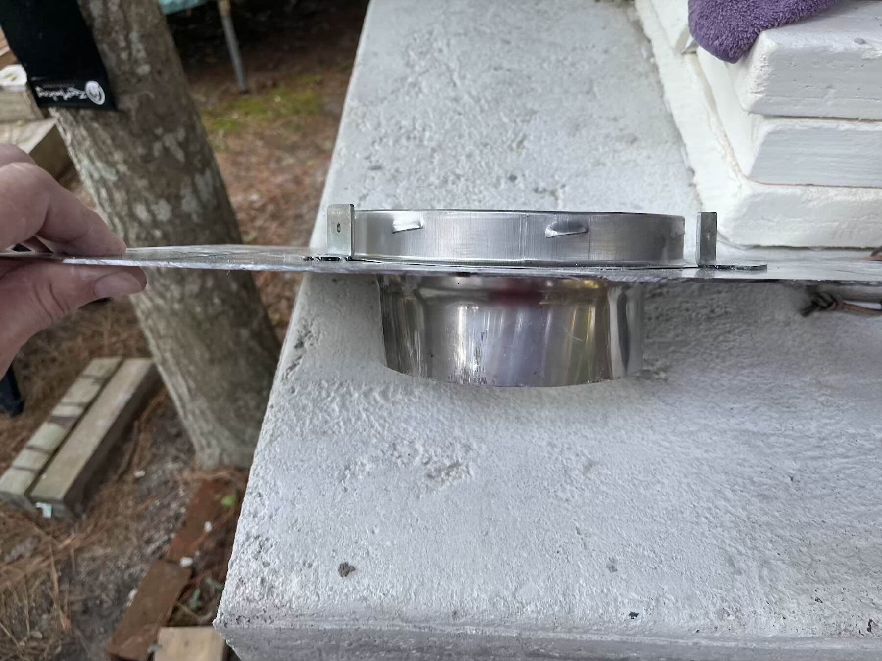

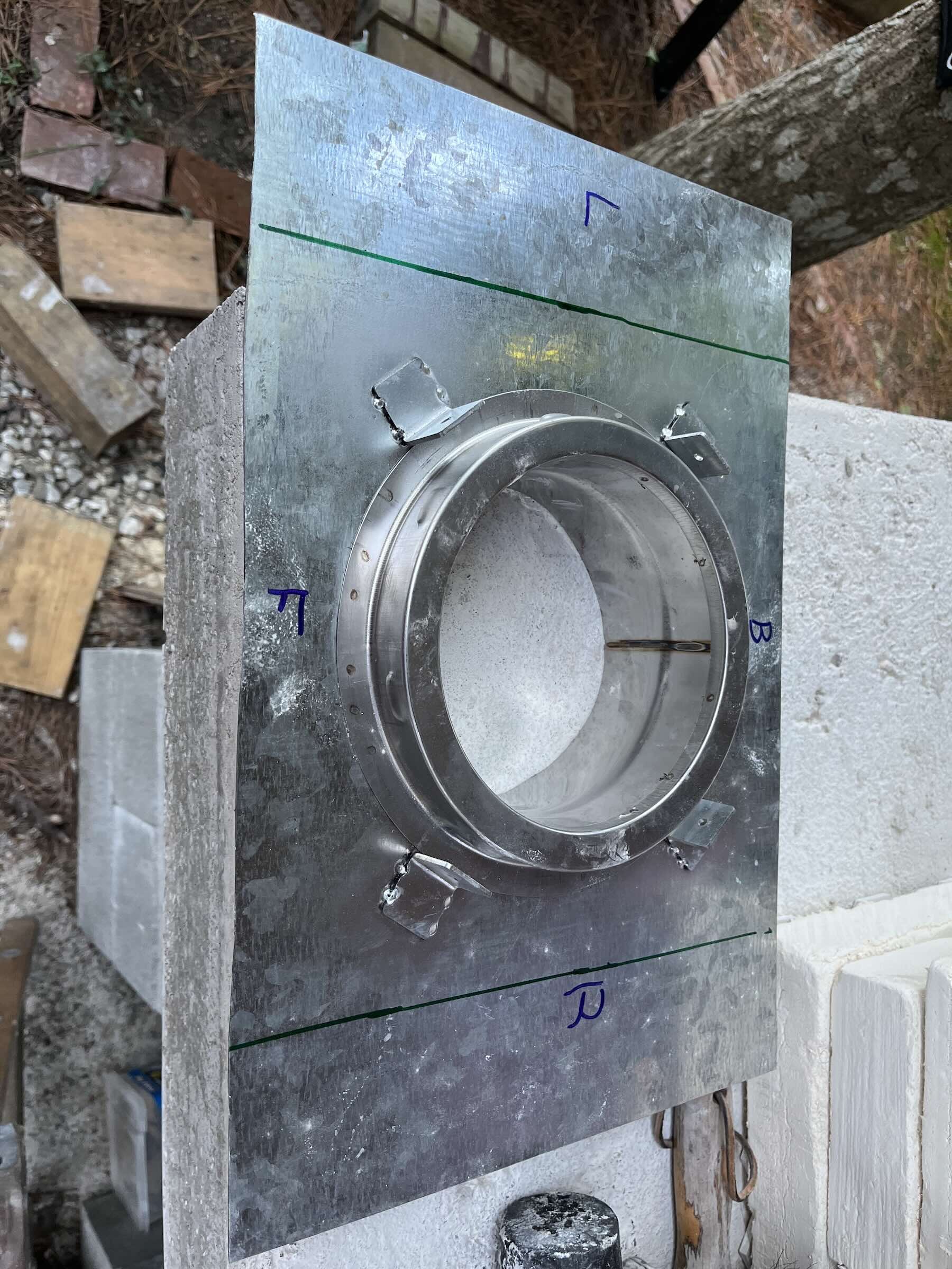

                With the arch drying, I've turned to the chimney transition. It needs to be higher than some of the other set-ups I've seen because the Shasta anchor plate sticks out a ways below the mounting plate. This will help prevent any lateral movement of the chimney, so I'm less worried about cutting it down smaller than the initial 14"x17" size, which removed the holes for mounting screws (tapcons).
                The first picture shows the part that extends below the plate. The top level of the chimney transition will narrow to closely fit around this part, with any gaps sealed using high-temp silicone (the same stuff I am using in the expansion break between the dome and the vent arch).
                I already cut down the plate to be less deep front-to-back, but I'm also going to cut the sides to make it roughly square. This will allow for a smaller footprint of the top transition layer, and thus less weight on the arch.
Name:	Anchor plate side.jpg
ID:	461620 Click image for larger version
Name:	Anchor plate top.jpg

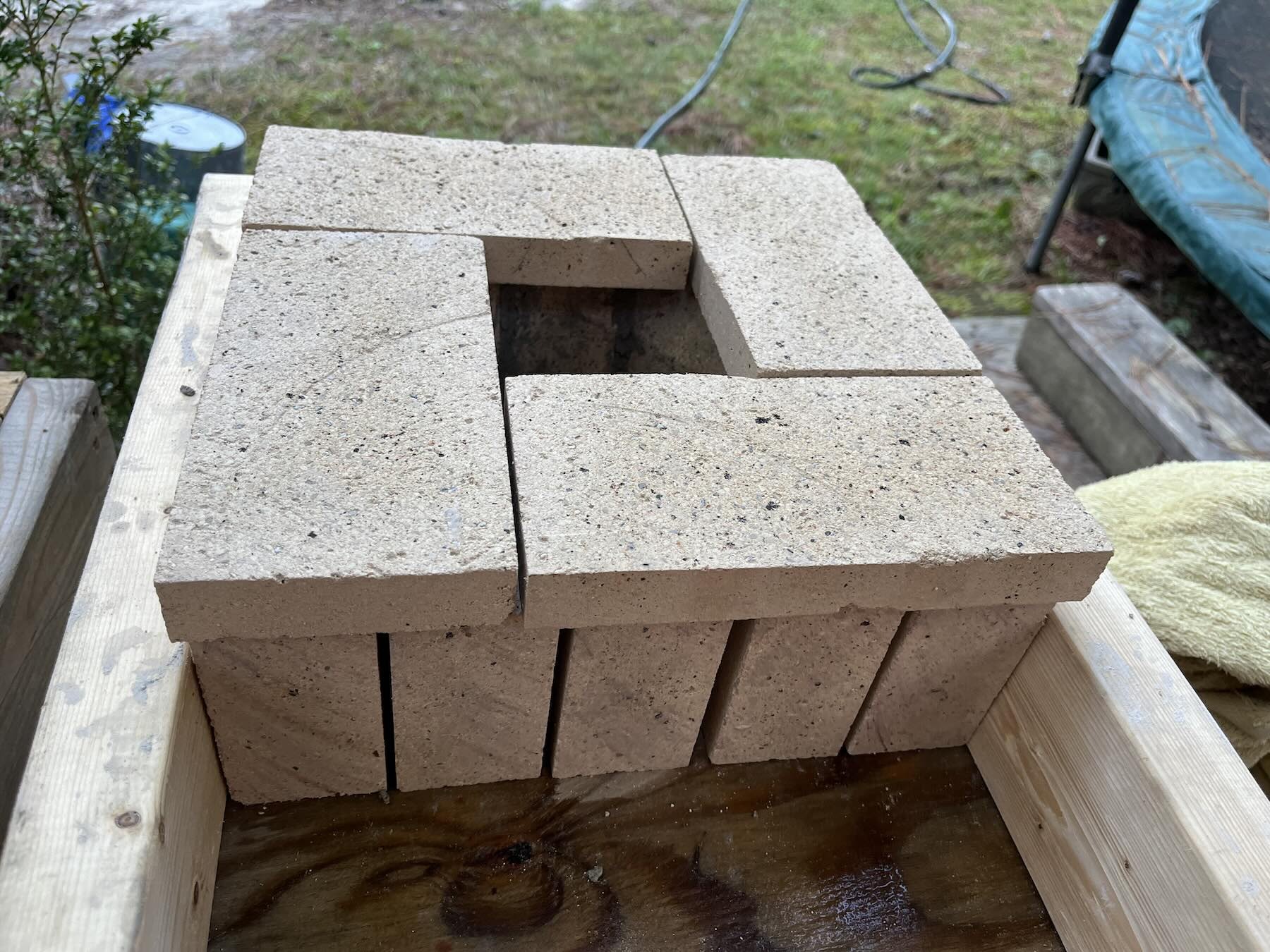

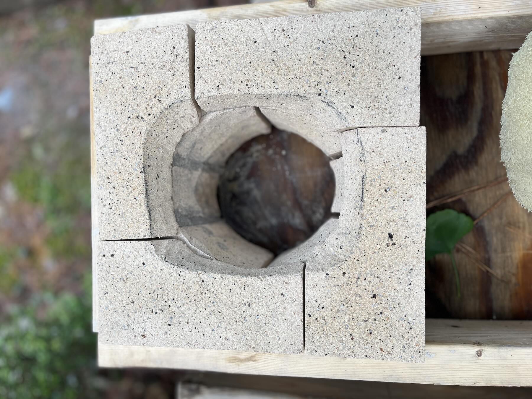

                  #83

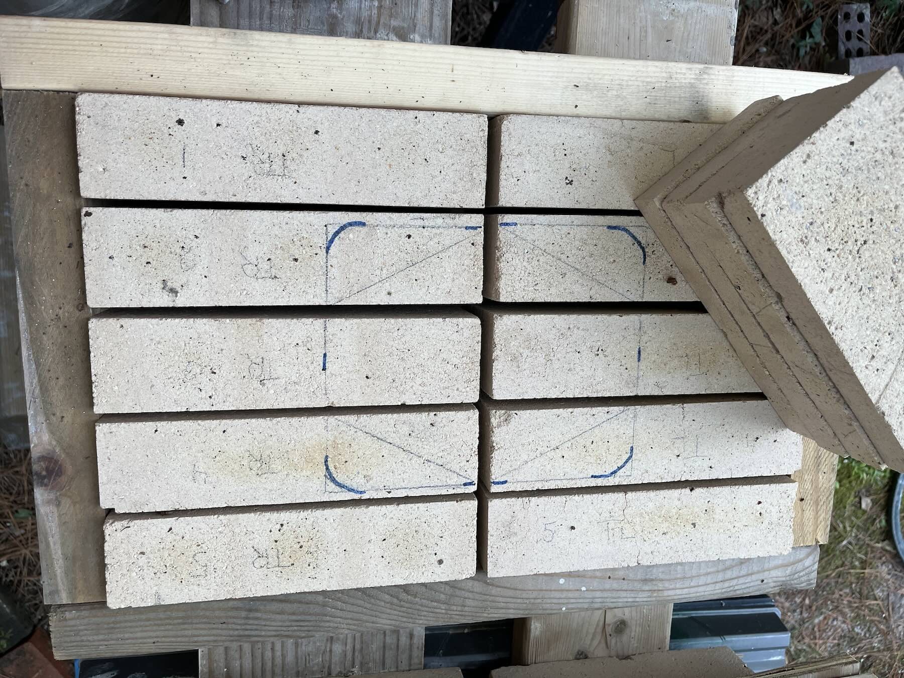

                  I've ground the the top layer of the chimney transition so that the top part fits around the anchor plate, while the bottom part widens down to the next layer.
                  The middle layer is half-height bricks horizontally, both to make sure there are no joints that line up between successive layers and to provide a little more height for the gradual tapering from the initial arch opening up to the 6" pipe diameter.
                  The bottom layer will be curved to fit the arch.
                  The top and bottom layers will be mortared together in halves, so they're easier to place. The middle layer will be put in place in individual pieces, which will make it possible to correct for any inadvertent non-level placing of the bottom
Name:	Chimney top layer.jpg
ID:	461623 Click image for larger version
Name:	Chimney middle layer.jpg
ID:	461624 Click image for larger version
Name:	Chimney bottom layer.jpg

                    I've now cut & ground the bottom and middle layers of the tapered chimney throat/transition. That was a lot of angle grinding to do, especially for the layer that sits on the arch, but I'm pretty satisfied with how it turned out. Once the pieces have been mortared together, I'm going to do some light touch-up grinding to make sure all the joints & transitions between bricks are smooth. I want to do as much of that as possible _before_ placing the pieces on the vent arch, because I don't really want to have to smooth anything out once it's installed.
Name:	Throat bottom layer.jpg
ID:	461668 Click image for larger version
Name:	Throat middle & top layer.jpg
                    Meanwhile, I have some questions about insulating this part of the build and about the possible need of an expansion joint. I would love any input from those with more experience than I!
                    My plan is to have a decorative arch of normal bricks (i.e. not firebricks), with about a 2" reveal. The bricks will be on their side, adding about 2.5 inches to the depth of the entry. I'm going to mortar them to the front of the vent arch (for stability) and rest them on the landing.
                    Question 1: I can mortar them to the landing, or I can use high temp silicone (same stuff as the heat break/expansion joint at the inner arch). Which is better?
                    The reason for the silicone would be that it would allow a little bit of movement relative to the outer landing, in case the vent arch expands due to heat and pushes against the decorative arch. However, there would be a lot of weight on that silicone, and I'm not sure how well that would work. Also, do I use the homebrew mortar formula I used for the dome, or should this be regular mortar (say 6:1:1, i.e. type N)?
                    Question 2: As currently designed, the chimney transition is the full depth of the vent arch. This means this part will also butt up against decorative arch. My guess is that this part will get hotter than the vent arch itself. If it makes a difference, I could mortar the decorative arch only to the 2" overlap with the vent arch here, and stuff the remainder of the joint gap with compressed insulation blanket and/or the high temp silicone. Is that worth doing?
                    Question 3: Relatedly, I can also easily cut off 1" off the front of the chimney transition section. I could stuff the resulting gap with 1" of blanket or, if I want some extra rigidity, with 1" of the CalSil board. On the other hand, this makes the chimney wall at the front much thinner (would be just 1.5" thick or so for about 2" of its height, before it tapers further inward). Is this worth doing?
                    At the moment, I'm leaning towards mortaring all around (arch to landing, and arch to chimney transition), for more structural strength. But if people feel that either the added insulation or some joint flexibility are important to have, I can readily be convinced :-).

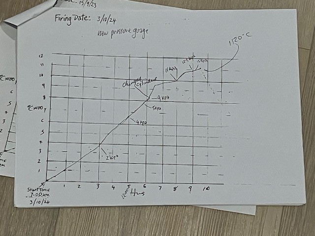

                          It’s the total amount of thermal mass in your oven and gallery that is directly proportional to the amount of fuel required to reach a given temperature and exponentially, the higher the temperature, the greater the heat loss.
                          Also the more insulation you have the slower the heat loss. Some say you can never have too much insulation, but there comes a point where added insulation adds virtually nothing (law of diminishing returns) and cost plays a factor here.
                          Although the gallery will always be cooler than the dome, it too should be insulated on the outside.
                          As an example to explain some of this, I just fired my kiln today and the attached firing schedule shows temperature increase with gas pressure changes. It took 6.5 hrs to reach 1120C consuming 13kgs gas.
                          Click image for larger version  Name:	image_101538.jpg Views:	3 Size:	80.1 KB ID:	461682

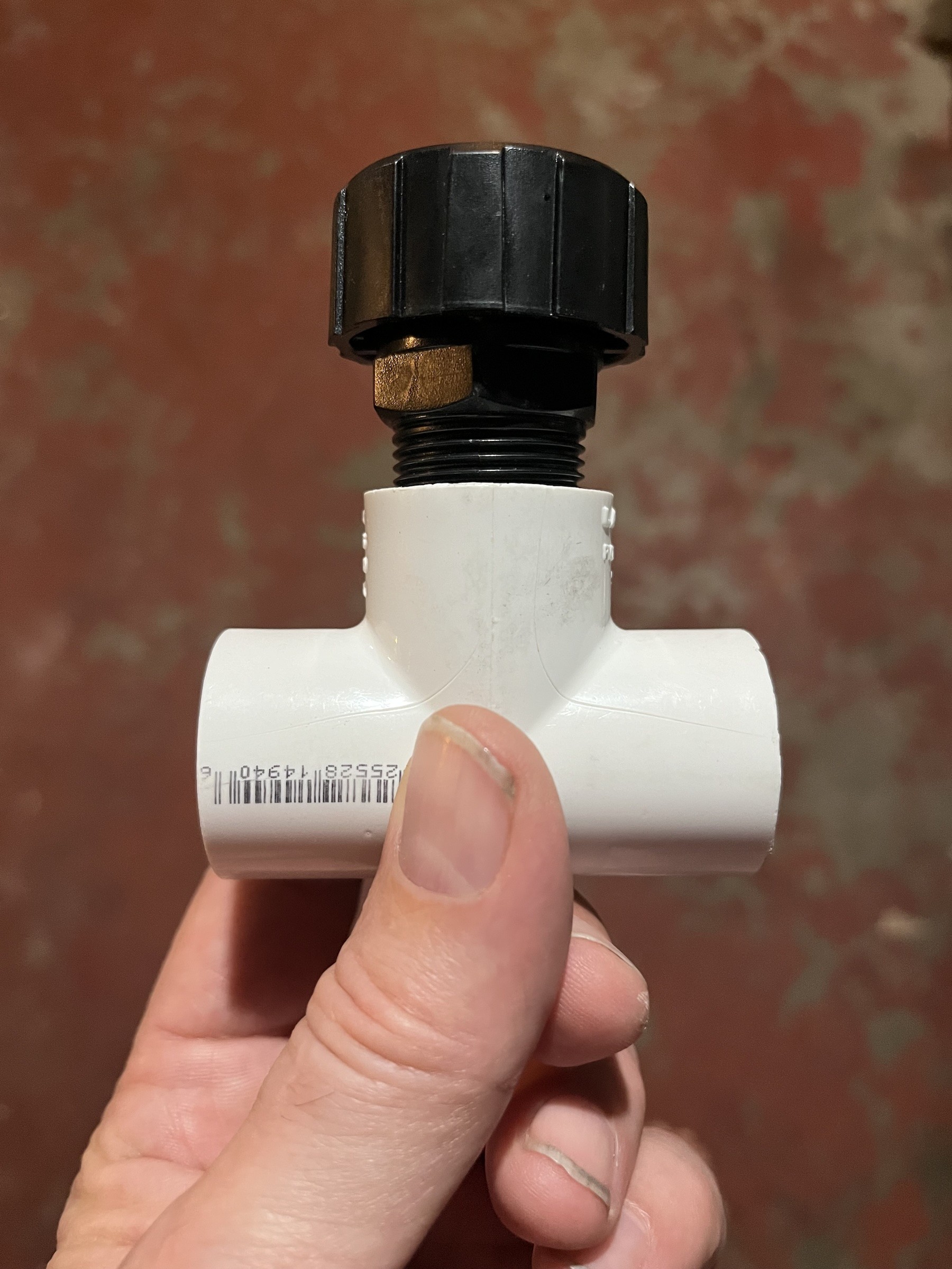

                              I bought a breather valve online, and thought it might work well with a T junction both to extend it a bit deeper and to hold it in place. This is what it looks like:
Name:	Breather valve.jpg
                              The idea is that steam pressure would be able to enter from the sides, and the top of the T would be right up against the inside edge of the vermicrete/render layers.
                              Three questions:
                              1. does this seem like it should work?
                              2. would it make sense to drill some additional holes on the sides (i.e. the side facing forward in the picture, and the side facing rear), so steam pressure can also enter that way?
                              3. how much pressure is the steam likely to exert on the breather valve? Can I just screw it in, or should I epoxy it in place so it doesn't unscrew itself and pop off?

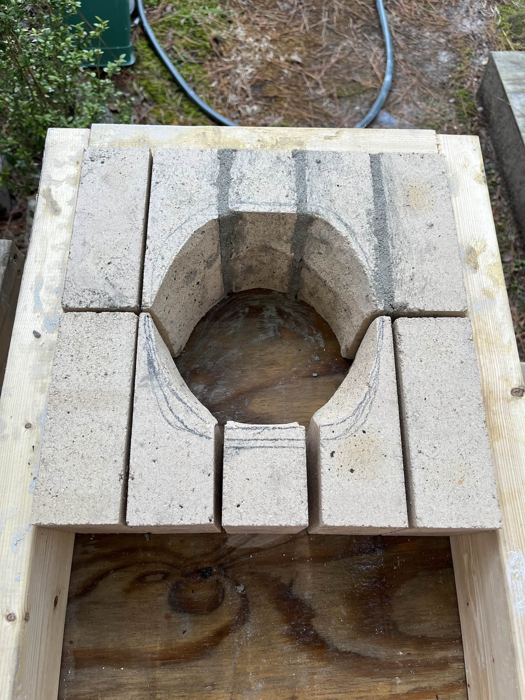

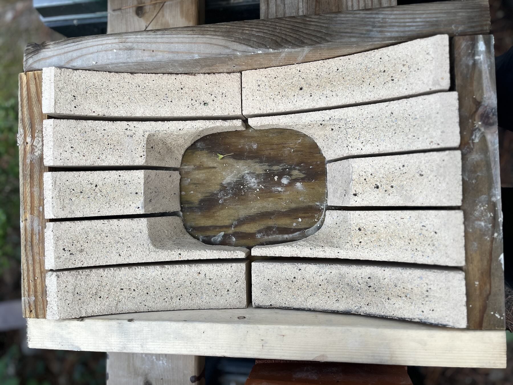

                                I mortared the individual chimney transition layers together today, after verifying that they all fit together well.
Name:	Chimney transition pre.jpg
                                It may be a bit hard to see on the picture, but this is what the 3 layers would look like from below, as they will be place on the arch. The transitions are all pretty smooth. After I mortar them in place on top of the arch, I will add a little mortar to smooth any transitions as needed.
