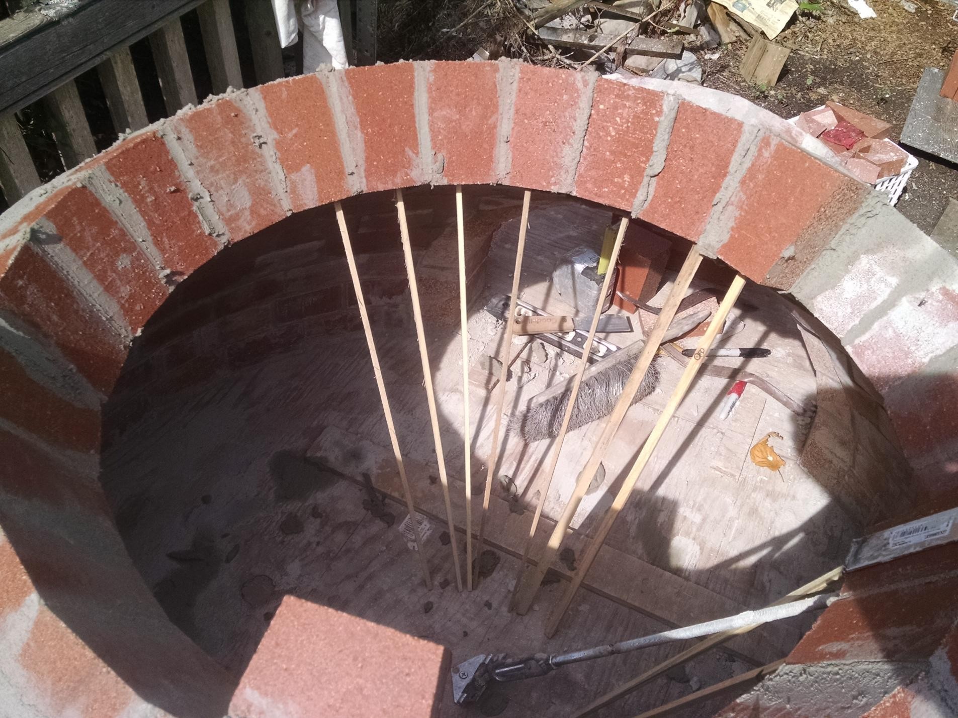

                    When I got to the higher courses I found it useful to use some thin pieces of wood as brick props. They didn't really carry much weight, they just prevented brick creep.

                      Another technique for stubborn bricks in the final courses is to make a hook out of some heavy wire (e.g. a coat hangar), connect with a string to some kind of weight (e.g. a brick fragment) and hang that on the troublesome brick. I apparently didn't take pictures when I did this on my oven, but searching the forum for "hook" turned up a picture from this build that gives the idea (looks like that builder tied off the string somewhere, but just attaching to a brick is way simpler): https://community.fornobravo.com/for...883#post410883

                        Thanks for the suggestions on how to prevent bricks from sagging down!! I have a few thin cut branches that I plan to start using, though since they're thicker than what Mongo's picture shows, I worry a bit they may tend to slip on the floor. The hook idea sounds promising too; I'll see what ends up working best.

                          I thought I had more photos of my supports, but this is all I could find. I usually had cardboard protecting my floor. Most of the time it was wet so the bottoms of the sticks didn't slide. However, the tops would tend to slide on the smooth brick surface. I would rest a piece of brick against the stick and that would give just enough pressure to hold it in place. This became less of a problem as I built higher. But, at the top of the dome I was concerned about needing lateral pressure to snug the bricks against the last course. A few craft sticks did the trick.

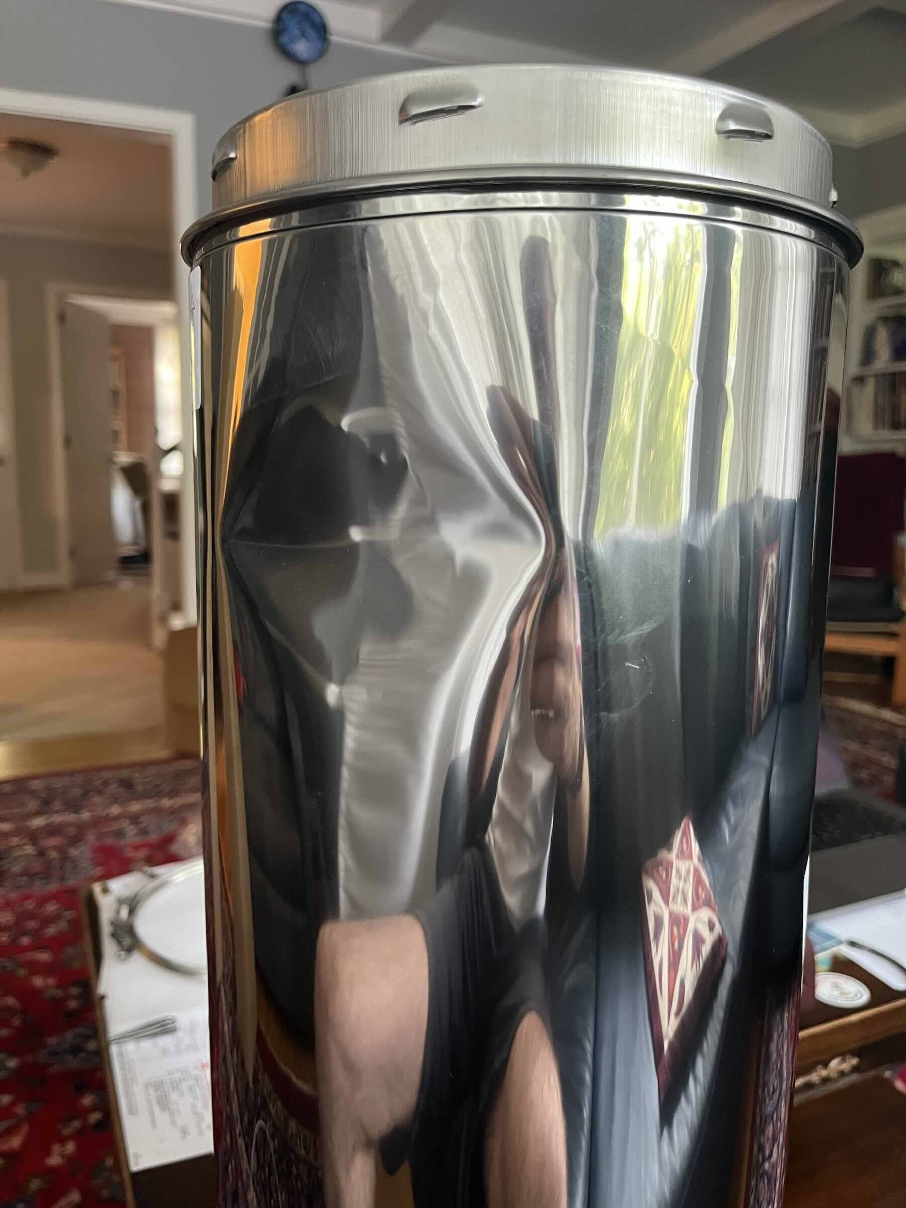

                              Another question: my chimney pieces arrived today, and one of them is dented (see picture). I can put this piece (I have two equal-size pieces), at the top, which will be above the roof, so it will not be particularly visible to the casual observer. These are 6" inner diameter, double-wall, stainless steel chimney pieces (Shasta Vent).
                              As I see it, I have 3 options:
                              1. Just leave as is. I'm not that concerned with the cosmetic imperfection, as long as the thinner insulation at the dent location is not an issue.
                              2. Using some kind of suction cup, try to un-dent it. This will be prettier cosmetically, but presumably will create an air void inside the double wall; is that an issue? And how likely is it that using a suction cup will even work?
                              3. Send back to the seller, asking for an undented piece. This is extra work for everyone involved (i.e. me, the seller, and the shipper), with dubious benefits. Is having an undented chimney worth that extra work? And what do I do if the replacement is also dented?
                              Any suggestions would be much appreciated!!

                                Because the dent is near the end of the pipe it should be fairly easy to knock most of it back into shape. Place the dented part to the rear where it will be less visible.
