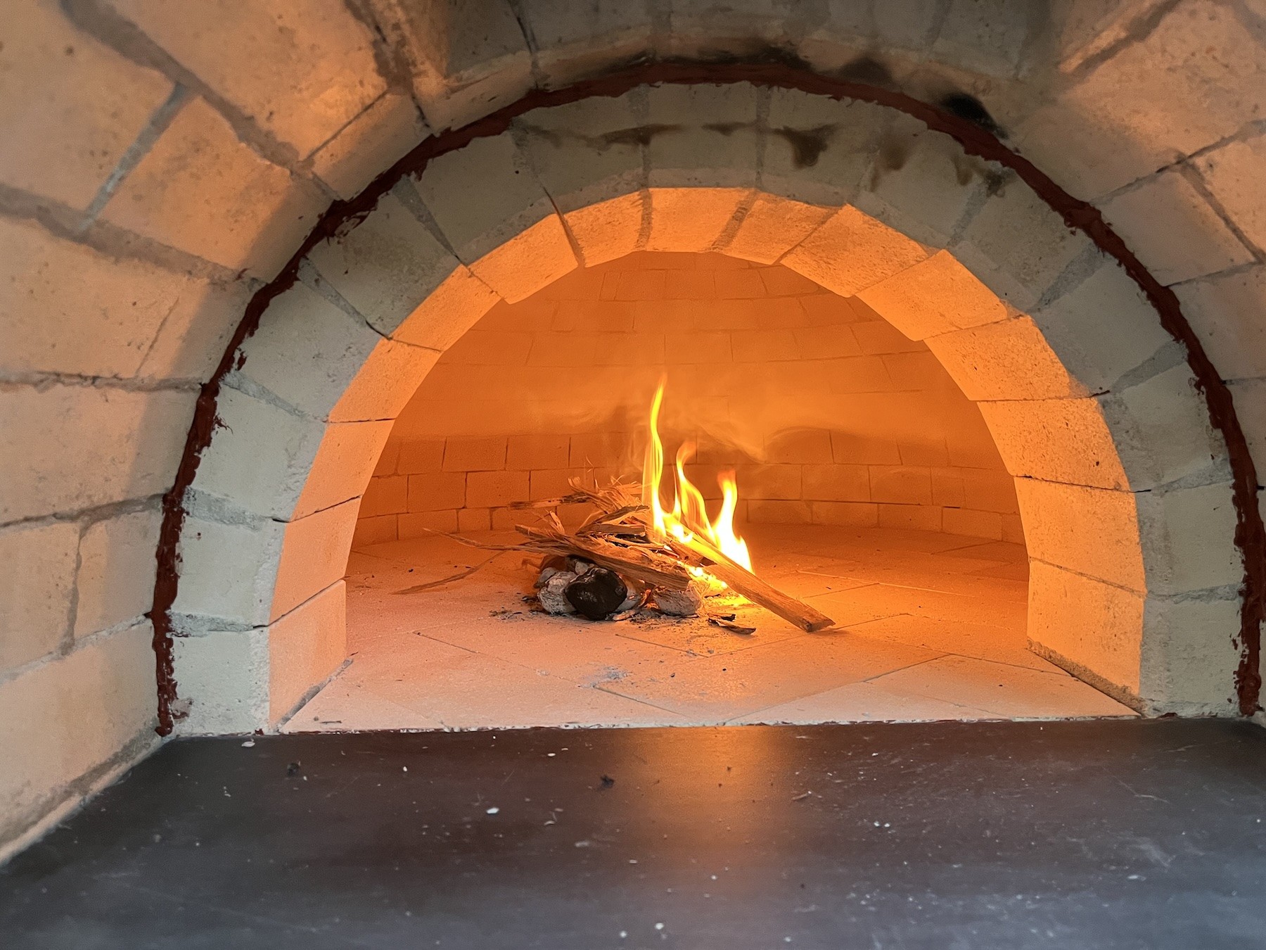

                Update on the drying fires: I think I'm being sufficiently careful (perhaps even too careful) about not going too fast. Day 1 I tried with just a few half-burned out briquettes that were left over from grilling, and that raised the dome's temperature maybe up to 100F -- a temperature not far over what the dome has already seen as the outside temperature this past August.
                Yesterday (day 2), the dome got up to close to 250F for a very brief moment, but hovered closer to 200F for maybe an hour.
                Today I've got it at between 250F and 300F for probably close to 2 hours. Tomorrow I may get a little more ambitious and get a larger fire I can spread more widely around. The fires today and yesterday just sat on a very small part of the oven floor, and their heat did not extend out very much laterally. The bottom of the dome all around was maybe close to 100F only. The hottest temps I've measured, by far, are right after moving the fire to a new location, on the bricks where it was sitting (500-600F), but again that is very localized.
                • nlinva
                  • Apr 2021
                  • 100
                  #128
                  Forgot to mention that the chimney draws very nicely, so that I see very satisfying smoke patterns that stay in the top half of the dome, flow straight into the flue & don't make it out the front of the oven.

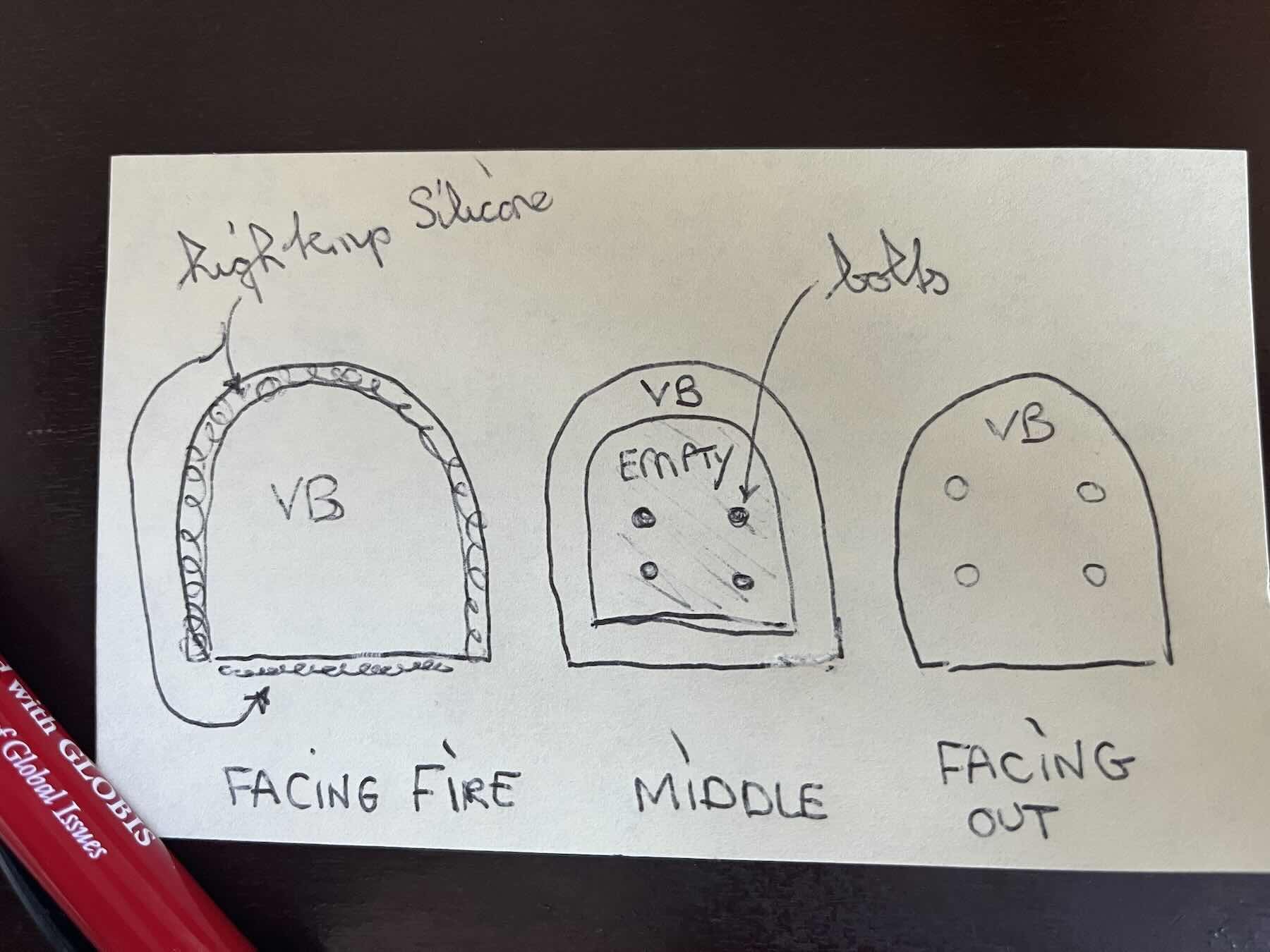

                    Current door thoughts:
                    I can get some vermiculite board, and cut it to shape. I could make it 2 layers, plus a mostly "empty" middle layer. The layer facing the fire would have the high-temp silicone on the face along the outer edges to ensure a good seal, as well as on the bottom, for a bottom seal. The mostly empty layer would provide some additional insulation (like a double window: the air inside would not circulate), plus it would provide space for the endpoints of bolts connecting the insulating material to the outside front of the door, which would be wood. That way the bolts would not be directly exposed to the fire in the oven, and conduct less heat through to the wood.
                    In case that's unclear, maybe this quick-and-dirty sketch helps (VB stands for vermiculite board in the sketch)

                    The 3 layers of vermiculite board could be attached together with a special "board adhesive" sold by Vitcas which is supposed to be for precisely this kind of thing. The layer that faces out would, then, be connected to the wood face of the door with both a bead of the high-temp silicone and 4 bolts, which would connect into 2 handles. I think I'd want to put silicone washers between the wood and the layer of vermiculite so that the bolts don't bend the board towards the wood.
                    The vermiculite board is 1.25" thick, so 3 layers would add up to 3.75", plus maybe about an inch for the wood front. The weight of the vermiculite would be about 16.5lbs, plus a couple more pounds for wood and bolts, so I imagine it'd end up around 20lbs. Heavy but doable. One question is whether the board adhesive is strong enough to hold the layers together (I worry about the shear resistance of the connection).
                    In addition, I hope to put rollers on the wood face, along the bottom right near the floor, so I can tilt the door back towards the entrance and roll it in and out rather than trying to lift it smoothly without touching any of the sides.
                    The big river store has all kinds of steel rollers that would do nicely, but they all seem to have galvanized end caps. Since I'm not interested in being poisoned by zinc, a question is whether the temperature on the outside of this door might get high enough to be a problem. Perhaps a better solution would be to simply use a couple of cylindrical stainless steel spacers on a bolt, and then mount the bolt along the bottom of the door. Not entirely sure how that would be done, but maybe someone here has a good idea?
                    Anyway, does this sound like a feasible idea? I think for the short run I may still build something simpler with leftover blanket and maybe a thin sheet of steel from the big orange store, but as a longer-term solution, this feels like it might work.
                      • 9208
                      #130
                      Best way is to build it and try it out.
                      There’s a reason oven manufacturers do not offer insulated doors. Many of the suitable materials are either not food safe, not strong enough, too heavy or too conductive. I’ve settled on a one inch reinforced vermicrete panel that I cast in two layers, which is attached to a 1” quality timber (Quilla) facing with 5/16” (thin to reduce conductive heat transfer) stainless bolts and washers. The facing and insulating panel are separated by beads of high temp silicone to reduce conduction. While the door is light enough to use one handed and the insulating panel sufficient to hold back baking and roasting temperatures for a few hours, it cannot be used to hold back pizza temperatures overnight in an effort to use the oven to roast or bake the next morning.
