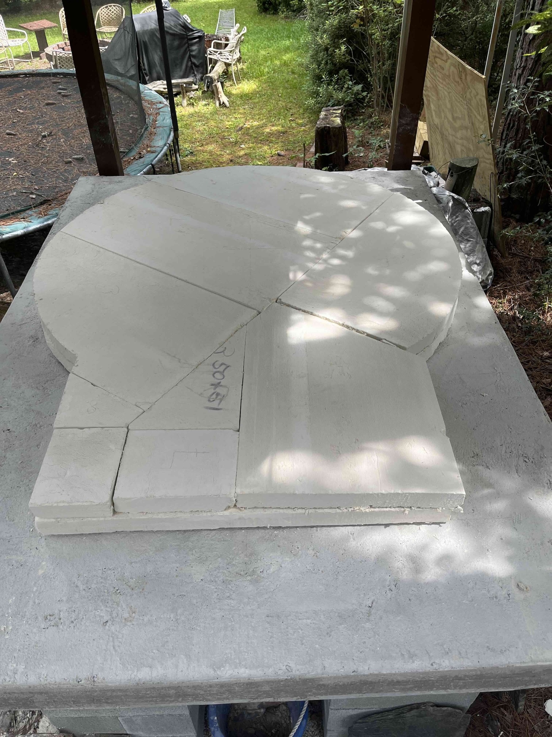

    The Thermo1200 stuff is reasonably even, thickness-wise, but there are some thinner sections, and one of the boards was noticeably thinner than the others, by a couple of mm. Fortunately I had spares, so I managed to get them cut and shaped well enough. Some unevenness remained, but that was solvable with some sand to create a level surface for the floor bricks.
    I didn't much like the idea of having bricks resting right on the edge of the insulation, so I cut it to extend 4" beyond the oven walls. I plan to have 4" of the superwool insulation around the dome, so that should come right to the edge of the Thermo1200 boards.

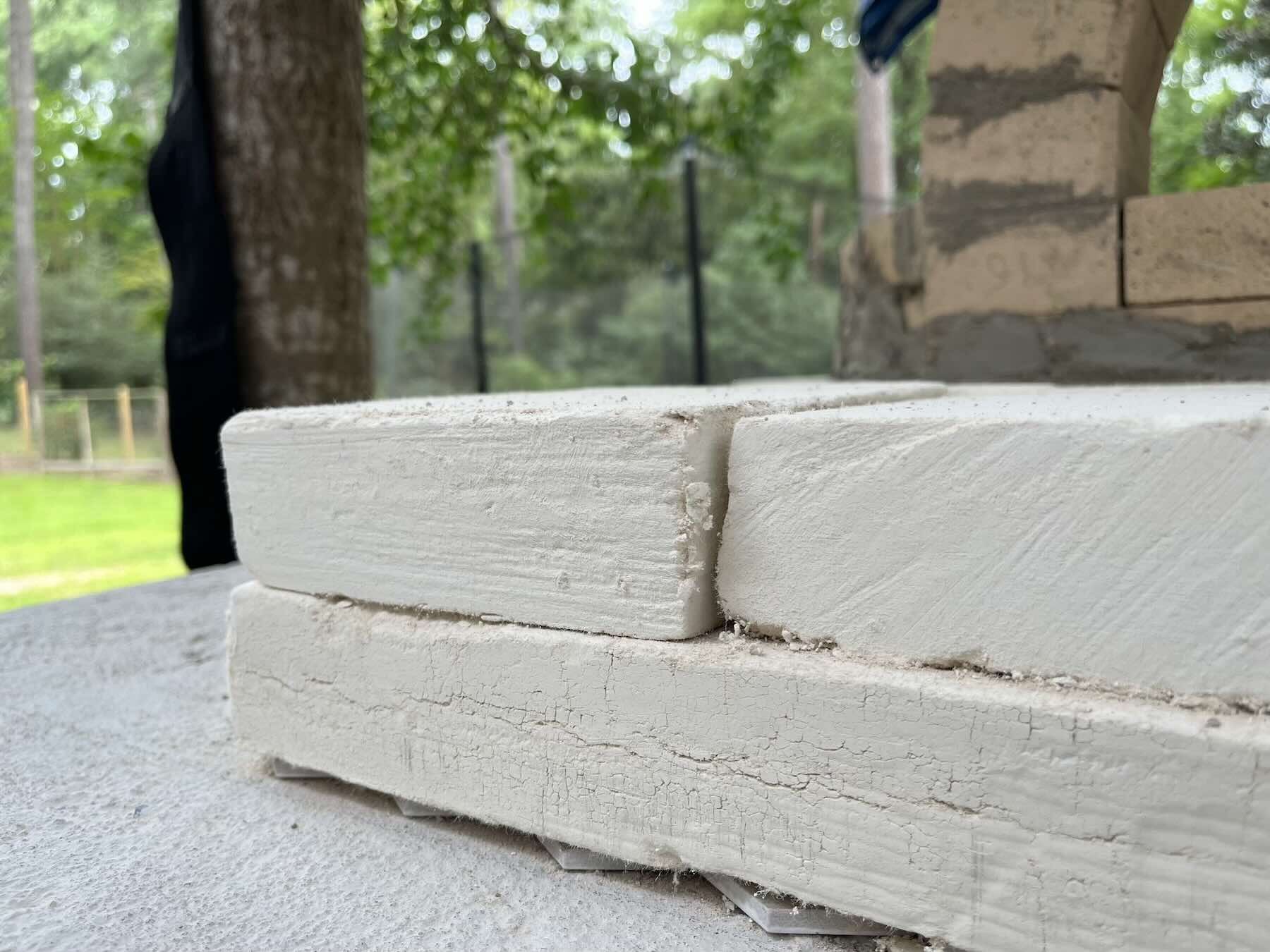

                Since the front part of my insulation is still exposed, I thought I'd add a pic of the uneven thickness. This is the front left of my insulation base. The pieces on top are laying on the same block of insulation, so any difference is not due to unevenness of the slab. It's a little hard to see, but you can see the protruding edge along the top; here probably a 2mm. difference in thickness between the left-most piece and the one next to it.
