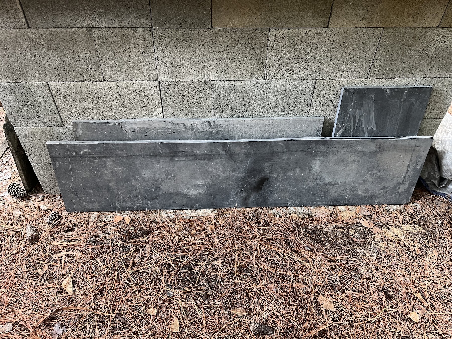

          I sawed down the pool table slate with my angle grinder. Took a bit of effort, but worked pretty well in the end. I cut off all the edges (which had holes for the pockets), then cut the front landing, which will cover the entire width of the hearth slab, and the vent landing, which is of course much narrower. I have a third piece remaining, which I will divide into two pieces to go on either side of the vent landing for additional work space.

              I have another question for the forum experts. For my vent landing, I'm going to place both the landing and the arch on a third layer of CalSil. Putting the slate piece on top of that will not put it high enough, so I need some additional height. I could try to cut CalSill to reduce its thickness, but I worry that would be messy and uneven.
              I am thinking I could get some perlite and make perlcrete as a bed for the slate piece. The idea would be to build the vent arch first, so the perlcrete has natural borders on 3 sides (both sides of the arch and the oven front) and I can temporarily put up a board on the front. Then I can pour the perlcrete and add or reduce exactly enough to make the slate piece level with the oven floor. Does that sound feasible?
              • #52
                How much more height do you need?
                • #53
                  I need somewhere between 3/4" and 1", I believe.
                  • #54
                    Insulating firebricks, maybe? I won't post the link in deference to our hosts/forum policy, but a quick google search turned up an Amazon listing for a 6-pack of 9"x4.5"x0.75" insulating firebricks. Doubtless there are other sources if I found that one so easily.
                    • #55
                      That is a good idea! Would save a lot of mess and effort. Thanks!
                      • #56
                        That was my thought or firebrick splits (1.25") if you needed a little more, since you're already using CaSil under.
                        • #57
                          Firebrick splits are an expensive method of just elevating the space. A vermicrete slab, concrete pavers or a cast concrete slab of whatever thickness you require would be my solution. That area won’t see too much heat.
                          • #58
                            Yes, I realized that firebrick splits are not the cheapest option. How about if I use some additional pieces of slate to put it on? I have plenty of those lying around.
                            Whatever I end up using, is it better to fill the whole space, or should I rest my landing on a few pieces, with the rest being air, which might be a better insulator than the material?
