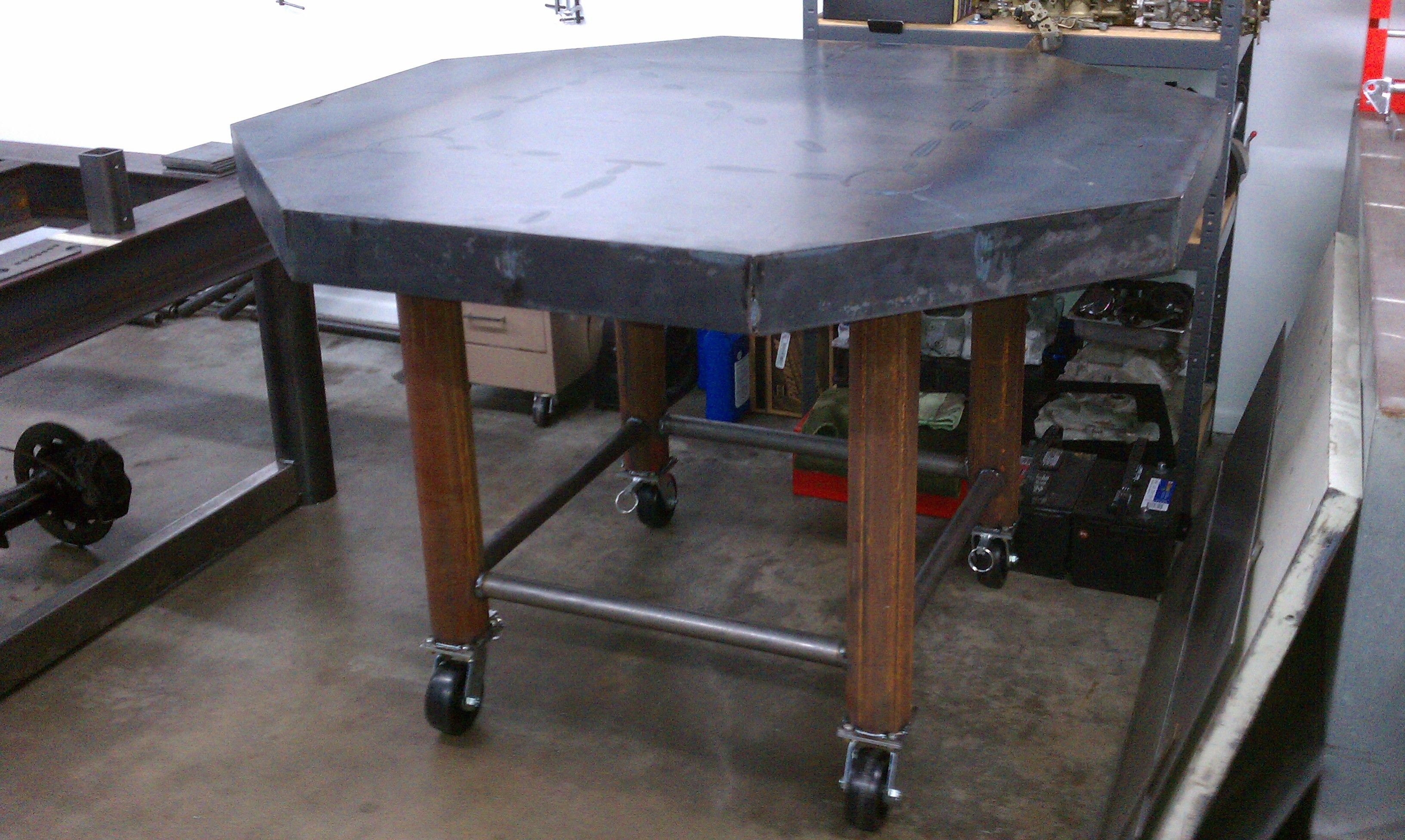

            The fabricator is a good friend of mine. I’m not overly concerned about the cost. But from an engineering perspective I think it can be done. I actually got the idea from a member on this forum. Click image for larger version

              David, Agreed rust is always the enemy. I would be using either 304 stainless or have the stand powder coated.
