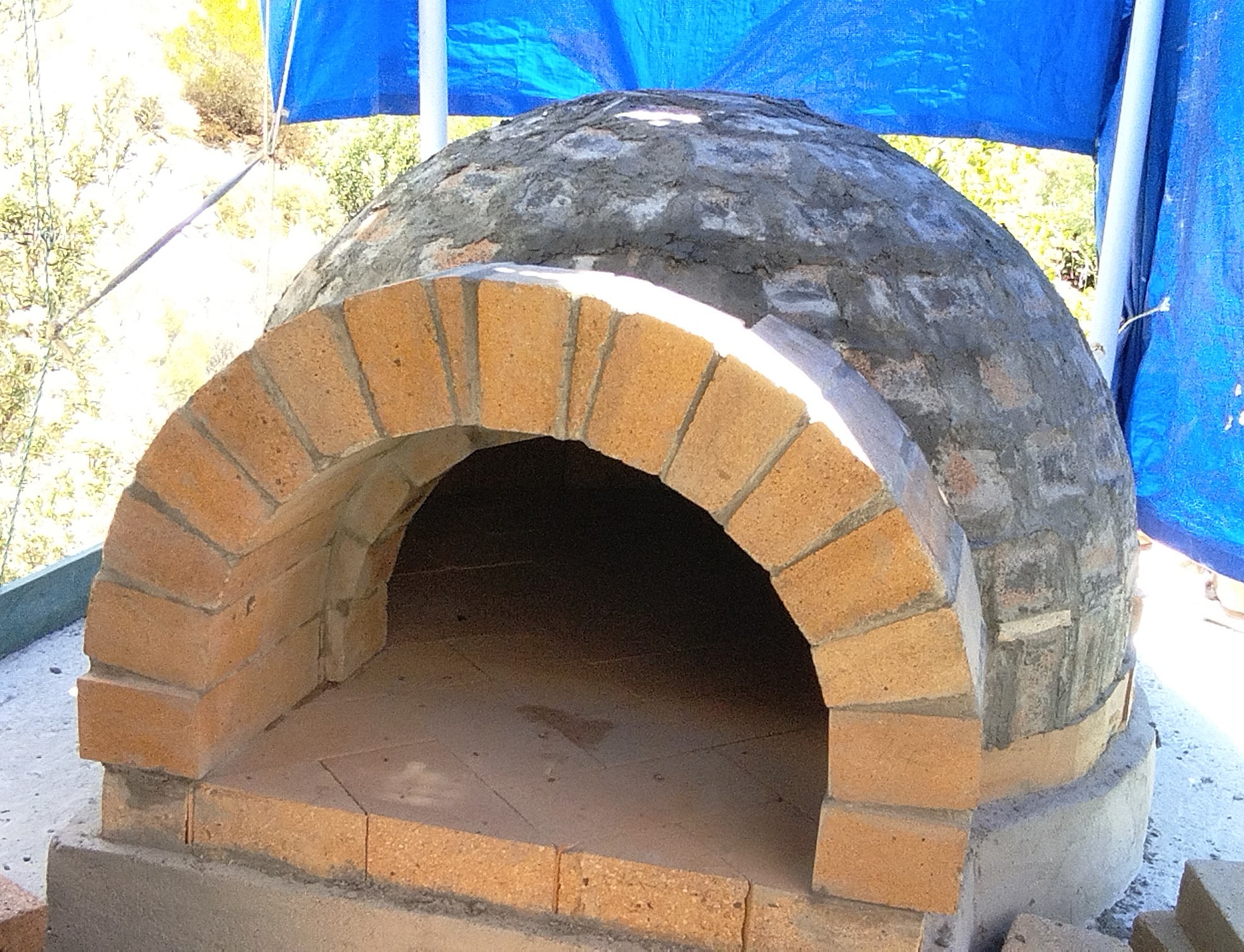

                  Well I finally finished the dome, hopefully I can get the photo downloaded.
                  Many thanks to all who have given me such sound advice, I am sure it would have been a lot more problematic were it not for you guys.
                  I will be starting with the chimney, now I see that I will probably run out of refractory cement before I finish it, I assume that standard Portland cement and mortar would work for that, and if so what mixture would be best.
                  Kindest regards to all
                  The attachment won't download so I will send it separately

                    I cropped the photo to bring it into specs

                      Nicely done--looks great!
                      Portland cement-based mortar should be fine for your chimney--you could add lime and fireclay to do the full "homebrew" refractory mortar, but likely for the transition to your flue, even plain mortar would be fine. Homebrew refractory is 3:1:1:1 sandortland:lime:fireclay by volume. If you don't have (or want to use) lime or fireclay, just skip those parts (standard brick mortar being 3:1 sand and portland cement).
                      You may have this in mind, but just want to flag that to get proper draw, the flue for a 36"/90cm diameter oven needs to be at least a 6"/15cm diameter round, or equivalent cross-sectional area (~28 square inches/180cm^2). Based on brick widths, looks like your opening right now is around 4.5" x 13.5", which is plenty, but be careful as you narrow it to meet the flue that you don't shrink it too much.
