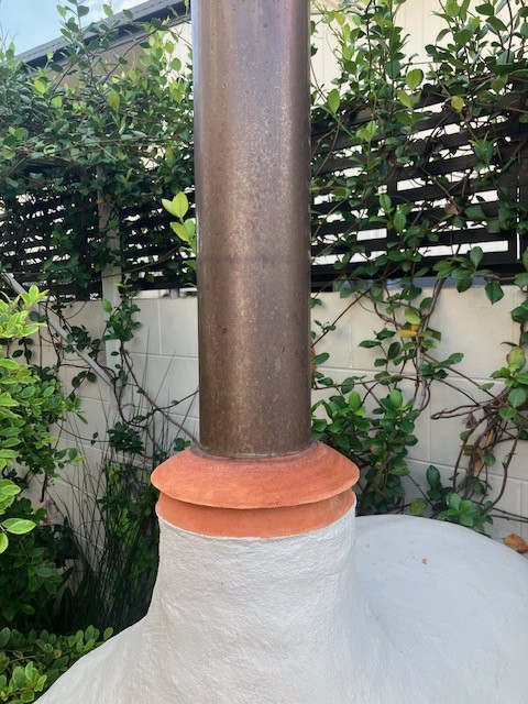

        I managed to get to the city and picked up some second hand 150mm (6") stainless flue pipes, I also needed 2 X 45 degree bends which I had to purchase new. Has anyone had experience in painting stainless.? The method and type of paint would help me a lot, remembering that this is all outside.
        I researched this a fair amount in the summer of 2023 and found spray paint that worked well for stainless steel and spray paint that held up to flue temperatures. But, did not find any that would do both. Maybe there are new products or other builders who have found one.
        • #34
          Try muffler paints, they may work.
          Left unpainted, f it’s a single flue pipe it will not retain the shiny stainless appearance. It will go a kind of pewter grey colour that I personally don’t find unattractive, it is what it is. My oven and pipe are around 17 years old.
          Another option is to use a double flue pipe and because the outer pipe doesn’t get so hot should retain its shiny stainless appearance.

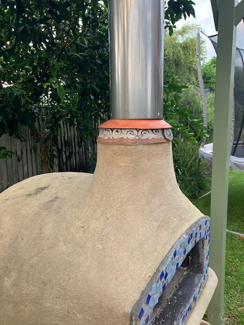

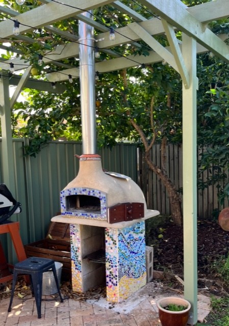

          • #35
            Here's an oven that's two or three years old that has a double flue and the outer pipe remains nice and shiny. Because the pipe is supported at the top where it penetrates a pergola I used a 6" pipe around the inner 5" one. There's some ceramic fibre blanket stuffed between the two pipes both at the bottom and top. This worked very well to centre the inner pipe inside the outer one as well as providing some insulation there. The normaldistance between pipes is 1", but with this oven it is only 1/2" because it's a 6" pipe surroundinh a 5" one.
