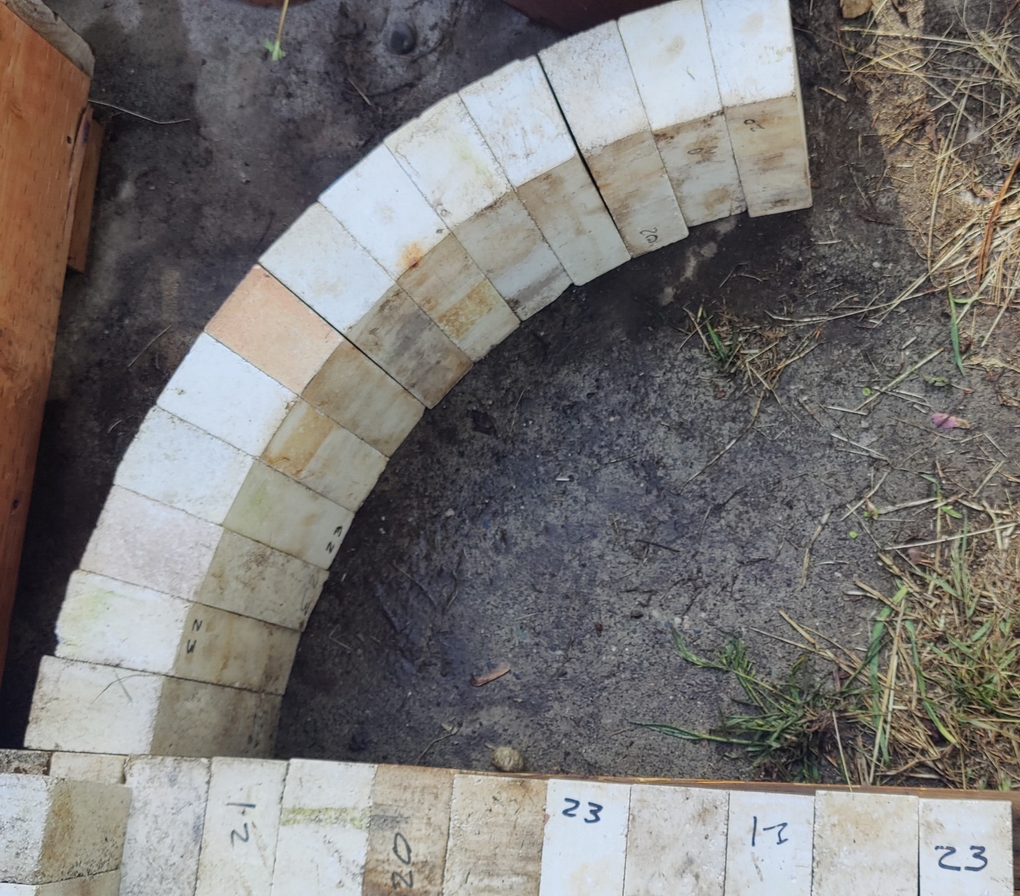

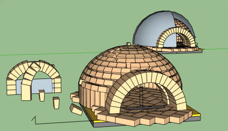

    4. I’m excited and delighted to prepare to build my next oven with tighter cuts for all the bricks. Thanks to the helpful work of others (like this discussion here), I plan to cut the bricks along both the “tilt” and “side” angle planes, hopefully creating a tight and self-locking brick dome with minimal use of mortar. My rough-and-ready first oven cooks just as well as any oven I’ve heard described here, so this decision isn’t about making better pizza, rather it’s about my wanting showcase my best craftsmanship. These last few years have been rough ones for me, but something I’ve taken from them is that I’m never happy with my rushed, half-ass efforts, when I knew I could do better; and I am excited to do better this time around!

      I would revisit whether you want to do full soldiers on the first roll, maybe consider half soldiers or even half headers to reduce the outward pressure from the dome.
      Thanks for the welcome back! I love your photo album by the way! I was just noticing that advice today on a forum post. I did half course on top of the floor last time, but I see lots of folks advocating for the floor to be inside the dome. If folks inset the floor inside the dome, how do you get any height for that first soldier course?
        • 9208
        Setting the first course as soldiers (bricks standing on edge each one behind the other has some disadvantages in structure. Given that the weakest point of a hemisphere is at its base ( think of the strength of an eggshell if cut in half). As inner oven cracks always start at the base, having a vertical mortar coarse double the usual height is asking for trouble to begin right there. Far better to have two half bricks laid on bond (staggered) before leaning in.
        There’s no difference between dome outside floor and dome inside floor if the IT begins at floor level. The advantage of dome over floor is that the floor perimeter cuts can be pretty rough, a big time saver. The disadvantage is that it would be almost impossible to replace a floor brick that has a dome sitting on top of it.

          Thanks David, that's kind of a "no duh" solution lol that should have been staring me in the face Based on my original oven, I can't imagine a situation where I'd need to replace a floor brick along the edge of the oven as there is just so little wear and contact there. In fact I can't really imagine needing to replace a floor brick in general, even after slinging dutch ovens and other cast iron cookware around inside of mine, but I'm sure situations present themselves.
          My thought for having the floor inside the dome was more about the thermal mass difference between the heavier duty bricks I'll be using for the floor verses the lighter duty I'll be using for the dome. I was completely satisfied with the thermal mass of the lighter bricks, so I was wanting to minimize the heat soaking effect of the denser bricks around the hard-to-heat edge of the oven. But I think I'm overthinking it a bit and the concern is likely trivial.
            • 9208
            I agree. The time saved by making rough cuts for the outside of the floor bricks more than makes up for not being able to replace them. It’s only the bricks in the centre that are likely to crack or spall and provided you lay the floor loose you can still change them easily. If you use medium duty bricks for the floor there shouldn’t be any spalling or cracking anyway.
