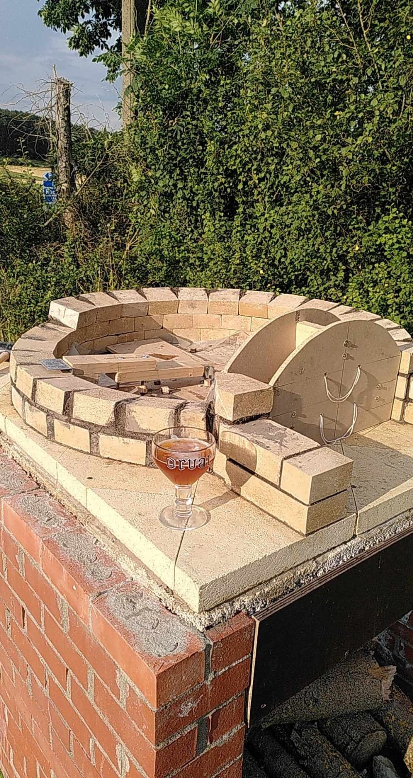

                Hi everyone!
                Slow but steady, we're making progress here.
                With a lot of help from this forum, we've made it thus far, but the inner arch is looming large at this point.

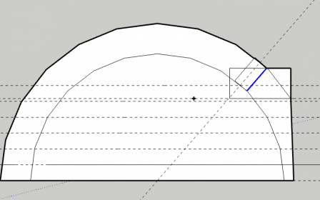

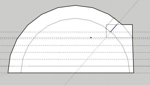

                I sort of understand the basics of it, but there's one thing that confuses me.
                On the full bricks forming the innner arch, you should have two cut lines. One cut line is determined by the inner diameter of the oven. But what determines the second cut line?
                Option 1: second cut line is determined by the (estimated) heighth of the ring at which the course intersecting the arch sits. In our design, that creates a lip, so the TDC doesn't make full contact with the brick sitting on top. (see image nr. 1)
                Option 2: second cut line is determined by de outer diameter of the dome (or the depth of the brick, in my case 4,13 inches). In that case the brick sits a little bit lower, thus creating a dip in the ring that probably has to be corrected for by shaving off a piece of brick before continuing the next course. (see image nr. 2)
                What option is advisable from a construction standpoint? Or is it not that important and is either option fine?

                      The best explanation of inner arch to dome transition I have seen is on page 4 of Mongo’s build.

                        Good choice of beer :-D. Picked up a few cartons and the glass as well last time we visited the brewery/monastery. Do you live close to it?
                        You mentioned before that you couldn't find fireclay: I bought it from kachelmaterialenshop. Their shipping cost to Belgium and the Netherlands are pretty similar it seems. I might also have some left over once I'm done building the chimney (I live in Eindhoven), although it seems that in the end you went with a refractory mortar?
                        The arch bricks are indeed a little strange: in the end you'll always end up puzzling the rings going above it into place by shaving pieces off. There's also some pictures on how I did it in my build thread, post #24. In picture nr3 you see an IT additional tool that points out the external diameter of the dome. As everything else I've taken that IT additional tool design from one of the other threads, but I don't remember whose.
                        For the construction or the visual appeal I don't think anything really matters: it's all compressive loads and invisible.

                          NewEnglandNewb Thanks a lot. It's cristal clear now how to figure out the inner and outer diameter. It remains a question whether one should take into account the heigth of the ring intersecting the inner arch, I guess it's not that important.
                          Toiletman Wow nice build! Impressive tapering! Did you get your other stuff (blanket, perlite) also from the kachelmaterialenshop? Indeed, I went with the mortar. As for the beer, the location of the oven is not that far from the brewery but It 's quite far from where I live. I like all trappist beers (the Dutch ones included ) but if there is one that stands out, it is Orval!

                            #14
                            I also puzzled about whether it makes sense to take into account the horizontal courses that abut the inner arch in cutting the arch bricks.
                            In the end I decided against it, feeling that 1) It should be a relatively straightforward cut to adjust the abutting horizontal brick to the arch (as opposed to vice versa), and 2) for structural strength, it is probably best to keep the arch bricks as straightforward as possible (i.e. the way it is explained in mongo's build).
