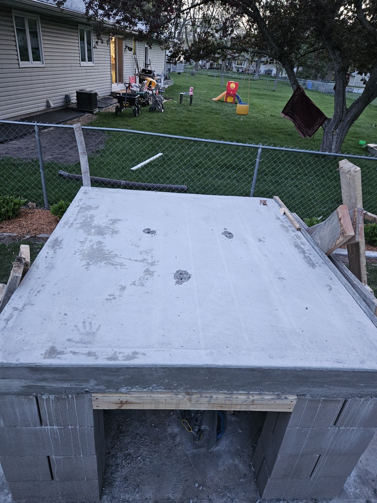

      Also I pulled all the forms off everything this afternoon after I got rid of all the leftover concrete. Fortunately there is a sight the recycles concrete very near by me and allows you to just drop it off for free. I don't want to admit just how many trips I have made there over the years. I also popped the weep holes through the surface of the slab. One blew out a little bigger than I was planning but I am sure it will be just fine.

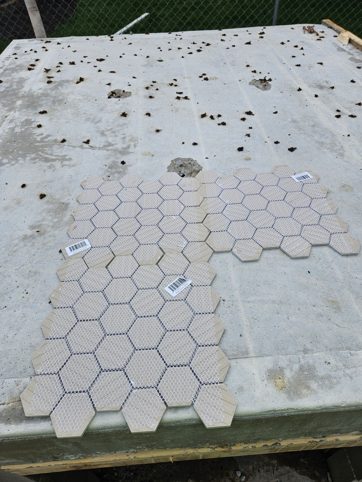

                  I went to home depot this afternoon and my son managed to find some tile sheets on clearance for $2.27 per sqft. I picked up 26 sqft as I believe that should be enough to cover under the oven. I take it the standard practice is to put the mesh facing up like in the picture. I am extremely excited as my kit is supposed to be delivered tomorrow some time. I can't wait to get started and have it start to look like something other than a pile of bricks and slobs of concrete

                    If a tile is covering a drain hole, just remove that individual tile. I presume you are placing some cal sil board over the tiles.

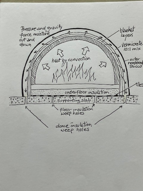

                          I brought the idea to this forum of having weep holes under the insulating board many years ago mainly because my design employs a recess in the supporting slab. This innovation has become quite popular now and works extremly well.I redesigned my supporting slab to accomodate more weep holes that locate to the dome insulating space. This also works extremely well. Moisture always wants to run away from heat. The drawing explains how it works.

                            david s I understand that 2" of calsil is the minimum, but on my last oven I went nuts and did everything to get extended heat retention and I never really used it. So this time I decided I was not going to go after that as it just adds to the cost and complexity of finding the materials.
                            As to the weep holes I can understand that it makes sense. I really don't want to have wet insulation. I have heard the horror stories of that. I am planning to build a Pavillion that will be 8x12 so roof is roughly 10x15 so that should keep most of the rain and snow off the oven but probably not all of it.

                              This what I came up with to make sure no drain hole was blocked by a tile. Click image for larger version

                                Hey Gulf thanks for the input. How on earth did you manage to not have and blowout? Or did you drill down from above. I had the sleve only 1/4" below the surface and popped a 3" disk out of each. I was pretty surprised that it blew out that bad as it was just a light tap with a chunk or rebar. No hammer at all.
                                If I had not had the big blowouts I was considering doing what you posted. But as is will probably just cut the tile out above the hole and let it rideas it already slopes in pretty nicely.
