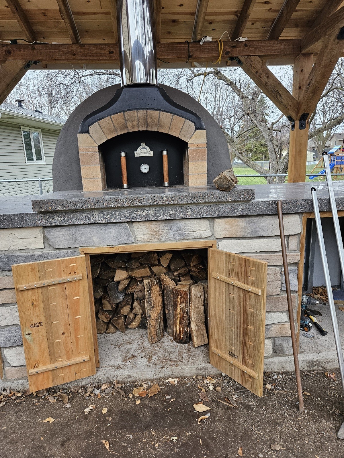

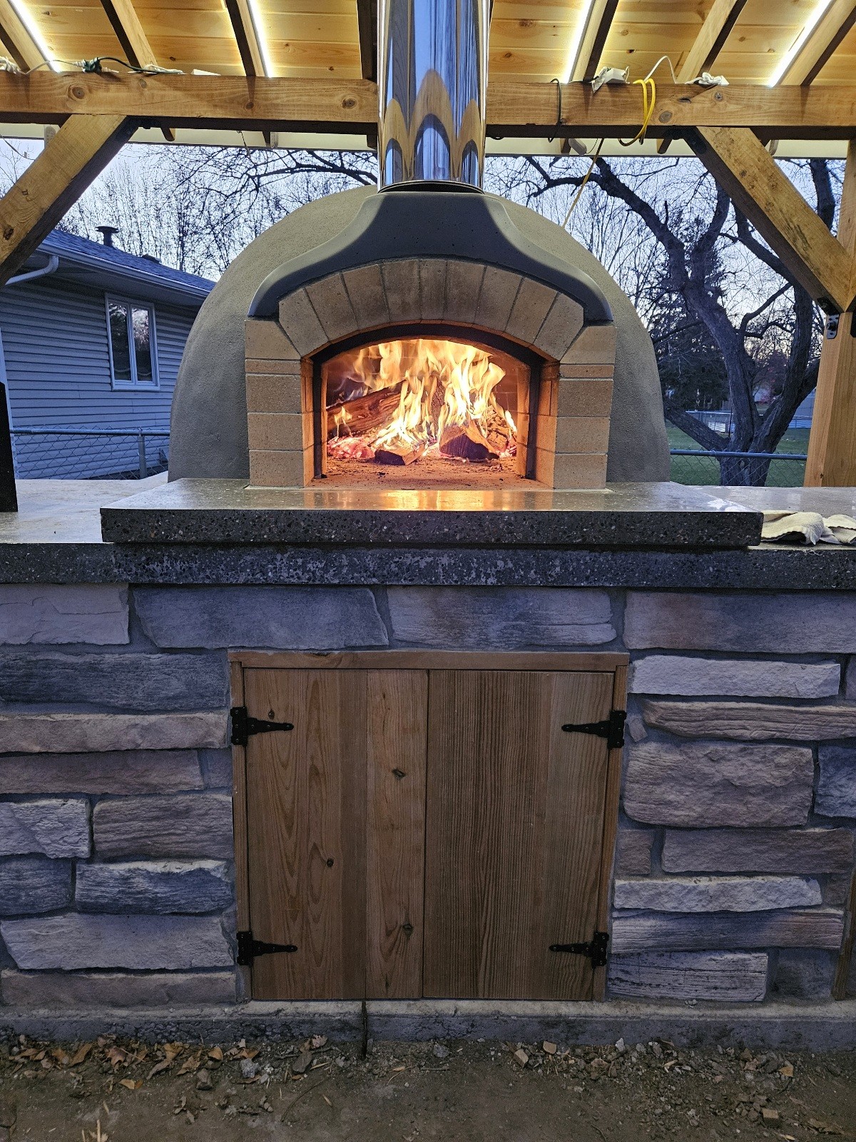

    Well I managed to scam a partial day off of work today and so I decided to make a run at some of the final bits left on the oven. I made the form for the front lip last night and bent the rebar and mixed up the concrete and got it poured. I had 2 bags left that were sitting under one of my counter tops and were still mostly good. There were a few hard parts but I dug those out. There was just enough to fill the form. I also put a milk house heater on it and mixed with hot water. It is pretty cool out now but not freezing yet. I did it in the garage too so it is warmer in there than outside. I also picked up a few 5/4 ceader tone deck boards. I cut them down and got the wood storage doors built and the parts cut for the storage cabinet door. It is amazing how much sawdust I made doing that. I am excited to get the doors done and installed. That will help keep snow and debris out from under there.

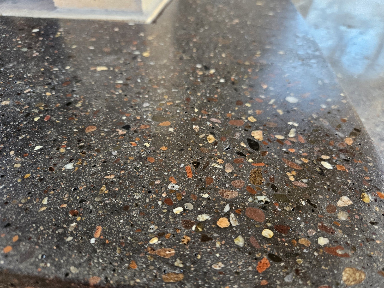

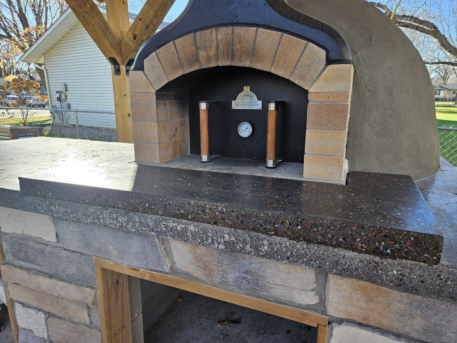

      Well I got lucky and it was in the middle 40's on Saturday so I went ahead and ground the lip down and then got out my way polisher and went all the way up to 800 grit again. It turned out beautiful. I then had a friend stop by and help me lift it into place to check fit and then mixed up a batch of mortar to set it into final place. I think my form may have sagged a little bit as the lip is maybe 1/16 low on both sides and about the same high in the middle but I am going to call that good enough. I also got 2 of the doors built and installed so only one door left and I have all the parts cut for that one already just have to put it together. So all in all it was a productive weekend.

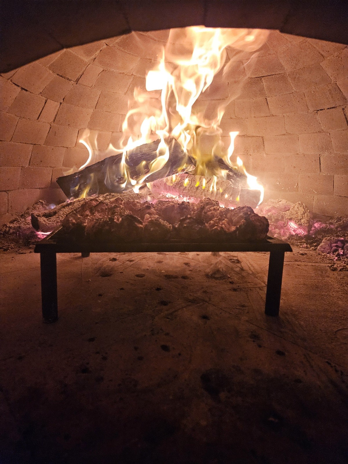

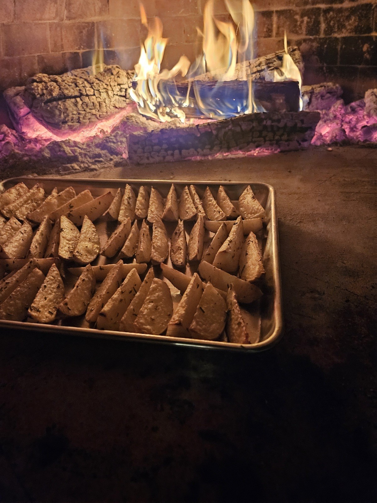

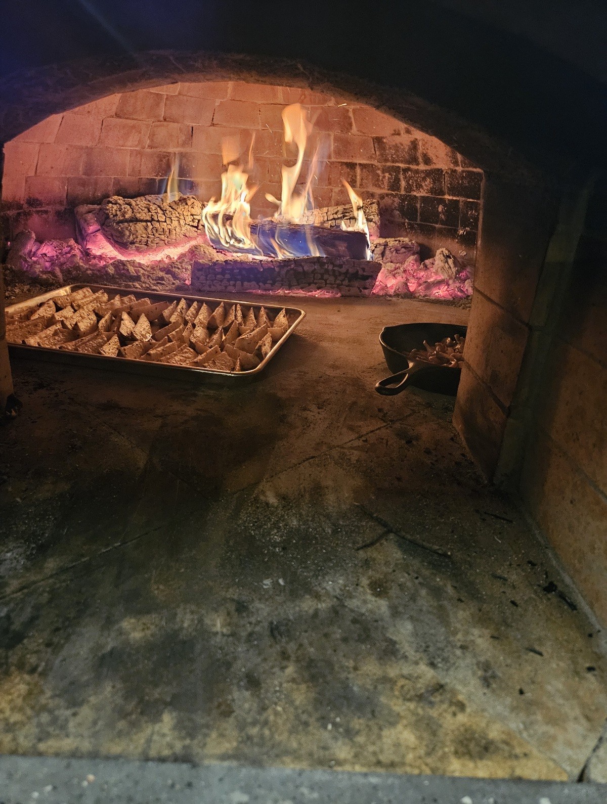

        Well I have managed to cook with the oven a few times now that I have the front entry lip on and I am very happy with it. I like that i have enough room to set things there and have them not be in the way. It also helps with rearranging pans in the oven when moving things around. I didn't really have much space in front of the last oven. So this definitely helps.
        I now have made hamburgers and wedge fries in the oven twice. It has turned out awesome both times. I love how you get the beautiful browning in the oven. I am trying to figure out how to cook most things in the oven so that I can get more use out of it. Plus it will teach me how to use it more effectively. Last week i tried making chocolate chip cookies in the oven and didn't pay close enough attention to them and burned them badly. I did it again this week and kept a flashlight with me and watched the whole time and turned the tray several times and they turned out great.

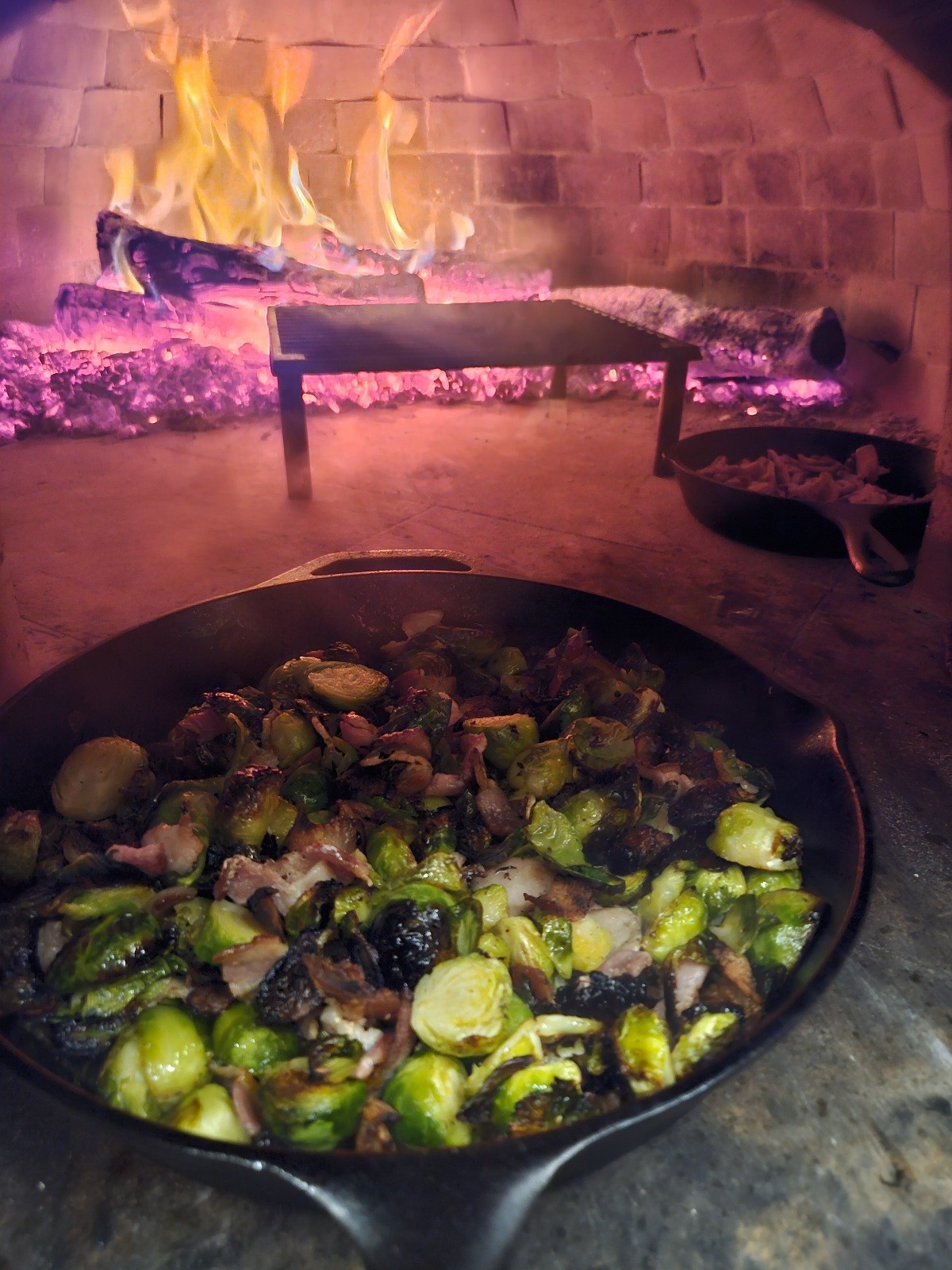

          of course I had to try out the new wood so I made Brussel sprouts and bacon and a pan of mushrooms and some steaks. Once again it turned out fantastic. I just love cooking in the oven and i am trying to learn how to cook basically anything I would inside the house. It may take a bit of trial and error but that is the fun part.

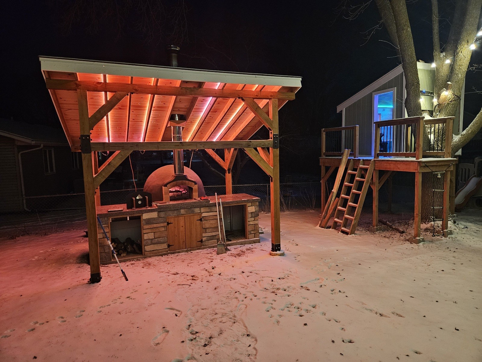

            Well it has been a pretty cold winter here so far. I have still been using the oven some, but maybe not as much as I want. I can't wait for warmer weather to get here again. Make it easier to use the oven and hopefully get my patio in front of the oven done too.

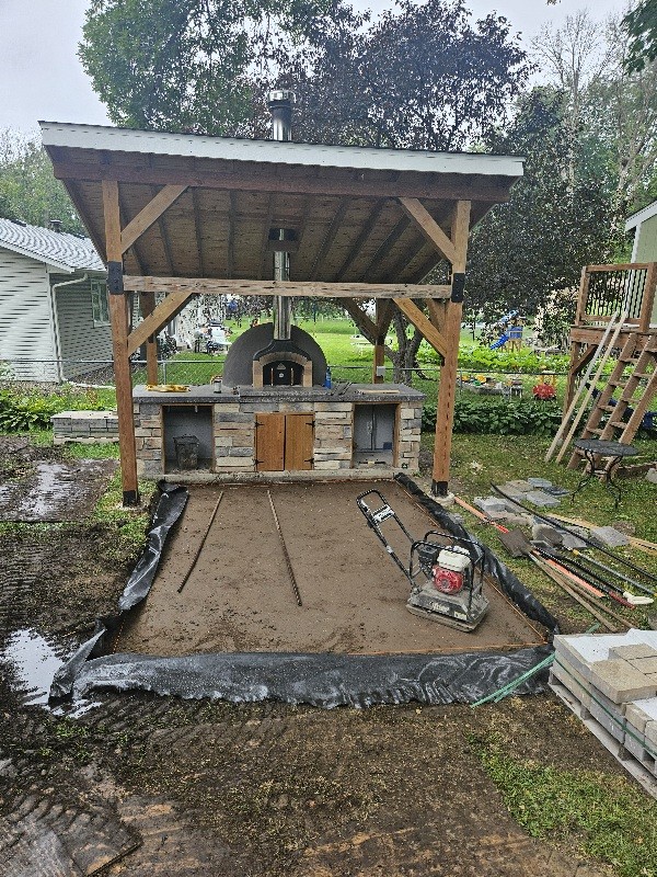

                            Well i finally have some progress on the patio for the oven. I was originally promised that they would do the insulation in the middle to end of July. We'll they completely blew that promise and almost 2 months later they are getting started. I sure hope they actually show up tomorrow and actually finish the project. Last week they said they would be there Monday morning and finish on Tuesday. They showed up finally on Tuesday and were no show on Wednesday and Thursday. This really kind of bothers me as at work if we did this we would be fired. The reality is I am fully capable of finishing the rest. They did the hard part of digging the hole and packing the base. It would be easy for me to do the rest, and it has crossed my mind.

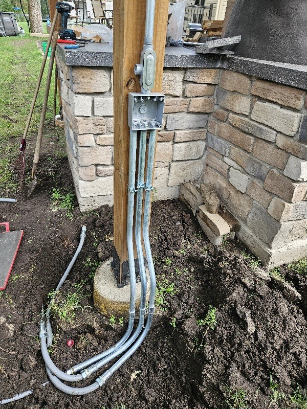

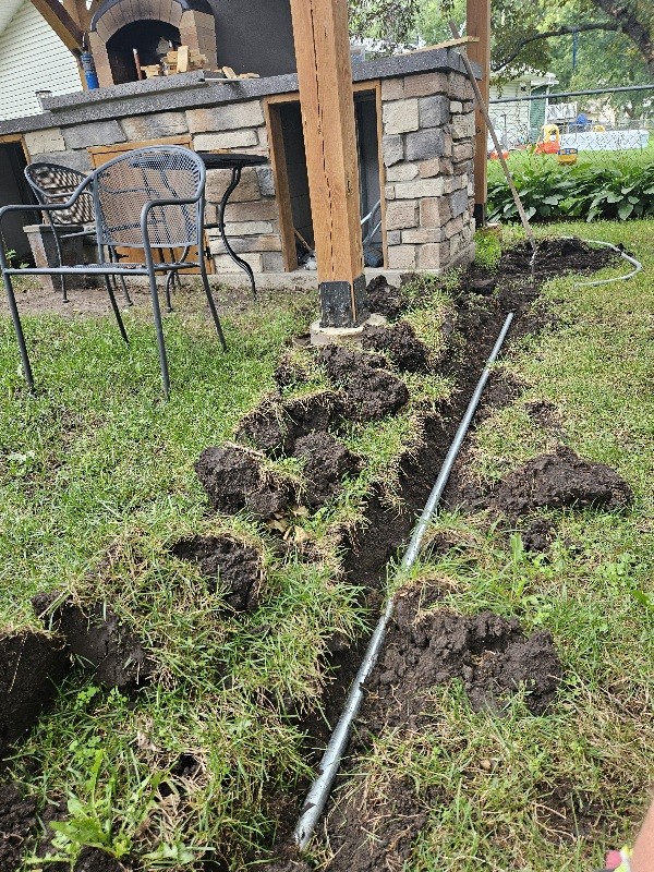

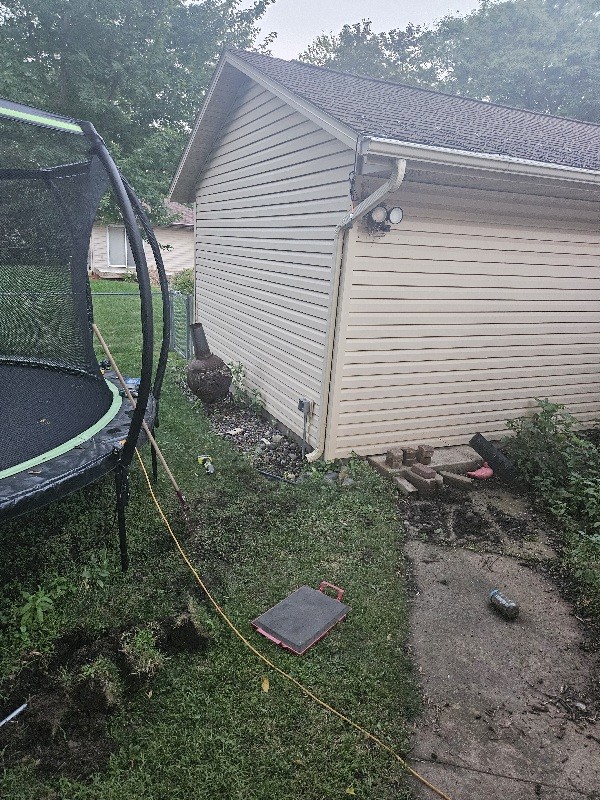

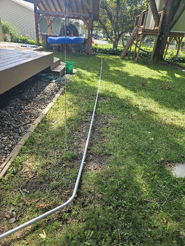

                              In the last few weeks I have also been working on getting my permanent power out to the pizza oven and treehouse. I had a free weekend a few weeks ago and went for it. I had prefabricated many of the bent parts at work earlier this spring when I had a slow day between projects. Everything was bent out of Rigid conduit and threaded together and fortunately everything fit together how it did in my mind when I made the parts. I only had to go down 6" because of the fact that it was rigid pipe. I managed to cobbel it all together from leftover parts and stuff that was going to be thrown away so all it cost me was time. All that is left to get it energized is to nail it up above the panel and land on the 2 new afci/gfci breakers that I have waiting to get installed when I have time.
