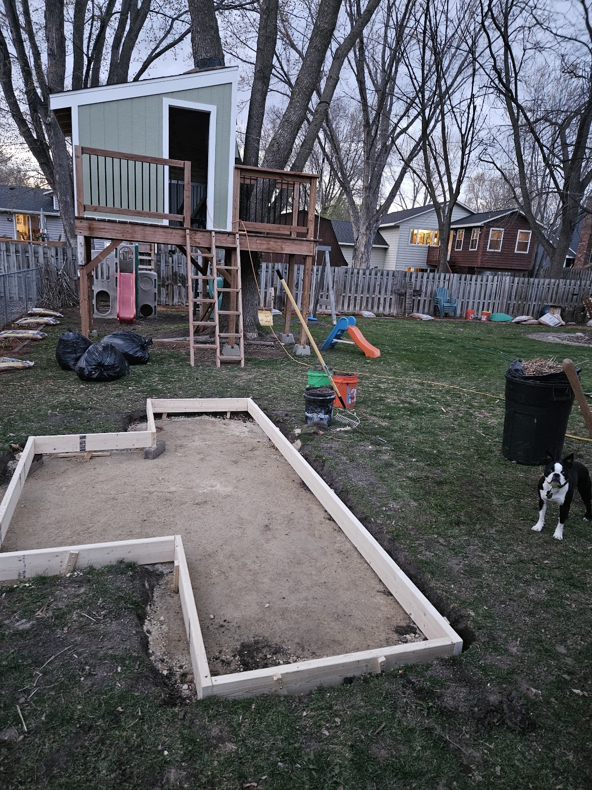

        Well I managed to get some work done this weekend. I got the area all dug out for the slab. I went down around 12 to 14" from the highest point and removed all the topsoil down to the clay that was undisturbed. After that I went out and rented a plate compactor and compacted the base. I then brought in about 6 to 8" of class 5 gravel and compacted it in 1.5 to 2" batches. I am feeling pretty good about this choice and I am unwilling to go any deeper anyway. The clay gets very hard as we go down. I now need to frame the form for the slab and then get some rebar. I am planning to be around 6" deep for the concrete and 1/2" regarding ties 8" on center in both directions.

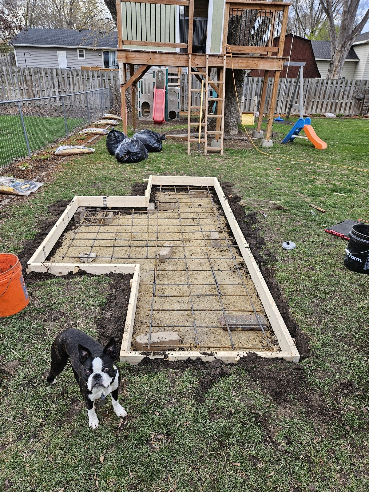

          I got a little more done today. I got the slab all framed in and level. I also picked up a bunch of rebar and I am hoping to get that all put in tomorrow. I am then hoping to pour the concrete on Wednesday. I really hope I can get this all done this week as it is supposed to rain all weekend and like half of next week.

            Well I got a short load reserved for 1pm tomorrow. Does anyone see anything that is glaringly wrong? Might be over kill with 1/2" rebar and between 6 and 9" thick but it shouldn't go anywhere.
            Randy

              If you have the opportunity, probably worth putting some rebar diagonally across those inside corners to prevent (more-or-less cosmetic) cracking. See post #7 in my build thread: https://community.fornobravo.com/for...his-time-in-ca

                rsandler I had just saw that post this morning. I will try to toss a few chunks in like you had suggested. I had considered doing that last night but time got away from me and I was exhausted after working a full day then getting everything setup. I had brought home a mini portable bandsaw to cut all the rebar and apparently the blade was bad so it just scratched the surface. So I had to go find my grinder and use that. Fortunately the tri-vise I pulled out of the garbage a few years ago finally came in handy.

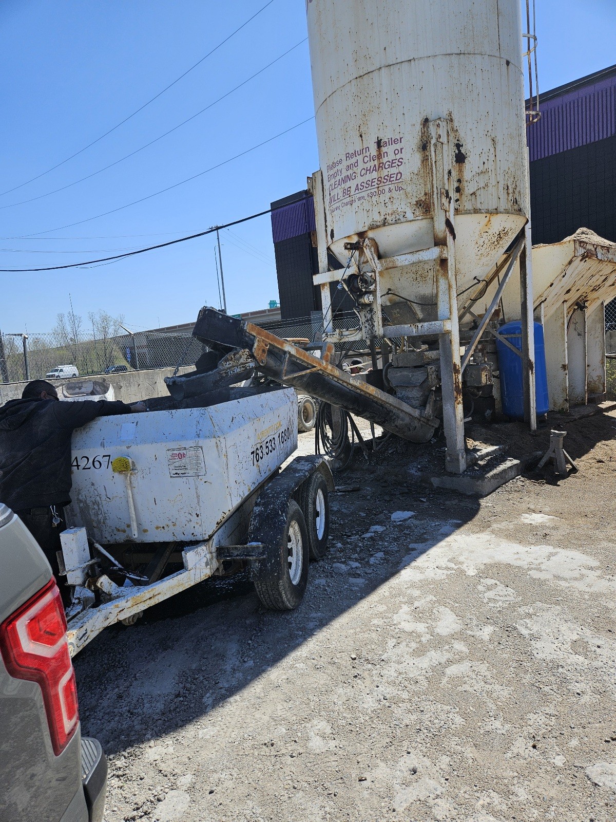

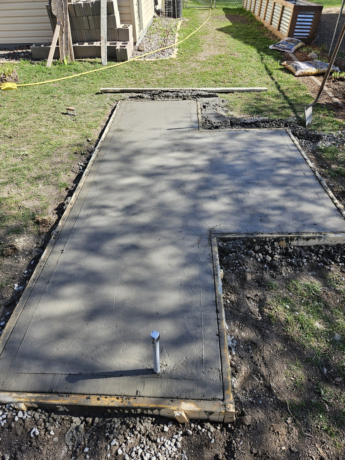

                  Well I managed to get the concrete all poured. I was lucky and had just a bit more than enough with 1.25yd. It was a lot of work by myself but I am very happy to have it done. It may not be the best slab I have ever done but it was to wet to finish so I returned the trailer and when I got back it was getting pretty stiff but I made it work.
                  • RandyJ
                    • May 2010
                    • 1191
                    I don't know if anyone else has tried this but the rental shop near me has dump trailers for concrete. The rental is free with a load of ready mix. I did the math and this was cheaper then buying bags and mixing myself. Total was $245 plus tax for 1.25 yd. And I could pull it with my F-150. I will probably do the same thing when I do the support slab.

                      I had forgotten to mention that as rsandler had mentioned I added a peice of rebar at the corner to hopefully prevent cracks there. I had a few 18" chunks left sitting around so I placed them as I was doing the pour. So I guess my question is how long did it take for your cracks to show up? I wet the slab down last night and put a sheet of plastic over the slab. I figured that by earlier next week I will be ready to start making my stand. I will need to clean up some of the over run and get it off to the recycling center in the meantime.

                        We had the slab poured, then left on vacation for two weeks basically the next day. The cracks were there when we got back. Although, 9 months and many-thousand pounds of blocks bricks etc. later, it's still just a hairline crack, hard to see if you don't know what you're looking for. So not likely a big issue in any event.
