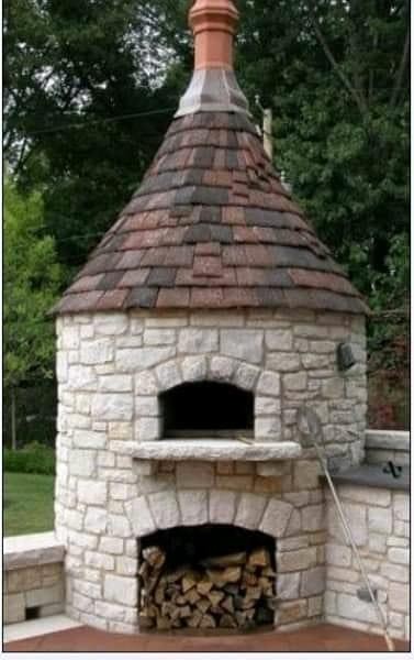

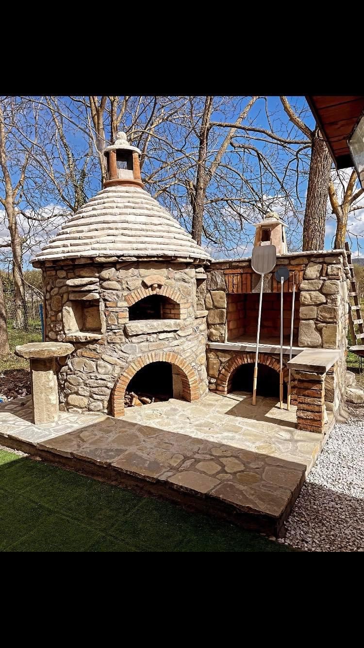

    While I haven’t seen any builds that look like what I’m planning on this site, I can’t say the idea is original. I spent a bunch of time scouring the web looking at pictures of WFOs to see what I like. I do really like the look of an exposed dome, but I will stick with my original plan to build an enclosure. My goal is to make it look something like these two ovens while incorporating all of the great ideas from others on this site.

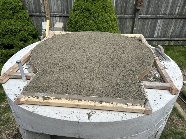

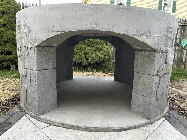

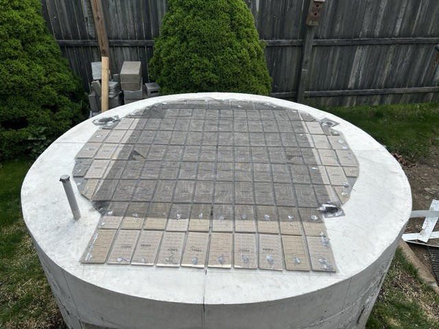

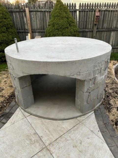

      I pulled the forms off the hearth pour after 9 days. I drilled the weep holes through from the bottom and layout out the floor on the hearth. Next step is to add tile. I did pick up some bug screen to add on top of the tile so the P/V Crete doesn’t clog the channels for the water to drain through.

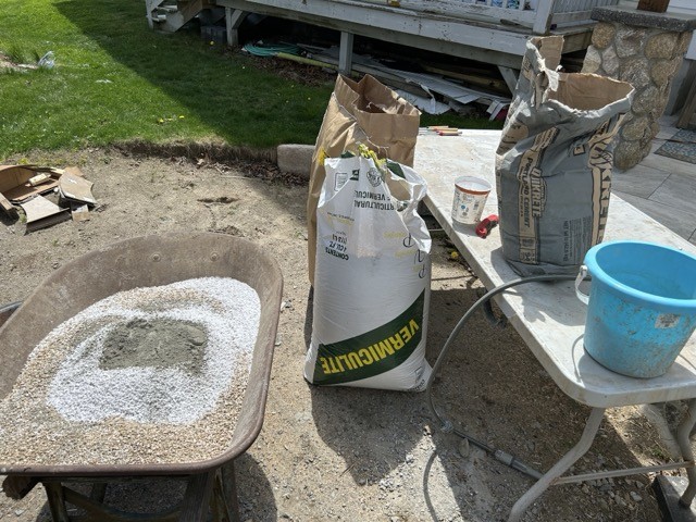

            I was able to get the first layer of under floor insulation down last weekend. I had enough left over tile from previous projects laying around to use that rather than buying mosaic squares like I have seen used in many recent builds. I placed them glazed face down. Then I covered the tiles with screen to keep the P/V-crete out of the channels between the tiles. Then I knocked out a form that is 3” tall and filled it with P/V-crete. I used a ratio of 2 parts vermiculite, 3 parts perlite, and 1 part Portland cement.
            I was traveling for work for the first half of this week so it sat for 4 days before I was able to see how it setup. It was really solid when I took a look today! Next step is putting down 2” of calcium silicate board and I can start playing with bricks.

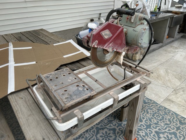

                              I was able to score an MK1080 wet saw on marketplace for $150. It needed some serious cleaning up, a new pump and a new blade but seems to be good to go now.

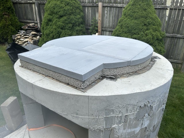

                              I also found a refractory supply store in a Boston suburb (Woburn) that has medium duty firebricks, calcium silicate board, and ceramic fiber blanket. I took a trip there last week and am now good to go with supplies. The calcium silicate is Skamol brand. I wasn’t expecting it to be as dense as it is, but I’m definitely not worried about it holding up to the weight of the bricks. Here is a shot of it cut to fit on top of the P/V Crete.

                                Good score, set your pump up by extending the water supply lines so the pump sits in a Homer bucket that you fill with clean water periodically, it will save the life of the pump. Both Gulf and I used this method and we never had to buy a new pump.
