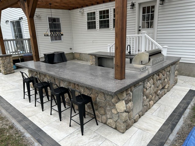

    Here is my kitchen, the finishes on the WFO will be similar.

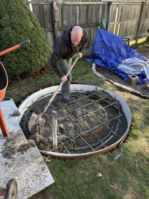

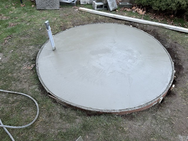

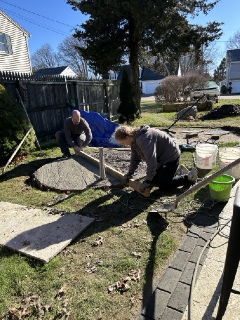

    I started with digging a 6’ diameter hole that ~15” deep. I filled 8” with compacted gravel and formed up the slab. The slab is a 8” deep X ~16” donut with the wood storage area thickness reduced to 4” thick. I bent up some 1/2” rebar, then got to work mixing concrete.

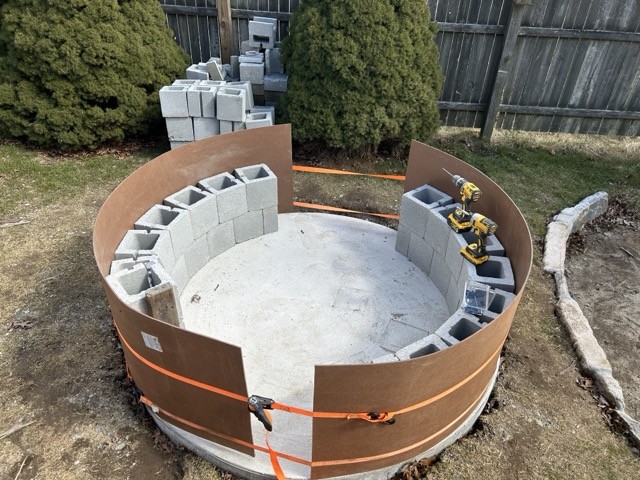

      The next step was the block work for the base. I used 8x8x8 CMUs so that the shape was a close to round as possible. I glued them together using PL500 on bond, then filled all of the cores with concrete and rebar. I also stuccoed the inside gave of the blocks before starting to form out the hearth since it will be much easier to access at this point. The plan is to have an arched entry to both the front and the back so I can have better access to the wood storage area.

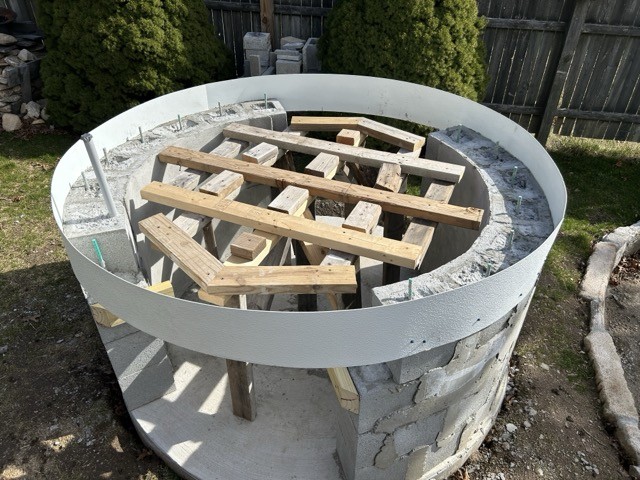

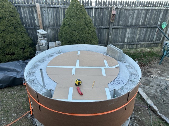

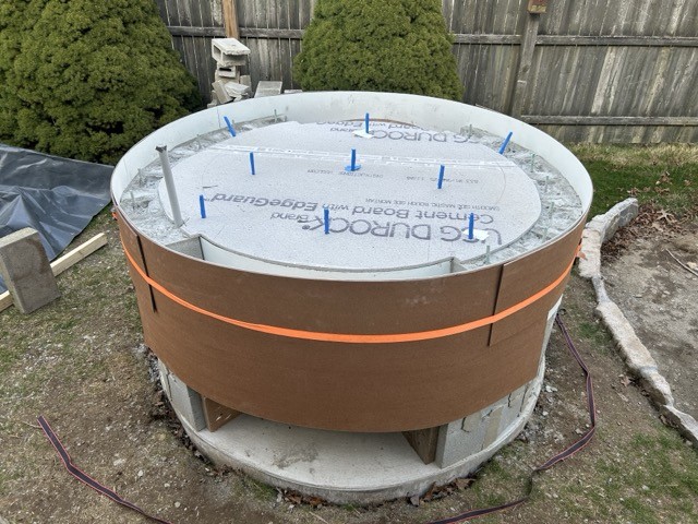

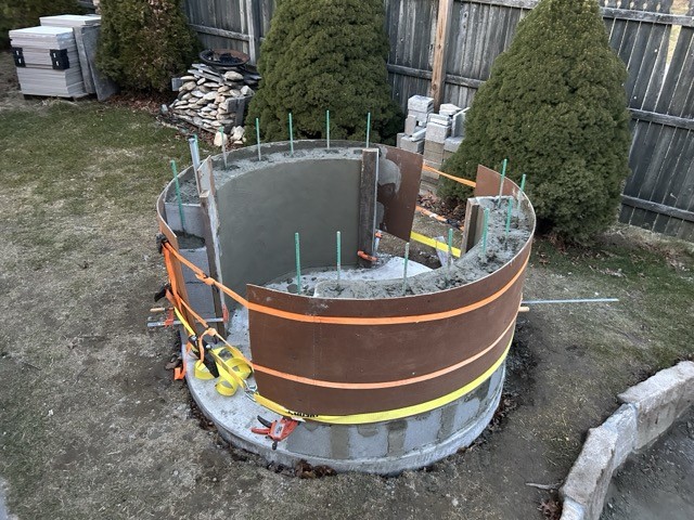

        Then I started building out the form for the hearth. I definitely didn’t make my life easy making this thing round. After scratching my head for a while I came up with a plan that I think will work. I built a table in the wood storage area and put a coupe of sheets of durock over that. The rest of the form is made from a sheet of plastic used for a wall covering in a bathroom or other wet space (the white plastic in the pictures) with a couple of sheets of hardboard as reinforcement.
        I laid out where the oven floor will sit on the hearth and added pins to cast weep holes under the floor as well as around the edge of the dome where the blanket insulation will be. That should provide an exit path for any water trapped between the dome and the enclosure.

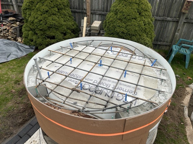

          I should be able to get the rebar for the hearth cut and wired in place this weekend, but probably won’t get it poured until next weekend. It will be 4” thick with 1/2” rebar ~10” on center.

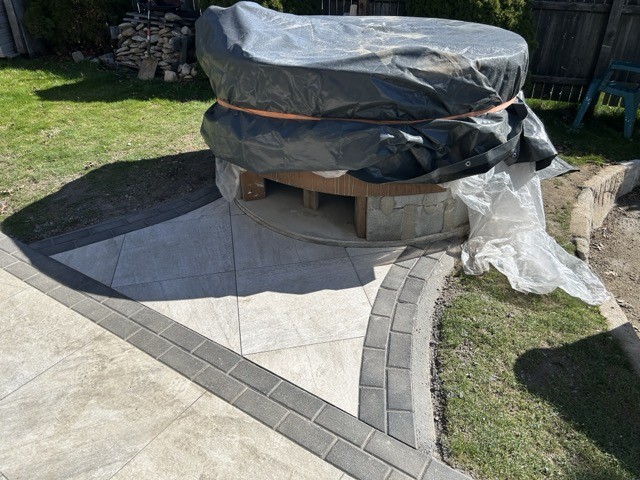

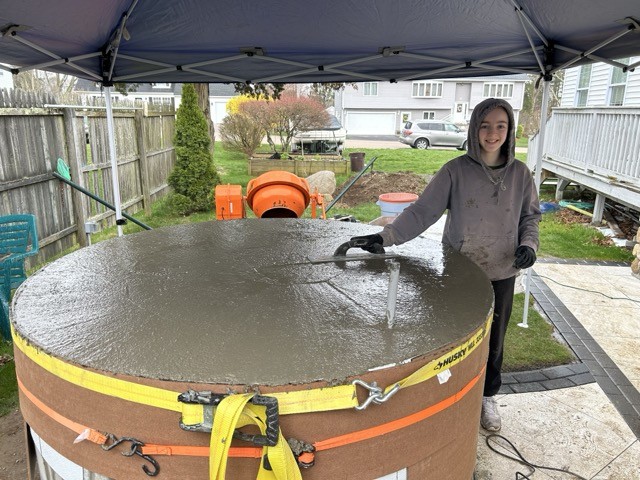

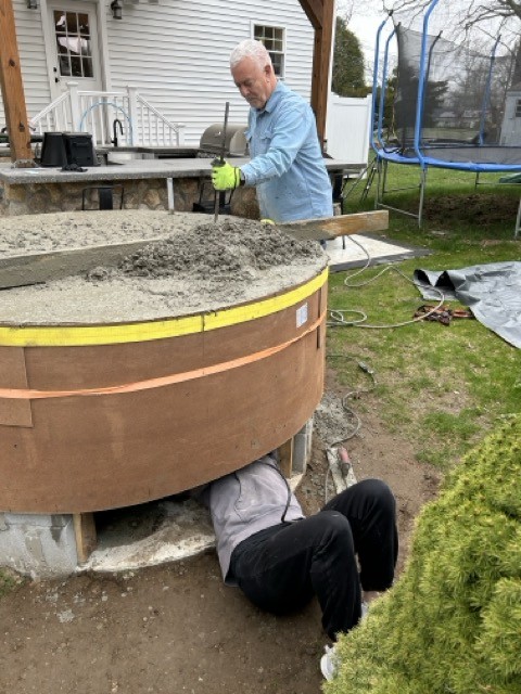

                  I got the hearth poured yesterday. I formed out arches over the front and back entrances to the wood storage and poured those monolithically with the hearth. 25 bags of concrete later and we got it done.
                  There was a 20% chance of rain when I woke up so I figured I would go for it. It started down pouring right when we finished mixing. We pulled out a tent and carried on.

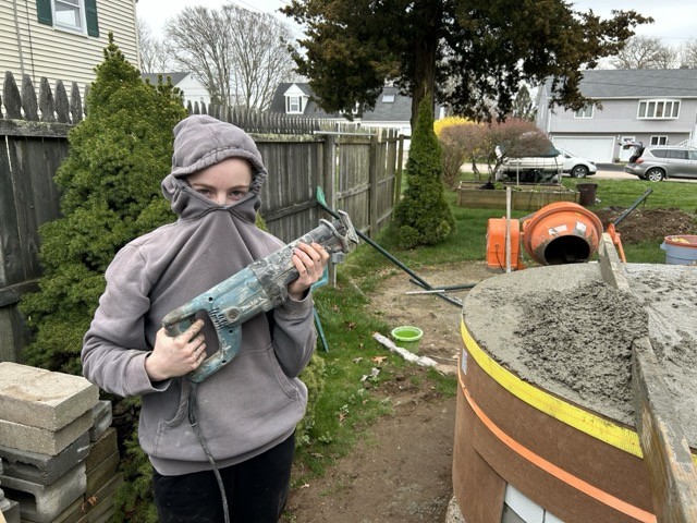

                  My 15 year old daughter loves finishing concrete. She got the job of vibrating with a sawsall with no blade (including from underneath) and then got to work with a float.
                  It is now covered with plastic and a tarp to let it cure for at least a week. Up next is underfloor insulation, then time to start playing with bricks. My underfloor insulation plan is porcelain tile, 2” of perlite/vermiculite concrete, then 2” of calcium silicate board.
