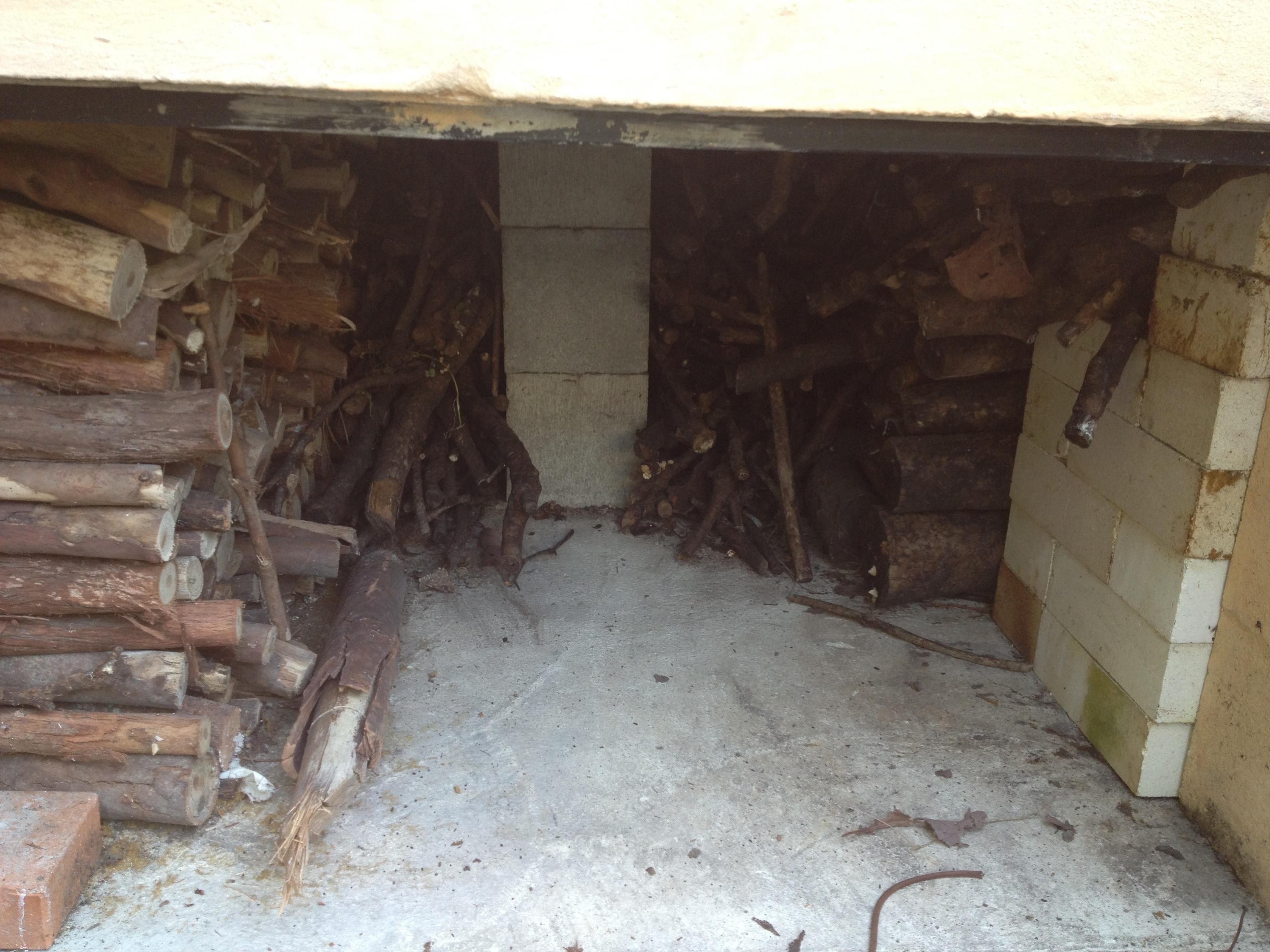

              Gudday
              Spent a delightfully time yesterday afternoon restocking the stowage in the oven stand. Did manage to finally remove the orange and lemon that had been entombed at the back forever and into the ready use stowage.
              To get the wood in there and out there's only one way to do it and that's to crawl.... And bark your back on the entrance.
              If I were to build again I build a H shape so that I get two shallow bays and build the entrance ways higher.
