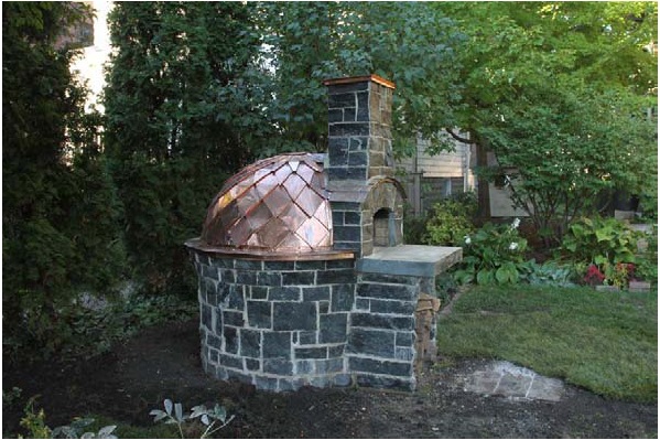

    I am an architect in Chicago that just finished a 36" pompei. Since the FB forums were so helpful to me during design and construction, I wanted to reciprocate. Unfortunately, my work cycle limited my work to two bursts - one last fall and one this summer.
    I've summarized my construction in five pdfs attached to this thread. Since the basic construction of the dome is covered elsewhere, I've tried to focus on the stuff I experimented with - the GFRC shells and the copper shingle roof. Both were successful.
    The idea behind the design was to keep the bulk of the oven to a minimum so that it would not overwhelm an urban back yard. Materials were chosen to outlast me. My wife was unbelievably supportive and let me over spend.
    Please note that I am not advocating for any techniques. Most will think I went overboard and they may be correct. I chalk it up to R&D.

    Great Job and thanks for posting your build. That is something to be very proud of. I actually thought about a copper clad dome, but had no idea how to do it. You have raised the bar again on this forum. Cheers!

      OMG!!!! That is the craziest thing ever. Beautiful, and incredibly imaginative.
      Lately, I have taken to bitching about how much work I have left on my oven. After looking at what you did with your enclosure, I think I am getting off easy.
      Please post some more pictures once that copper gets a verdigris patina!

        I took the liberty of posting a screenshot of the finished product so people could see what the kudos are about without having to download all the PDFs.

          Fantastic larryk - you're a credit to your profession - as well as a craftsman of some skill. I too considered a copper cladding, but didn't feel I could carry it off. As DJ says the inevitable verdigris finish will only add to the character.
          What gauge copper was it?

            Amac - I used 16 oz copper (weight per sf) which translates to .021" thickness. Twenty oz copper would work well, too, but would be even more expensive.

                I think the hurdle with the copper shingles is more cost vs. difficulty. Start with a full row of 45-degree half diamonds on the bottom. Then template the angle of the next full shingle course and mirror it to make a full shingle. Every shingle on that course will be the same. Then repeat up the dome. Shingles will get taller and skinnier as you go up the dome. Each dome is likely to be unique.
                The only tools you really need for the shingles are a 12-inch Malco folding tool and a good pair of tin snips.
                Use the folding tool to make two flanges that fold UNDER on the bottom and two flanges that fold OVER on top. Nest the bottom flanges of the upper shingle in the top flanges of the lower shingle course. Attach the top flanges with two hand made cleats.
                Like building the dome itself, it only gets tricky at the junctions with the flue/chimney. You can template these odd ball shingles, too. Gotta make a cricket on the back of the chimney. You'll probably need a metal brake for that.
                Only caution is that it takes time. Lots of time.
