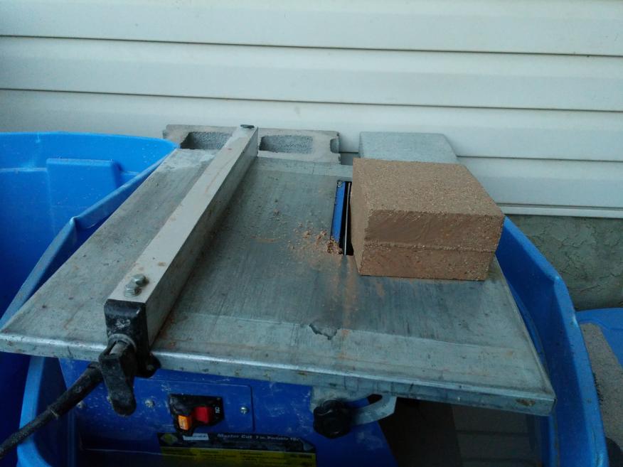

                            I don't think I saw the photos of this, but I think that in cutting my brick have somehow replicated the technique unknowingly. Basically I have a wet saw like linked below. I set the table to cut one of the angles that I need on the brick (that being the angle on the vertical/short edge) of the brick. At this point I am freeholding my brick at the appropriate angle to get the correct width for the top of the brick. (The preset angle is ensuring the correct width at the bottom of the brick)
                            If that description seems helpful, I can take some pictures next time I get to cutting bricks for my 2nd course. (If so, I will post them on the forum album so that the don't have the photobucket issue)

                                The picture may not be the best, as it is for the second course, so the angles are small.
                                The left side of the table is lifted (tilt) to put an angle on the side of the brick. Also, the brick is turned (twist) to cut the proper angle from front to back.
                                With this 7" saw I need to make one cut, then flip brick onto other side of the blade to cut the other half of The brick.
