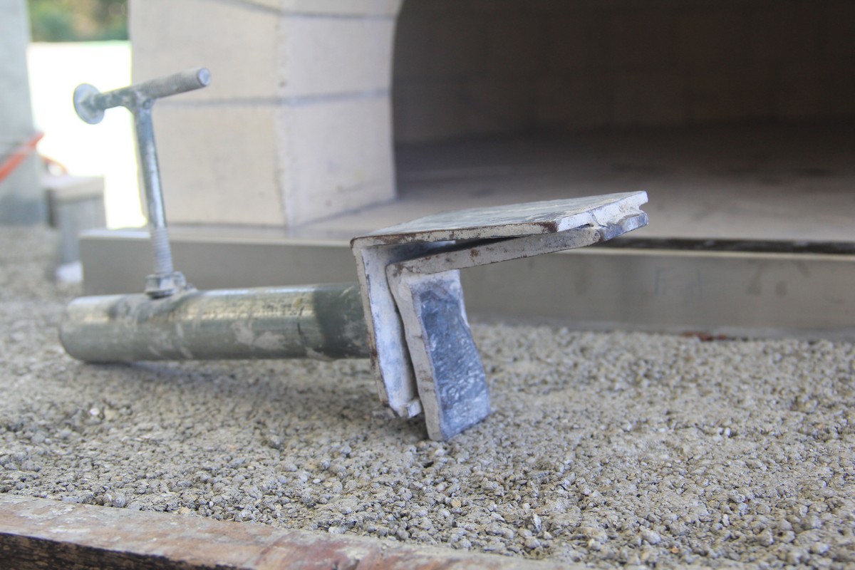

                      #190
                      Re: My indispensible tool (a variation on a FB theme)
                      As my IT was mounted on a board and the hinge axis was higher again it meant without shortening the IT that the dome would end up higher than the radius by about 50mm ( whether this is of any real concern is conjectural). The problem with just shortening the length of the IT is that you get a lip as the face angle needs to change to keep the brick faces aligned. I also found that with the 1/3 bricks used on the higher courses that my brick bracket was too wide and got in the way, so a solution was found. Had a small offcut of some angle iron I used for the gantry under the oven, and tack welded it on to the brick bracket. Worked a treat and over the last 3-4 courses lowered the dome height back to the radius.

                        #191
                        Really cool modification!
