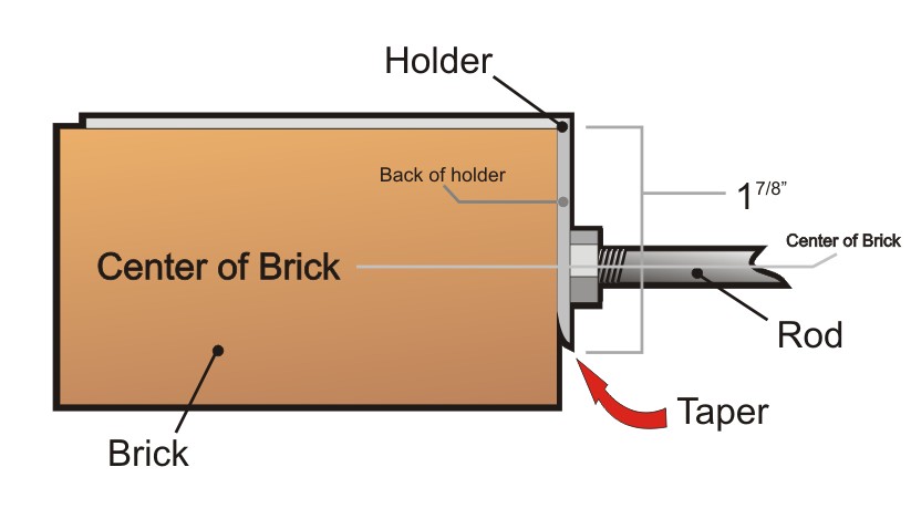

                  So, I built one of these tools in the "no weld" fashion, have not used it yet, and then while showing a friend last night he asked an interesting question. My tool uses a right angle bracket for the brick support/guide. Does this guide need to be removed or loosened when moving from one brick to the next? the reason I ask is because it appears that the end of the bracket that points down will catch on the brick as I am trying to reposition the support arm for the next brick. Is this making sense? Maybe the answer will be obvious once stacking has begun.

                      As long as your rod is attached to the back portion of the holder (bpoh) at the center of the brick, and the bpoh is 1 7/8" from the base of a 2.5" thick brick, and you taper the top of the bpoh as illustrated below, it will be snug but it won't disturb the brick once in place when you remove the tool. You shouldn't have to make any adjustments to the tool to do this, that would greatly affect the consistency of results and speed inherent in its use.
