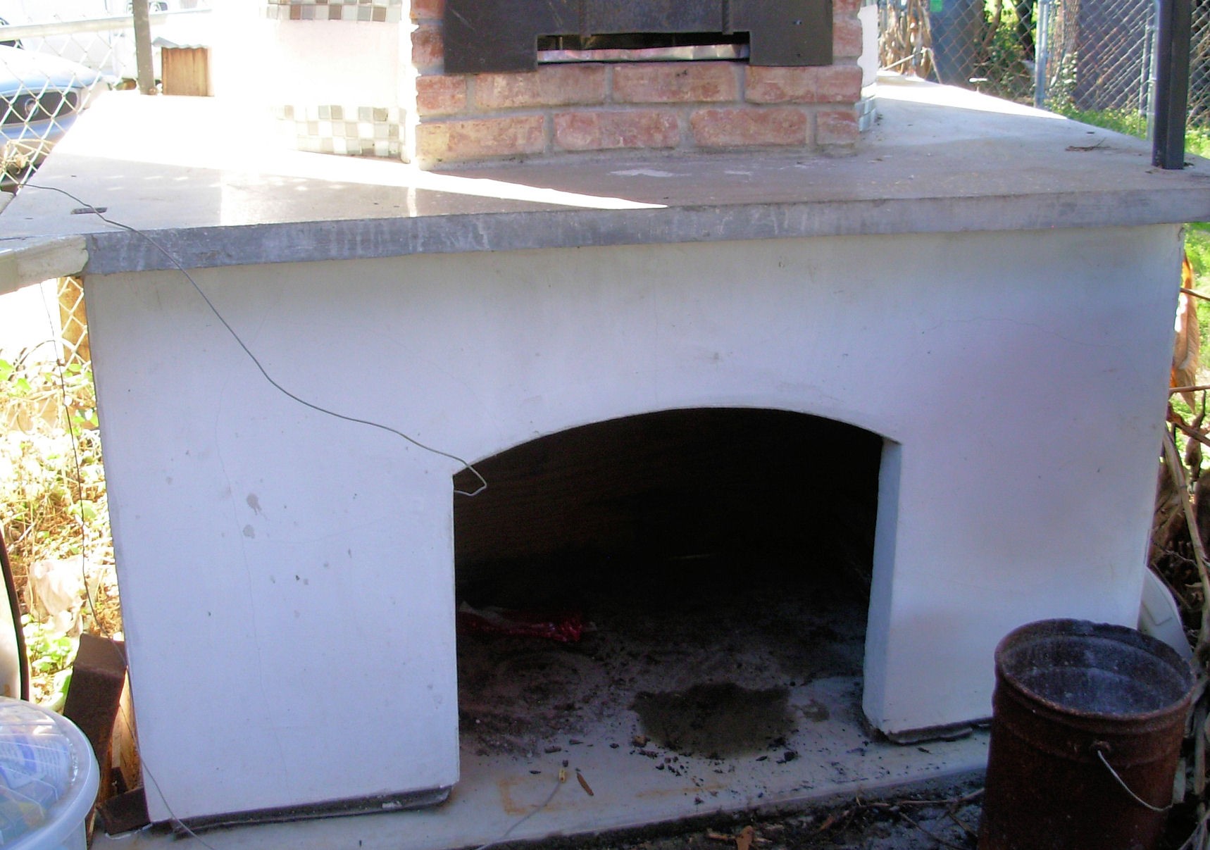

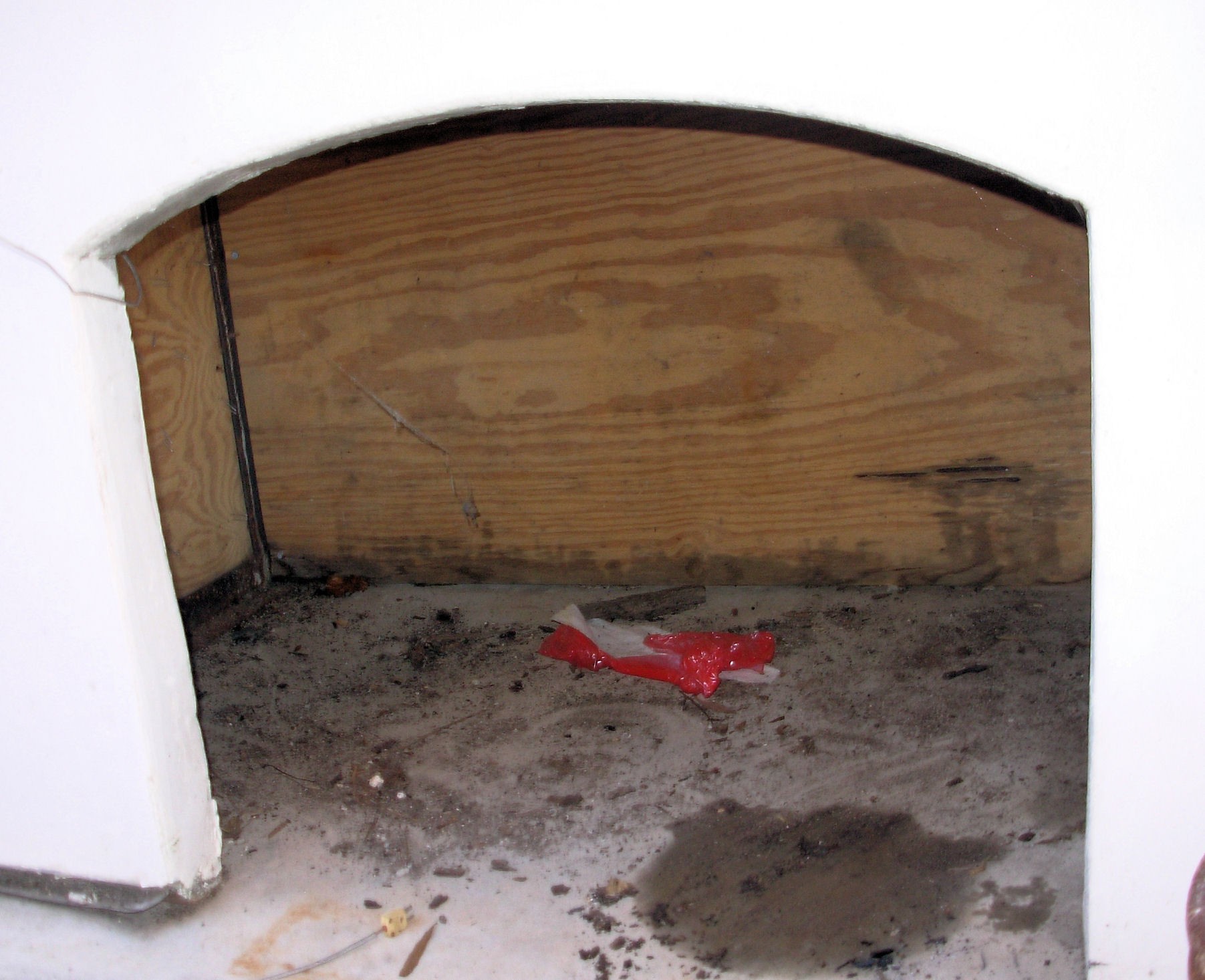

              Here's mine, It's 6'x6' with a divider across the middle of the back. The hearth on mine is insulated, I've checked the temp under the slab several times and it's never read more than 137 degree F..
              The empty bin at the front, I haven't filled back up yet because I'm waiting to get me some white oak.
              The back bin is just extra dry storage

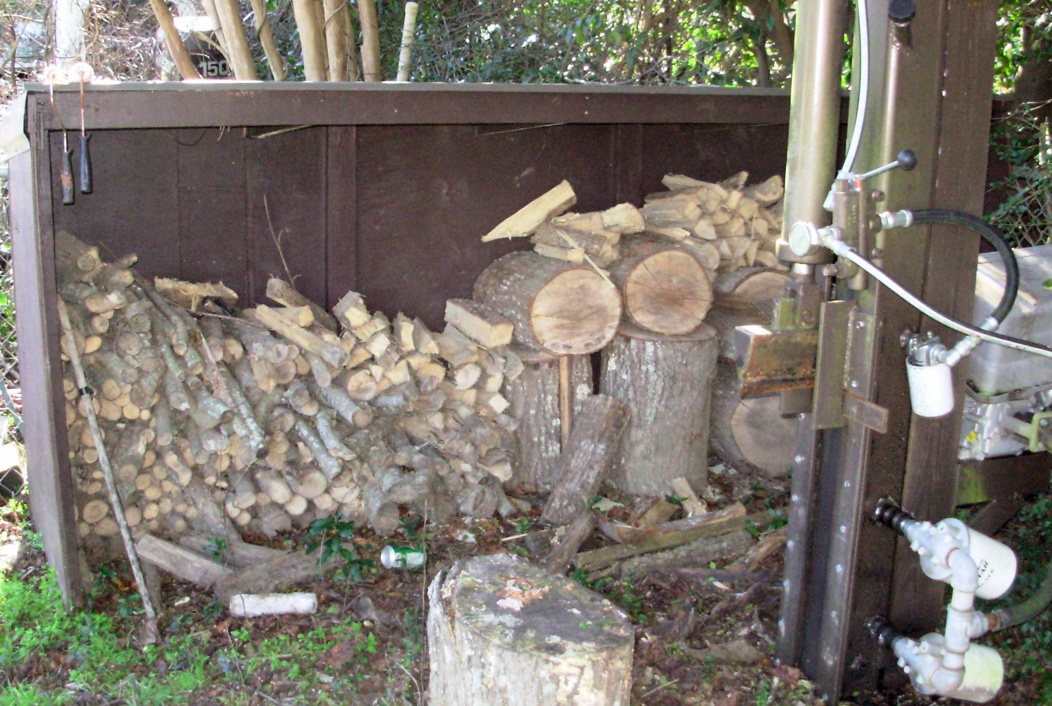

              The long bin by the log spliter is my bulk storage. The log splitter I built from stuff I had, only had to buy the pump.
              It kinda sucks too. All this wood is from a pecan tree I cut down in my yard and I'm fixing to trash it as soon as I can get out to get me some more white oak.
              I have tried Red Oak, White Oak and Pecan. White oak is by far the best and hottest burning. Red Oak does ok but not as good as White Oak. Pecan sucks, it makes about half the heat as white oak and don't like the way it burns. I only use well dried, cured wood, no green.

                BenKeith , that's one stout looking splitter! I have a hand pump model from HF and although it is slow it sure beats swinging a splitting maul.
                I need to build a door for my my storage area so I can keep the critters out!
                • BenKeith
                  • Jul 2017
                  • 54
                  Yea, it's way over built but that's what I had. Right now it's 35 tons, and built for 50 tons if I wanted to buy a 6" cylinder. The pump is a 22 gpm 3,200 psi on a 12 hp motor so with that 4" cylinder it's fast. It splits 24" dia. white oak like nothing. Made it stationary like that so I don't have worry about everybody wanting to borrow it. One of the benefits of having done hydraulic work for 20 years.
