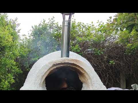

My wood fired pizza oven seems to let more smoke out from the door than the chimney
Your flue pipe is way too small. For an oven the size of yours , it should be 6" (150 mm). All new and still damp ovens tend to be a bit smokey, but an 80mm diameter pipe is too small for even the smallest oven of this configuration. My ovens are 540 mm (21”) and sport a 125mm diameter pipe.
I have made my first pizza oven. I used what appears to be a "common" technique, where I used a gym ball, and covered it in a perlite/concrete mix. The oven works fine, the pizza's come out amazing!
The problem I have is that the majority of the smoke does not appear to go up the chimney
This video shows my oven leaking smoke
https://youtu.be/gUTui-7uqYE (and it is attached)
The dome was built on top of an 85cm (33inch) gym ball, and the width of the door is 44cm (18 inches) and height is 28cm (11inch). The chimney diameter is 8cm (3.1 inches) and sits inside the "door way"
I'm wondering if the issue is the chimney is not wide enough or if it could be the chimney is in the wrong place?
I'm hoping some one has experienced something similar, because whilst the pizza is amazing, everyone in the garden goes home smelling like a bonfire. I also have no idea what other information would be useful so apologies if I end up making you ask extra questions
