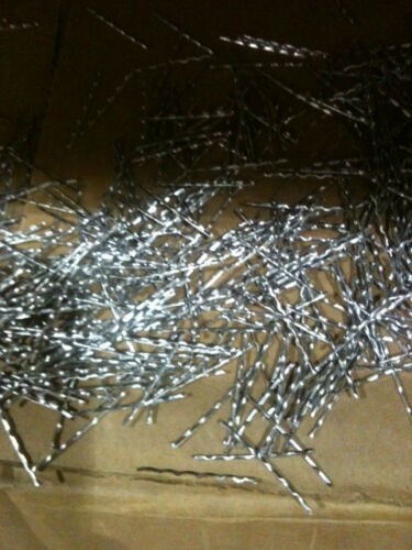

    After about 5-6 inches perlite 8:1 ratio. Can I use a stucco mix for final layer? I plan to put tile on outside. What is your recommendation?
    This pizza oven will be under a pavilion ( however its still in progress as well. So It will be exposed to a few showers etc. )
    Should I reinforce final layer with stainless needles? pic attached.

    Those steel fibres, if they are the ones I'm familiar with , are not stainless. They are also not suitable for a final layer, they are intended for reinforcing a thick slab. You need much finer fibres that won't stick out at the surface. I find the short 19mm AR (alkaline Resistant) fibreglass fibres as used by the concrete countertop manufacturers suitable and easy to work with, but no doubt there are other solutions. Not sure if the Quickcrete Stucco you have contains fibres. Some of them do, it should say on the pack, I can't read it.
