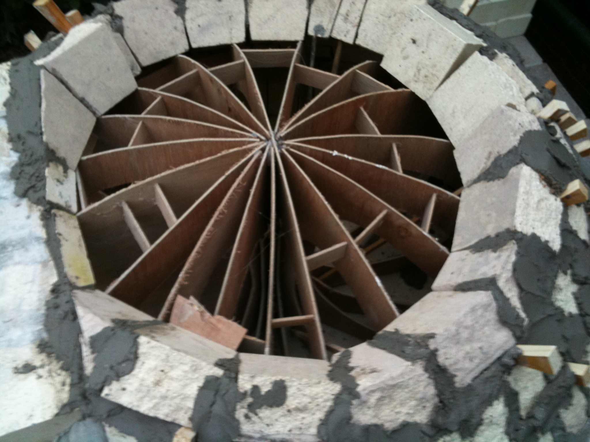

            Dear Jaz
            Im trying to attach pics again
            dave
              #21
              Re: new guy wants to build a pompeii oven in brisbane
              Dear jaz

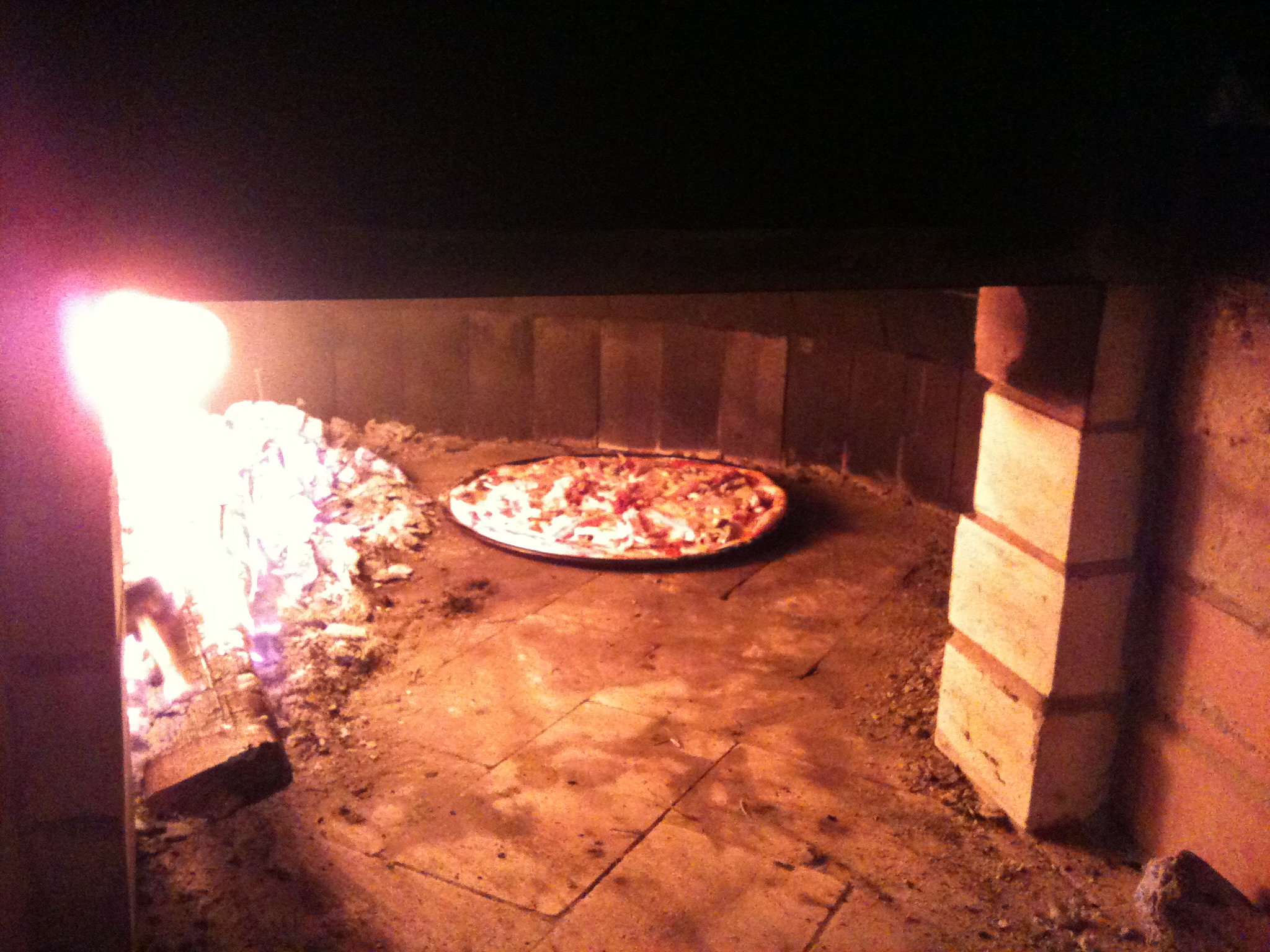

              As you can see from the photo previous WE HAVE PIZZA.
              I built the dome support from plywood an we burnt it out one Fri night
              the oven got good and hot and even though no insulatution at this stage we packed in some good hardwood and made a pizza dought and me and the child bride sat with a glass of wine and watch the flames. Makes all the work worthwhile I can tell you. Bloody good pizza too..

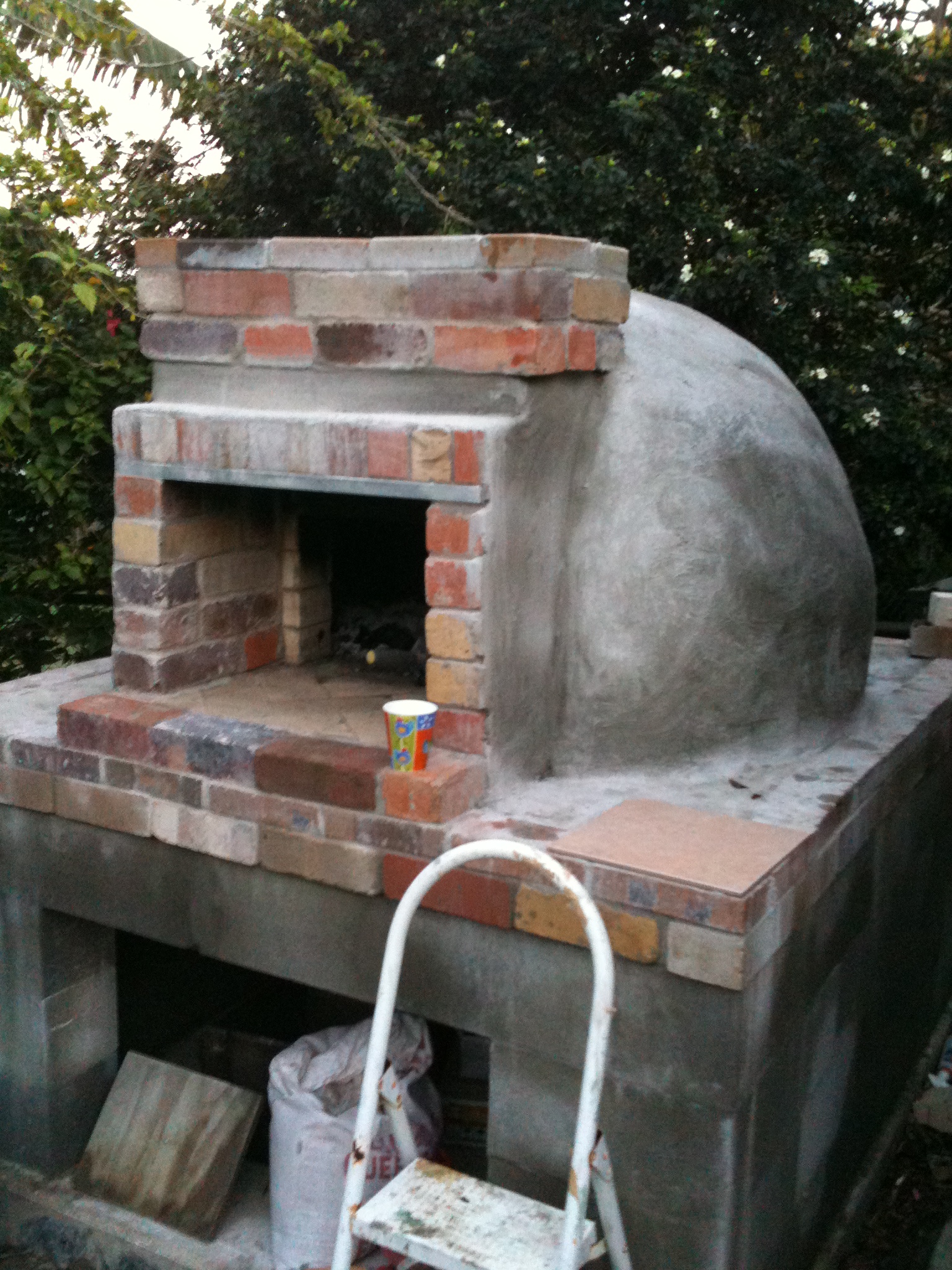

Name:	oven rendering.jpg

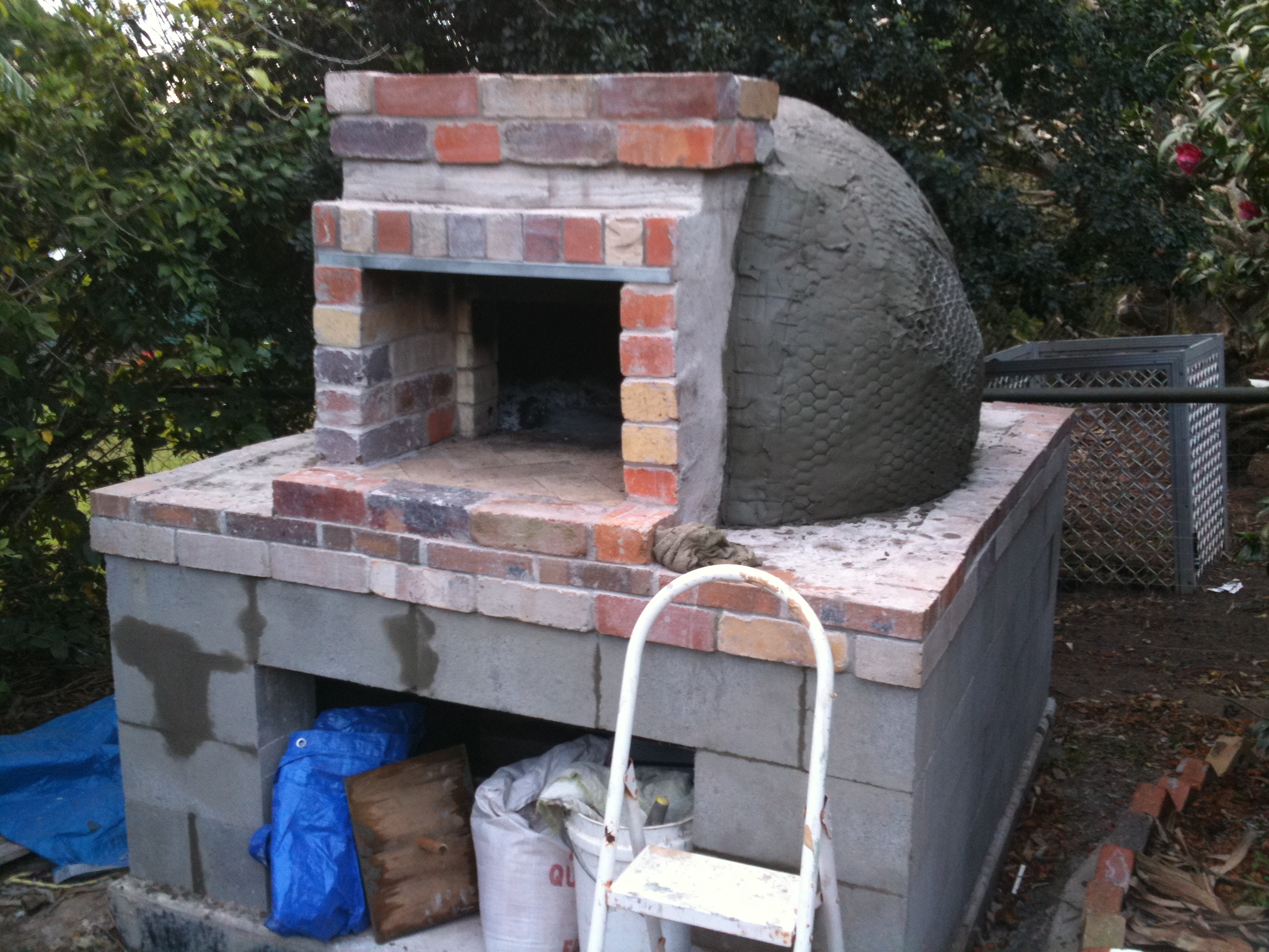

              I'm rendering as we speak. The insulation with insulating cement was a nightmare. I got some fine pearlite mixed up an experimental batch to find out what is was like. I had the consistancy of rice bubbles and milk and about the same workability couldn't towel it would not stick to any thing. So I set it in an ice cream container to see what it was like dryed and hit the web site.
              Armed with some new information and an icecream container of lite cement substance that looked the right stuff I tried again.
              Build a cage from heavy pet mesh over the dome cover it with fine chichen wire to prevent "the mixture" from escaping. Well it was like stuffing marshmellows in a hot toaster fast as you got it in there it melted and come out the bottom. And to top it of it rained so I sprayed the remains away with the garden hose and ordered ceramic insulation. I probably could have made it work with a little more patience but what the heck I'm still under budget to date. I'm not trying to put you off using insulated cement but you going to have to be patient or build an inclosure and dry fill. I've got a couple of sheets of 10mm compressed cement sheet which I going to make an oven door ones yours if you want it.
              regards dave

                        first pizza mmmmmmm

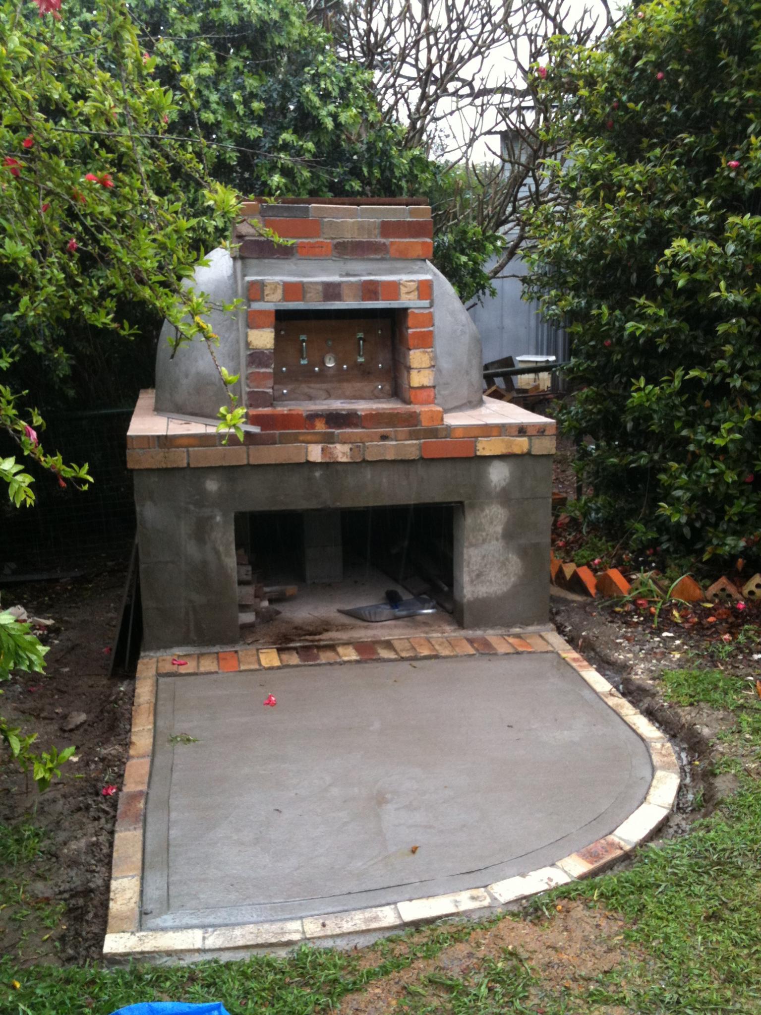

                                Jas sick of the rain yet?
                                Yep I am too just can't get much done. Domes soaked as it is to damp to seal the dome cause it will not stop raining!!! I mucked around and built a temp door out of hebel and plywood that a guy posted the to me. Cause I was not sure how wet the Guts of the oven was i built a small fire for a couple of hours. Fitted the door 200F and next morning 175F sat afternoon 125F holds it's heat well, but definitly wet, open that door and you can feel the steam rush out. No more pizzas for a while cant see any good out of building a real pizza fire it would probably crack the oven.
                                Got pee'ed off with the rain and layed a cement slab Sat morning between showers poured cats and dogs that afternoon and the cement had to go off underneath a tarp. Worked though and with rain should be a good piece of cement
                                I atach a photo brick work looks good in the rain its going to need a good scrub with acid when dry to get ride of the lime scum and bring out the colour. Child bride has picked a great colour for the waterproof render so it should look to bad in the end.
