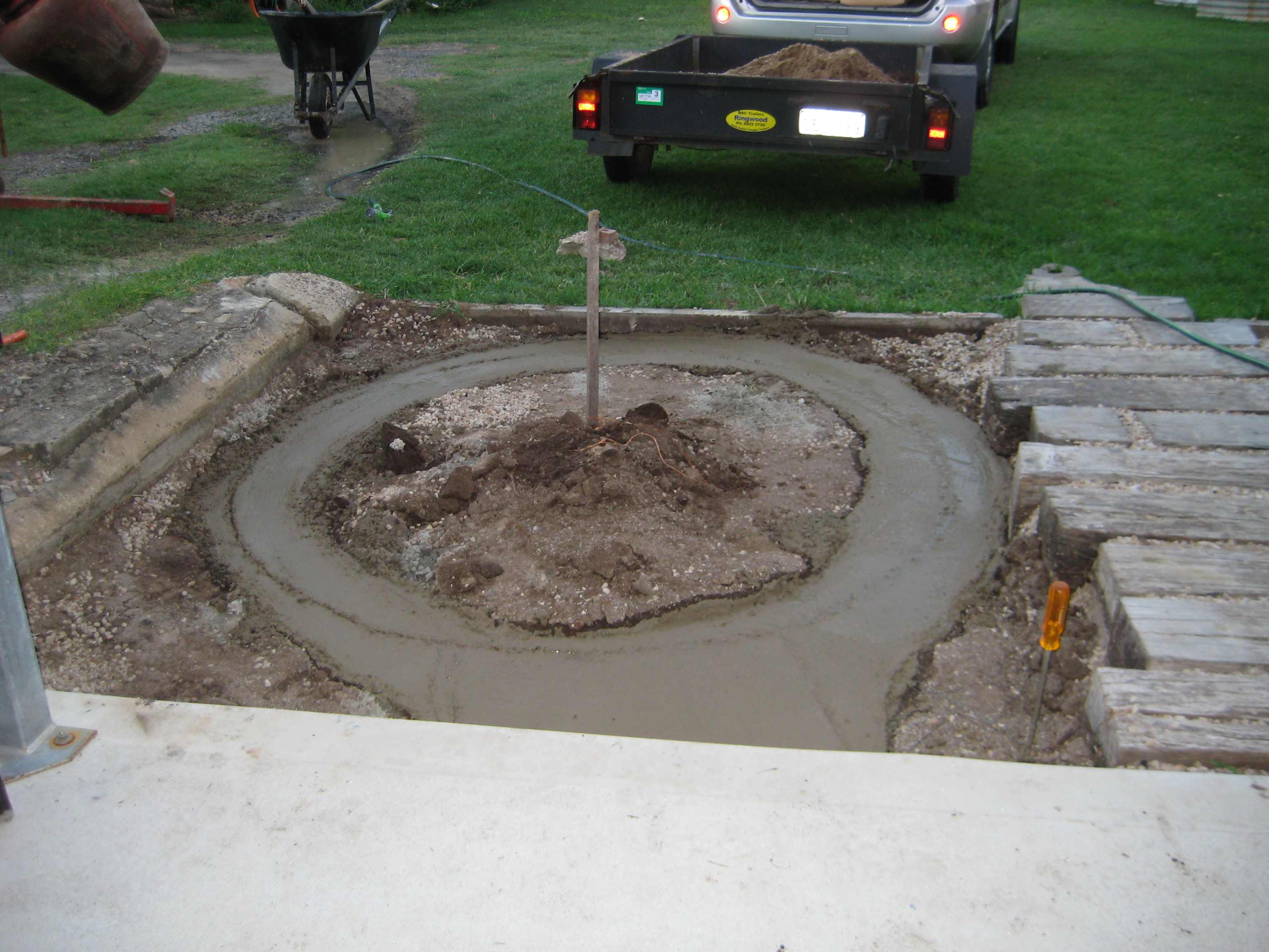

          I thought I might whack a few photos up of the WFO. I keep seeing these beautiful ovens by blokes with real talent. While it's great to see, it's discouraging for those of us who are masonry impaired. I thought I might add my attempt so people can see that it doesn't have to be perfect, and that any mug can have a go.
          The Footing, dug on a stinking hot day day with a hangover, sorry - wine flu.

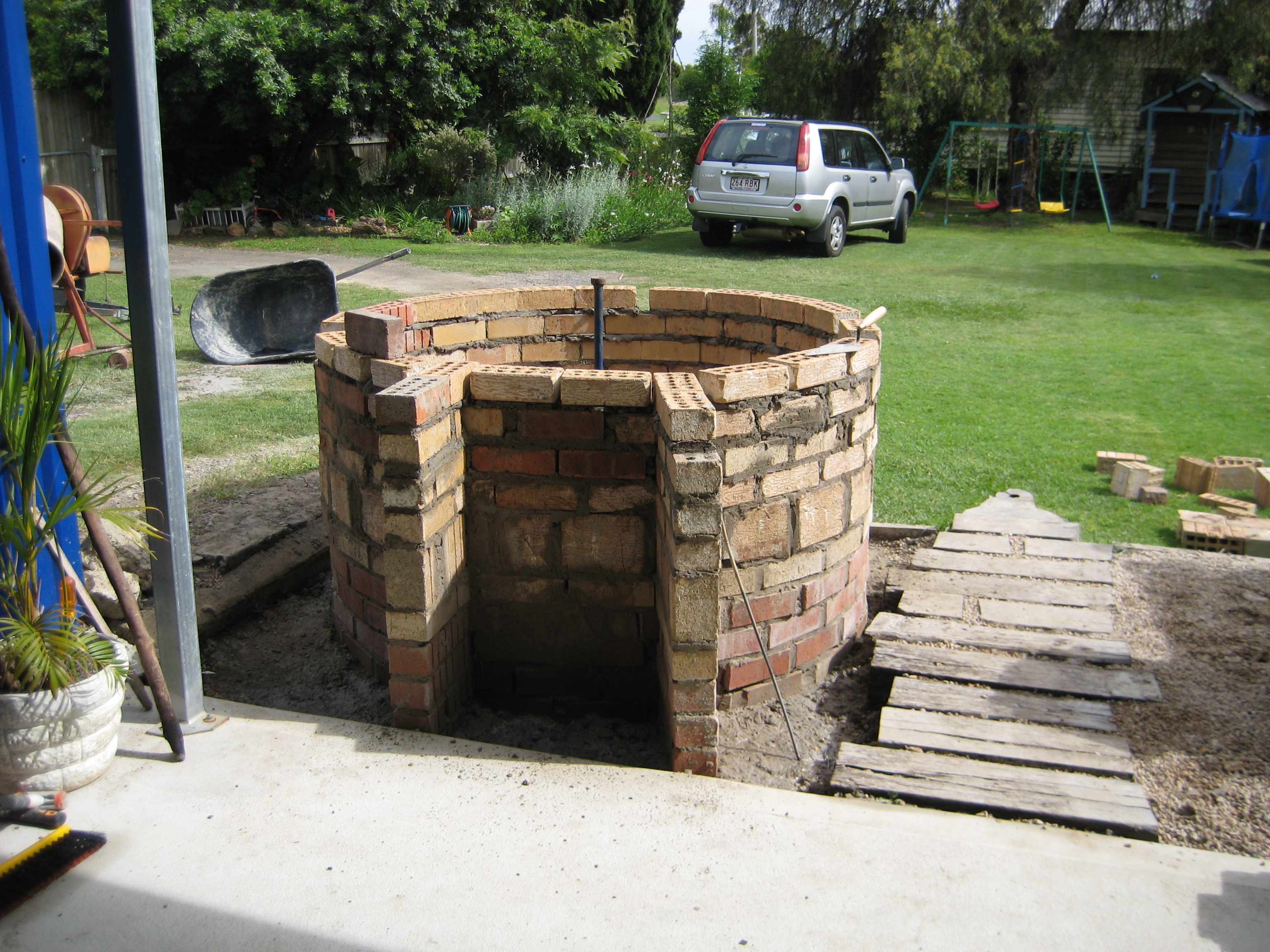

          Base in progress with the Cheif Quality Assurance Officer overseeing the build

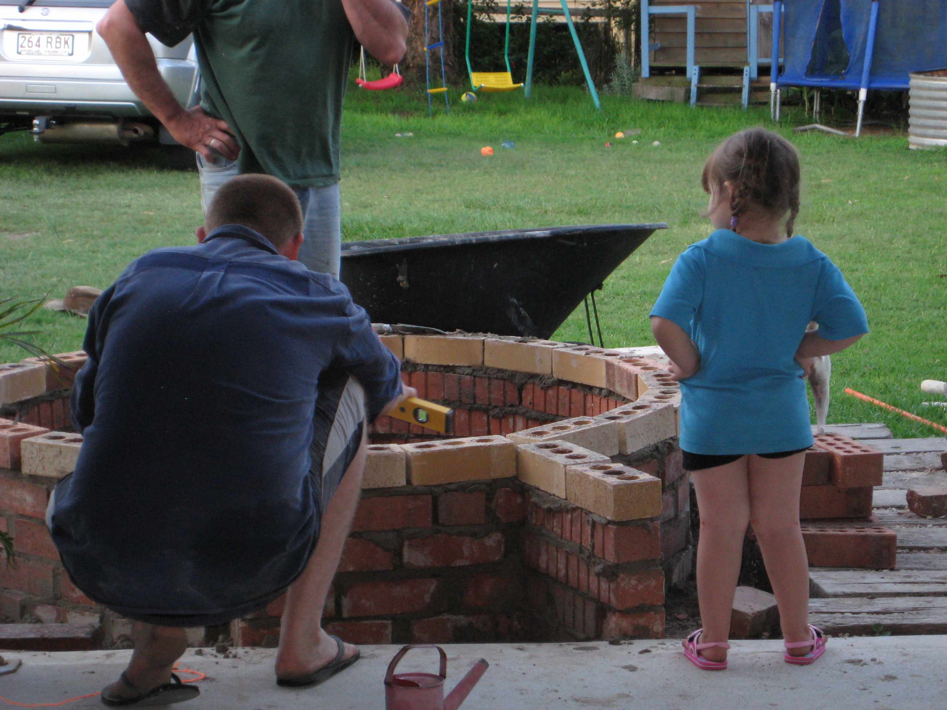

          Base Completed. In hindsight, this was the hardest part.

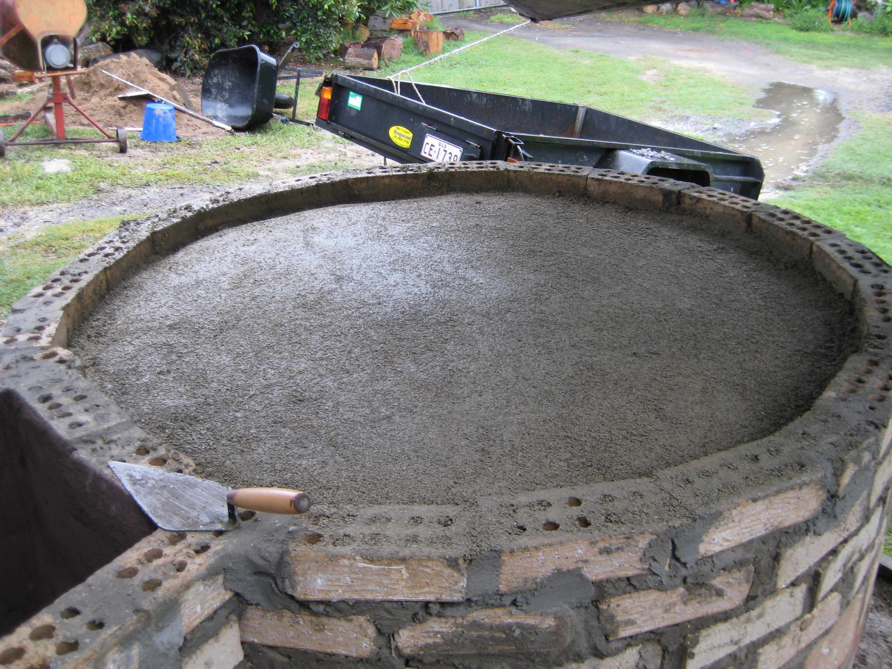

          Vermicement base. Freaky stuff, I was worried it wouldn't dry, but it came good after a day or so.

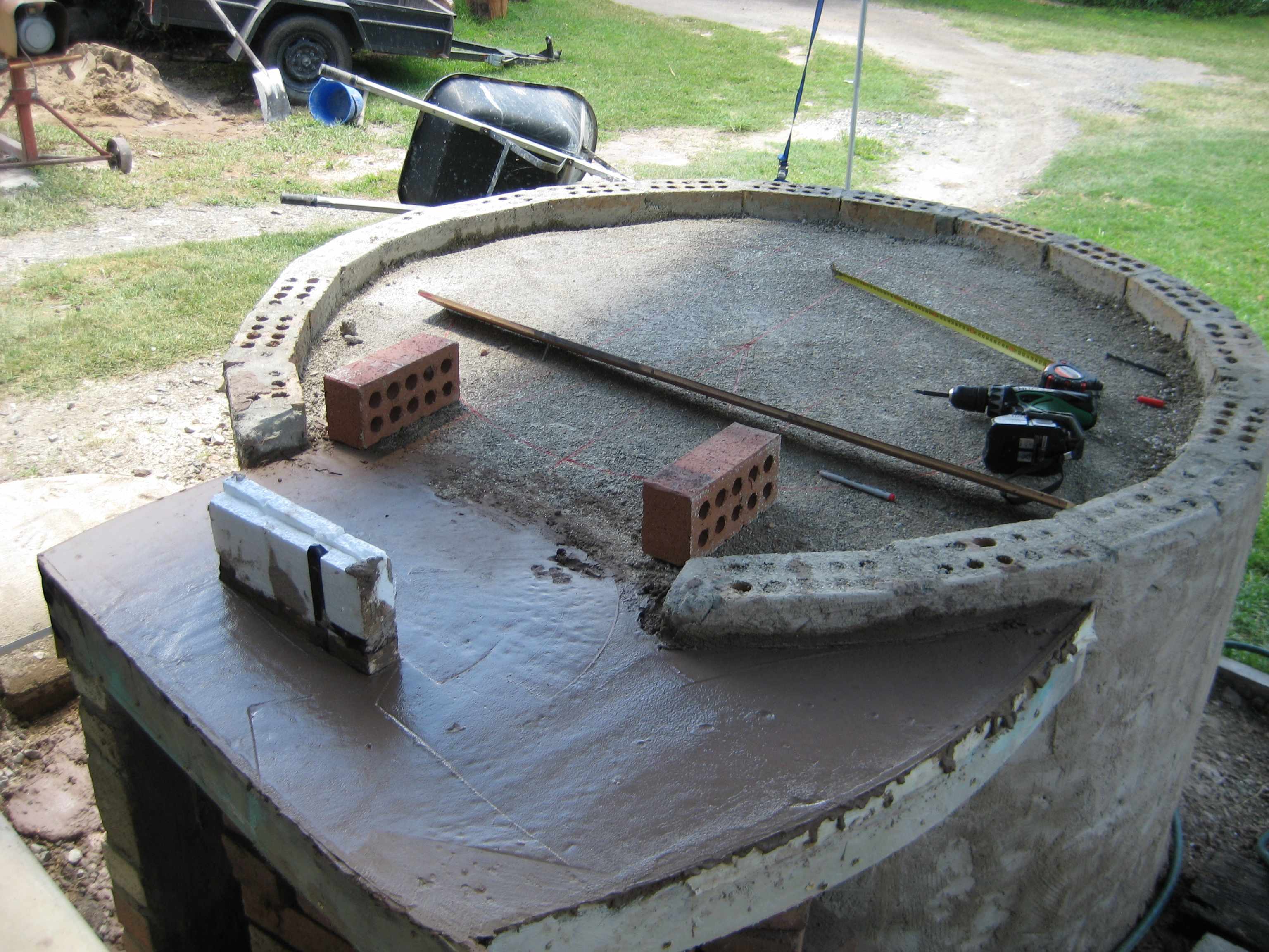

          Snazzy little landing with provision for an ash pit hole, and most importantly, somewhere to rest a drink.

                Below is my setout for the floor, my attempt at the arches (don't have a bricksaw and my bolstering is pretty hit and miss). It's rough, but going to be rendered so I wasn't too concerned about it being pretty. The bricks and the strap were my resolution to anchoring my hendo indispensable tool (and what a tool it is, could not have done without it). I ended up using a sand form towards the top. In hindsight I should have persevered with the indispensable tool, I couldn't see what I was doing with the form and it ended up being a bit of a dog's breakfast. I used a circle of mdf, cut in half(ish), overlapped and screwed together under the sand. I used a car jack to hold 'er up there. There was a moment when removing the form where I just had to rip the jack out and hope for the best. A bit puckerish, but amazingly satisfying to see the dome staying up, holding together all by itself.
