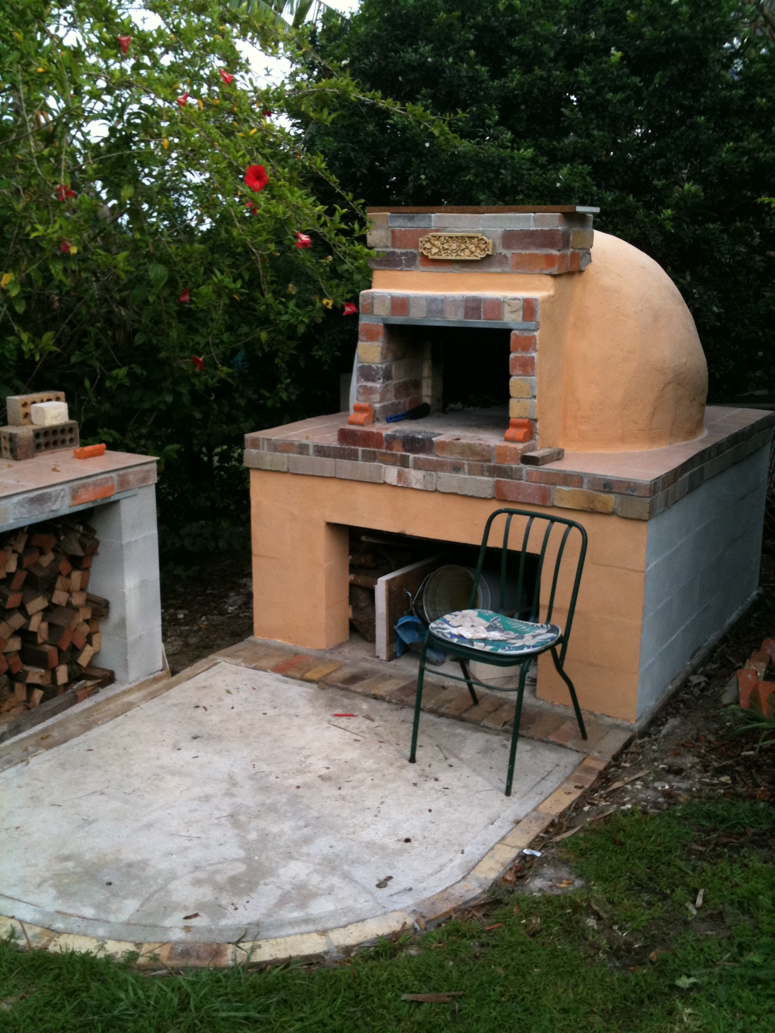

jas - Spent the last week laying foundations, building a brick base (looks like a well) filling it full of rubble (the brother did his part by emptying as many stubbies as possible and throwing them in) and now today finally, I've filled with a vermiculite concrete mix. 5 to 1. I'm with you, strange stuff. It feels like the softfall stuff they put on the ground at the playground. Is this stuff going to harden???
